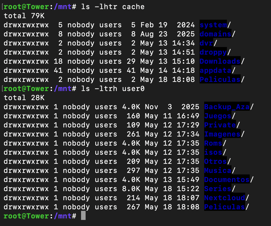

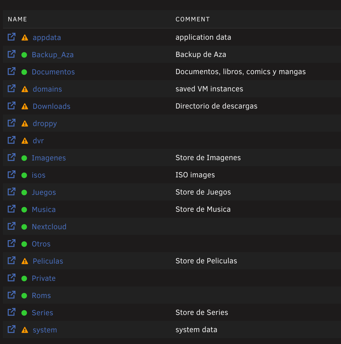

  2. Hello @MowMdown thank you for your comment. As I mentioned on the original post, i try with both root:root and nobody:users with both the same issue... In fact, in order to correct all the groups:users possible issues, I ran the tool --> new perissions feature with the same results. BTW, I also noticed that I have two shares set on the shares GUI (droppy and dvr). These shares are no longer needed. When I try to delete them, the GUI start running but they do not do anything (not even an error). If I check the /mnt/cache the directories are there, however if i check the /mnt/user0 the directories are not there So, If I have to guess, it seems like for some reason the directories in my cache drive are not in sync with my array (or something on that nature). Something its out of sync and I can't put my finger on it.

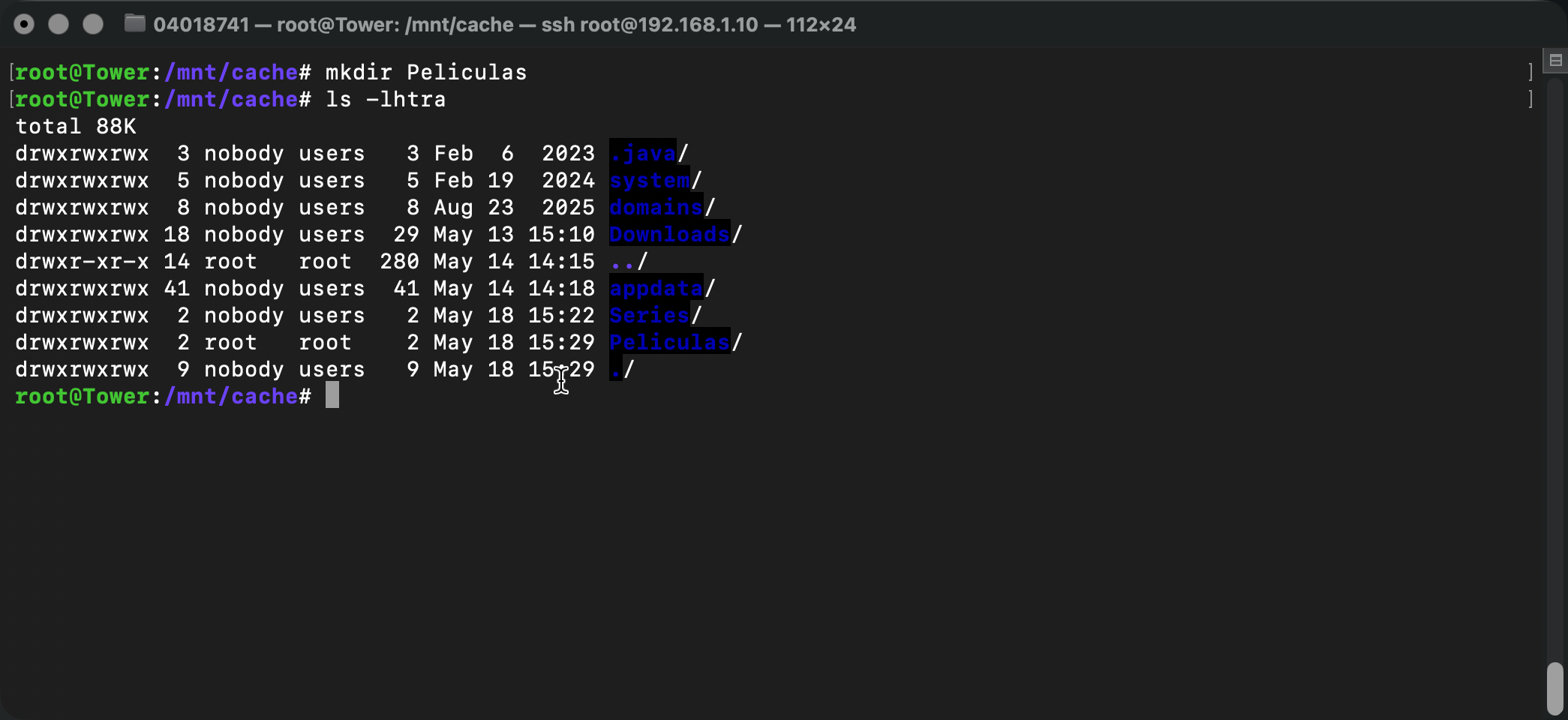

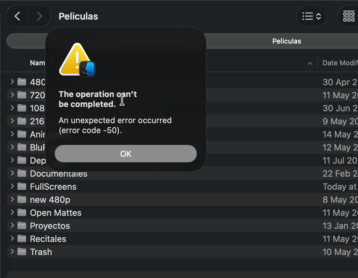

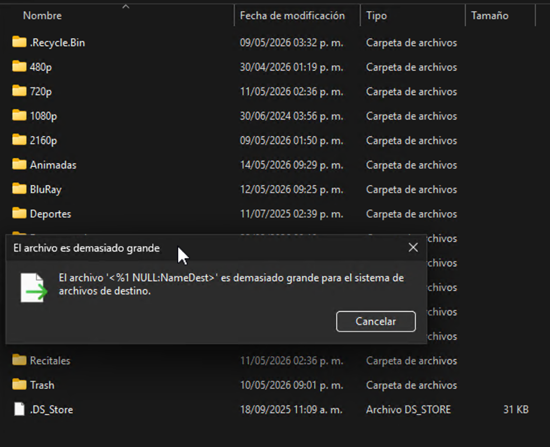

  4. Hello team, let me give you some context. I have a share named "Peliculas". If I try to create a folder, create a file or copy a file inside that share I get an error. For example If I try to create a folder: On mac: Using Windows: (the text its on spanish and said: "The file '<%1 NULL:NameDest>' is too big for the destination filesystem.) However, this error solves if I create a folder named "Peliculas" on the patch /mnt/cache/. Once I do this, I can use the share normally until the next 'mover' process runs. Than, I'm stuck with the same issue all over again. BTW, It doesn't matter if the folder "Peliculas" 's owner and group are root:root or nobody:users. It's the same for both cases. I'm really confused about this one, I do not know what to do to be honest. Any help will be appreciated. Thank you in advance. tower-diagnostics-20260518-1958.zip

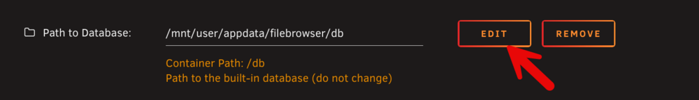

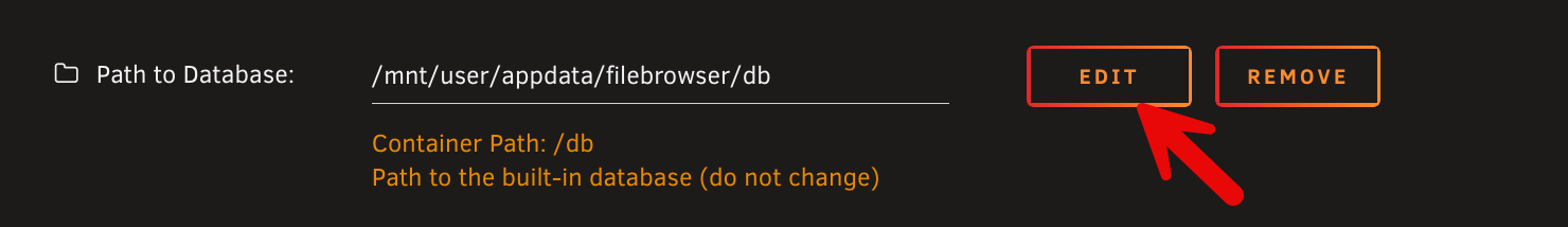

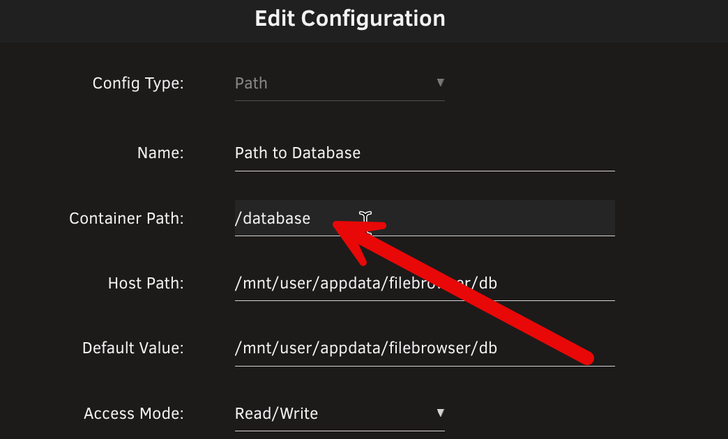

  5. I found the issue. The path for the database inside the docker changed. For old versions the path was /db, the new path is /database. So, the solution is to change the variable on the unraid docker's template: Go here (ignore the 'do not change'): Change it from this: To this: Now the bind mount will save everychange into the local unraid path /mnt/usr/appdata/filebrowser/db. Maybe @knex666 can update the template so this could be a permanent fix. Thank you.
