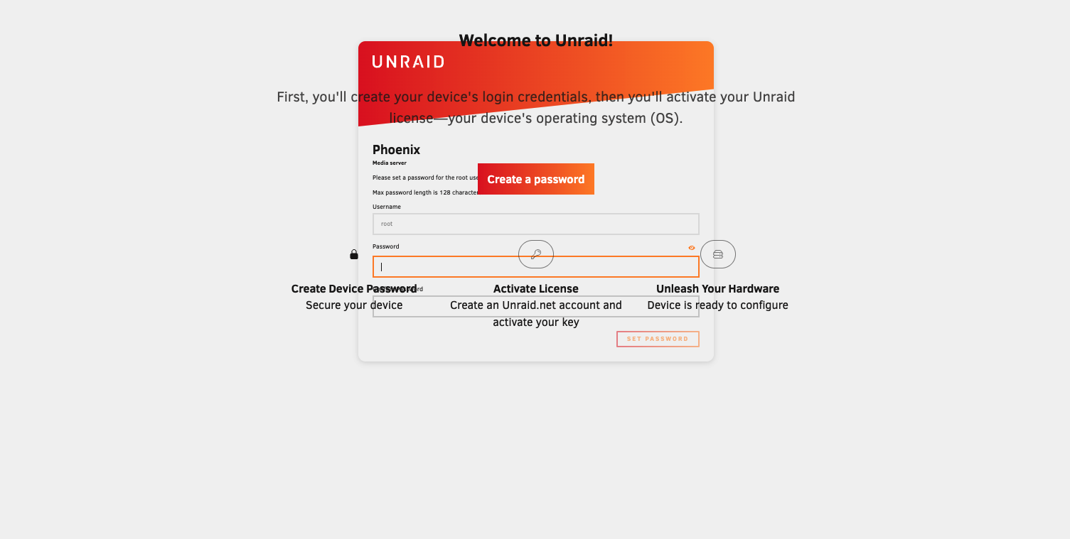

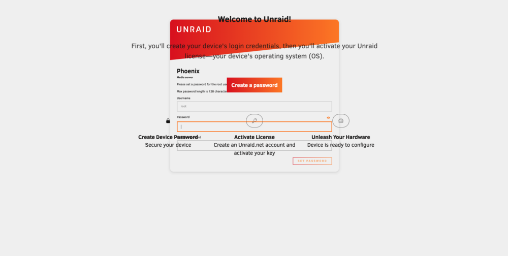

  2. I started the process to update to 7.1.3 to 7.1.4 and was waiting for the notification to reboot. after a while and no notification i refreshed my browser and was met with a jumbled mess of a log in that is giving me the impression the gui thinks this is a fresh log in. my dockers all seem to be responding and working for now. what are the recommended next steps to check things out?
