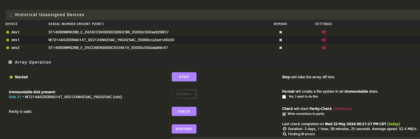

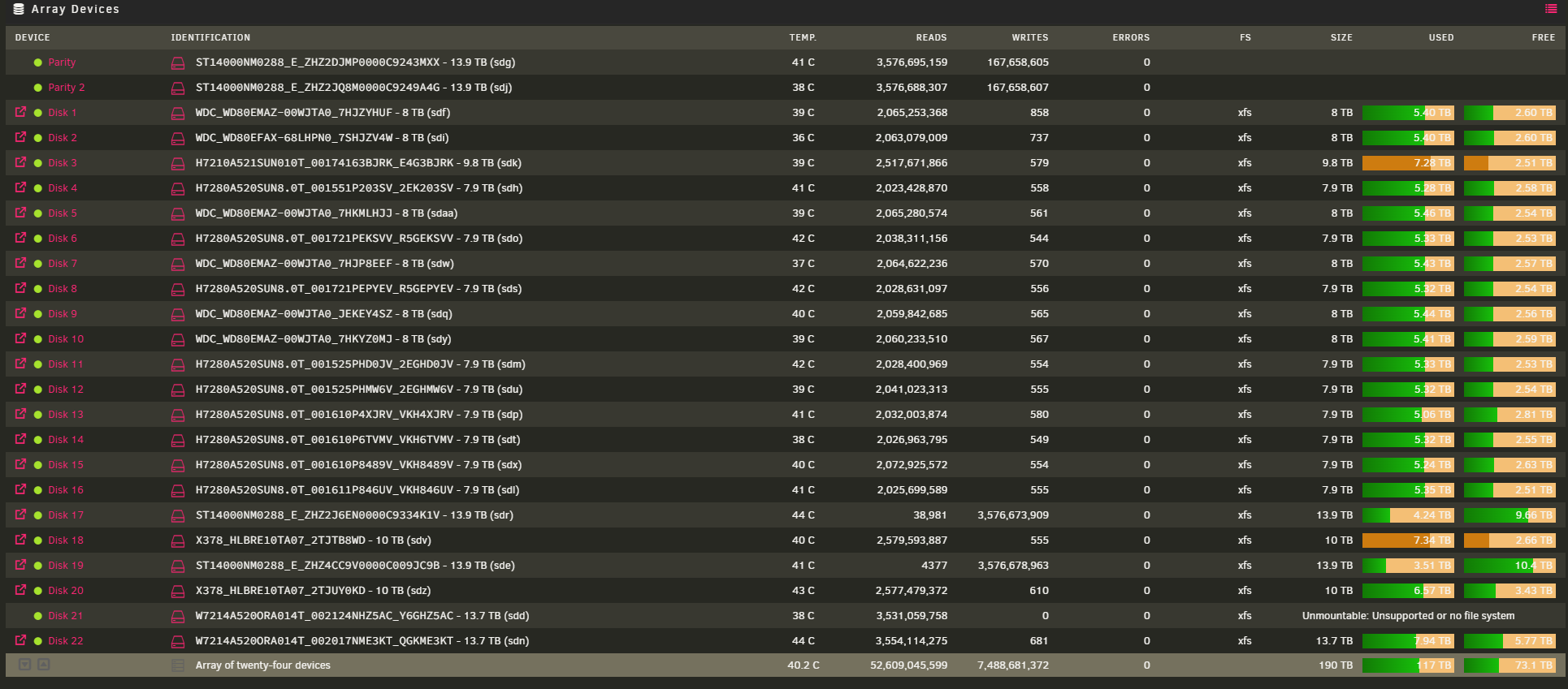

  6. recently did a reorganization of my server rack including putting rails on my unraid server. when i turned it back on i had a disk unmountable. This disk was already in the array and already had data on it with unraid file system but it says it doesnt have a filesystem on it. i know that there is always a risk with power cycling a server however im hoping i can save this without having to use my cold spare to replace it as the drive is old. During this shuffle i upgraded 2 drives from 6TB to 14TB and it worked just fine and parity/rebuild finished today but i dont know how to get this drive to cooperate with the rest of the party. anyone have any ideas on what i could or should do? or is that drive just FUBAR and i should replace it? drive 21 is the problem child and ive attached pics of what im seeing in unraid
