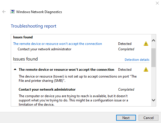

I am unable to access my server shares from Window Explorer anymore.
My apologies. I am running the following I know the info is there, as my Xbox downstairs can still access the server and watch movies and shows. It appears to be just my Windows 10 PC that is having the issue connecting. Here is the error. If you need anything else, let me know. Appreciate your time and help. syslog.txt
I am unable to access my server shares from Window Explorer anymore. Any ideas why? Think it is related to SMB maybe. It says the remote device or resource wont accept the connection. I am planning on upgrading the the current version. Will that fix this issue?
