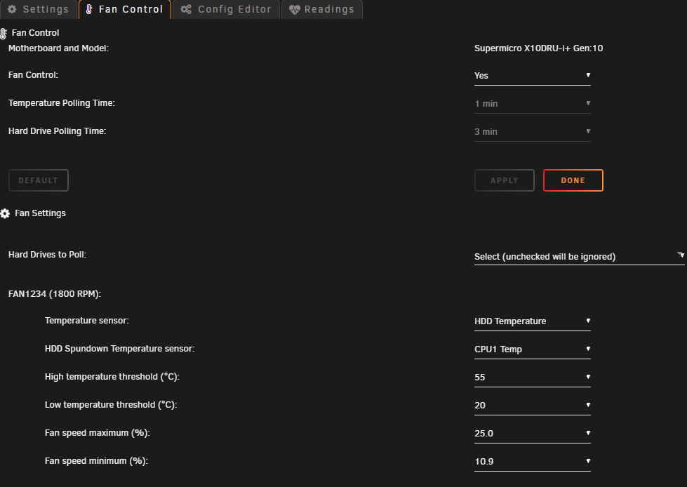

  1. Ok I was able to find some 4 pin extensions, and I moved the other fans to headers 3 and 4, and all four fans are spinning down correctly. Thank you!
  2. So do I need to move the other two fans to sensor 3 and 4? I don’t think the fan wires are long enough. I changed the threshold settings based on your reply but the last two fans stay at full speed.
  3. I just discovered this plug-in this morning after migrating to a Supermicro X10DRU-i+ a couple months ago. I think I have everything configured properly, but only 2 of the fans are spinning down. I have 4 fans total, the stock ones from SuperMicro. My sensors report the last two fans are on FAN7 and FAN8, which is what I selected, but I cannot get them to spin down at all.
