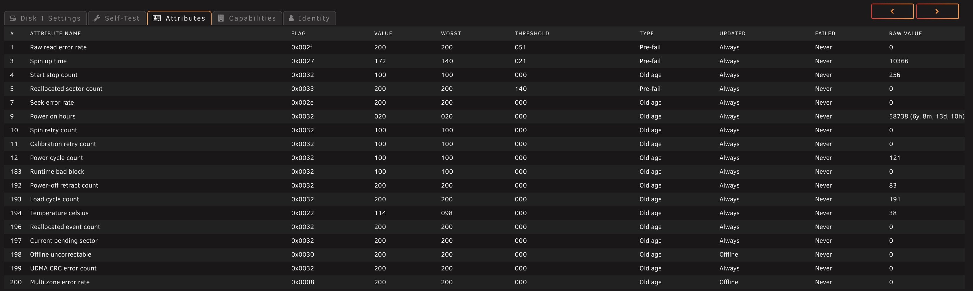

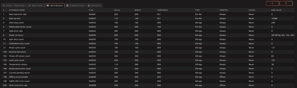

  6. Thank you very much for your attention. Sorry, I thought the SMART report was it. Please see attached diagnostics. oden-diagnostics-20241103-2150.zip
  7. Hello friends, I have some read errors on one of my disks that I don't know how to interpret. I ran an extended SMART test, please see attached log file. I would really appreciate if someone with more knowledge than I can take a look. Thank you! David WDC_WD4000F9YZ-09N20L0_WD-WCC131979574-20241101-2340.txt

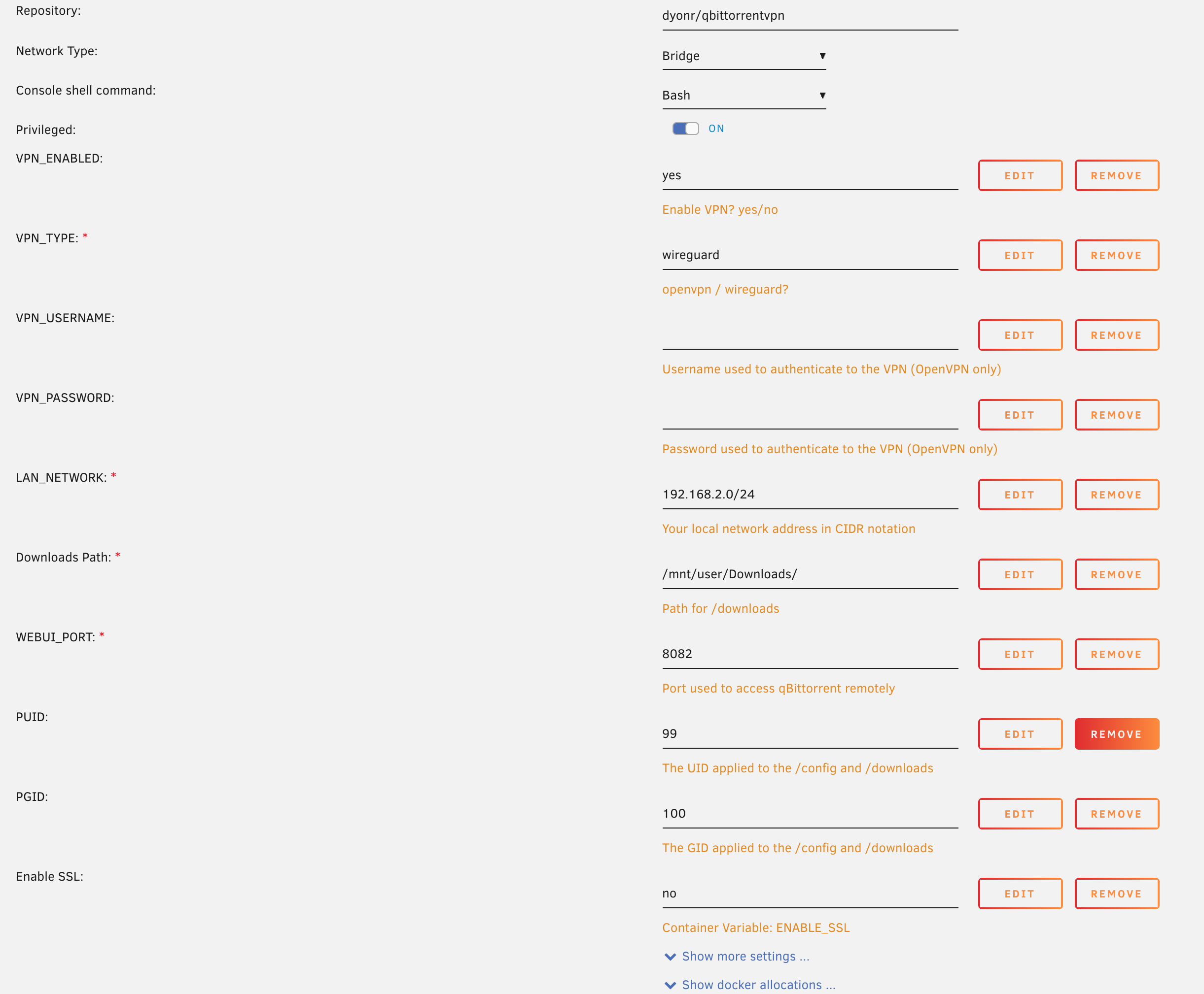

  9. EDIT: More environment variables were found when I expanded "Show more settings". Deleting redundant environment variables solved the problem. Has anyone managed to disable SSL encryption?
  10. EDIT: More environment variables were found when I expanded "Show more settings". Deleting redundant environment variables solved the problem. I have issues with disabling SSL encryption. I have tried to set the environment variable ENABLE_SSL to "no" to no effect as it is being overwritten when the container is stared. No extra paramters regarding SSL are being set. How can this problem me mitigated? Please see screenshot below for configuration.
