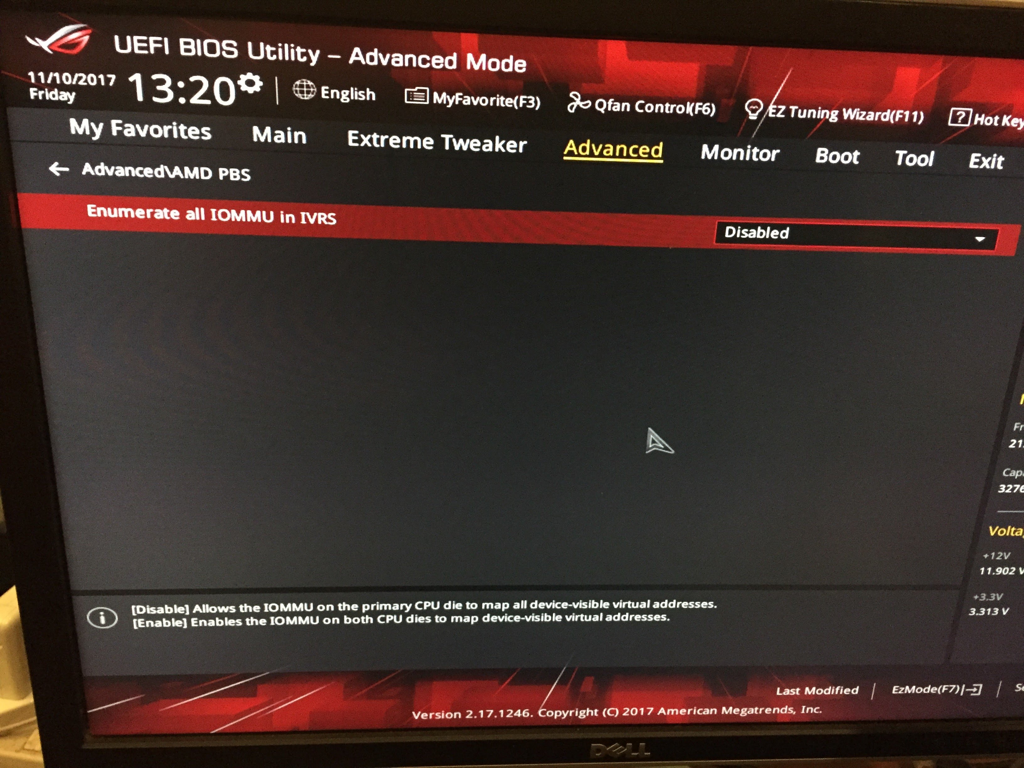

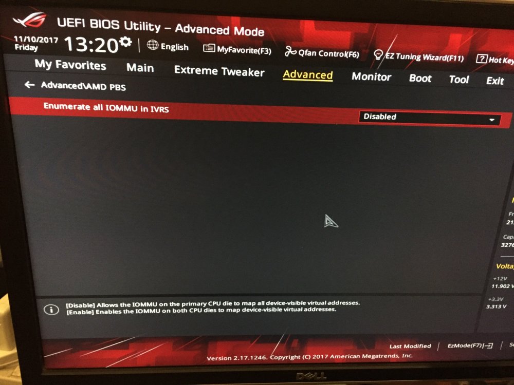

Primary RTX 3080 does not appear in the VM's graphic card dropdown (GPU passthrough)
You should have something like this in your bios: Advanced/AMD PBS/Enumerate all IOMMU in IVRS Change that setting (ENABLE IT) and see if all iommu groups are enumerated (image taken from internet) As you can see, if it's disabled, only devices attached to the primary cpu die will be mapped. If enabled, devices attached to both dies should be enumerated, in fact now, your iommu groups lack some more devices, not only that gpu.
