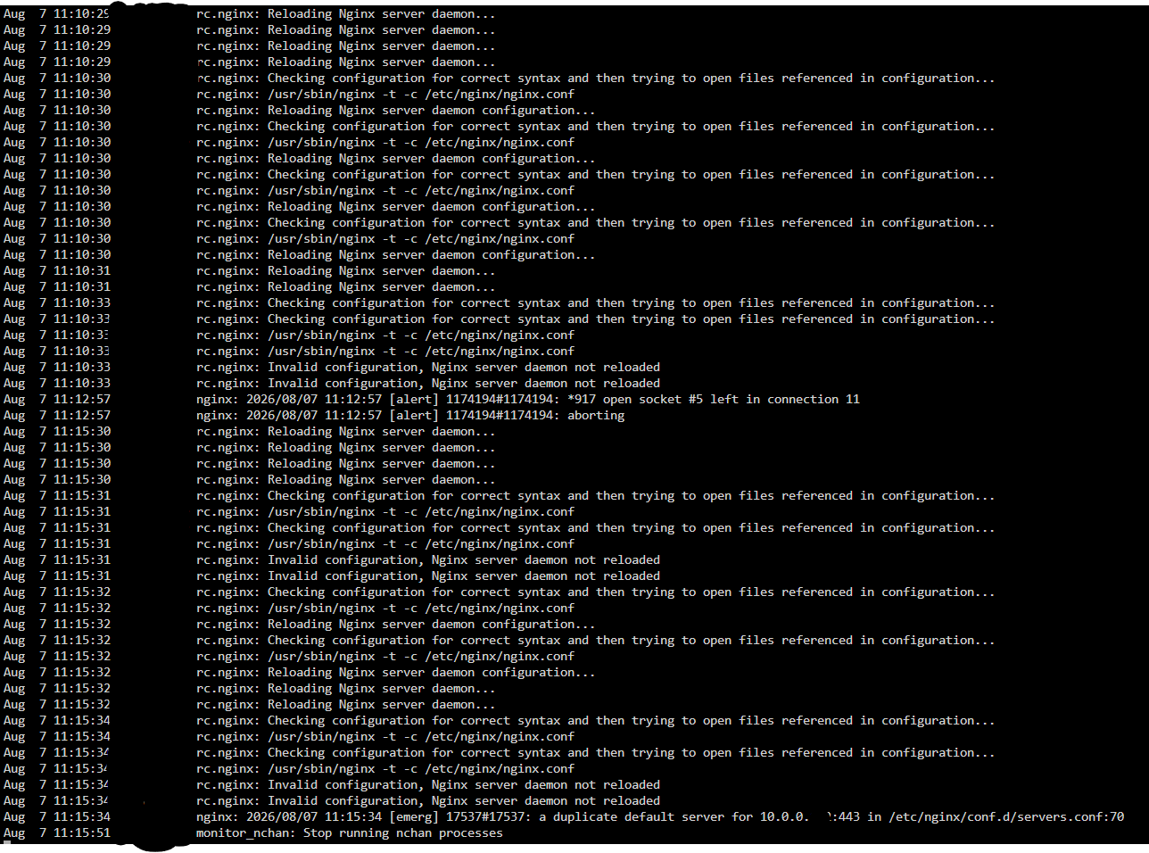

Seemingly random loss (and restoration) of connection and remote access - possibly related to Nginx - [emerg] a duplicate default server for x.x.x.x:443
Strangely, even while reporting that the nginx server could no reload, I still have Unraid Connect access to the server and my Dockers (including Guacamole, Plex, etc) at the moment, but occasionally (recent example being the afternoon/evening of the 6th of August) I lose all but local access from the server - no Guacamole, no Plex, no Unraid Connect access. When that happens and I access the server locally via CLI I am able to ping local devices, but am unable to ping the Default Gateway or anything on the internet (8.8.8.8, etc). Rebooting the server often doesn't resolve the issue, so sometimes I just have to wait until Guacamole, Plex and Unraid Connect access is suddenly restored for reasons not yet know to me (like later in the evening of the 6th of August)

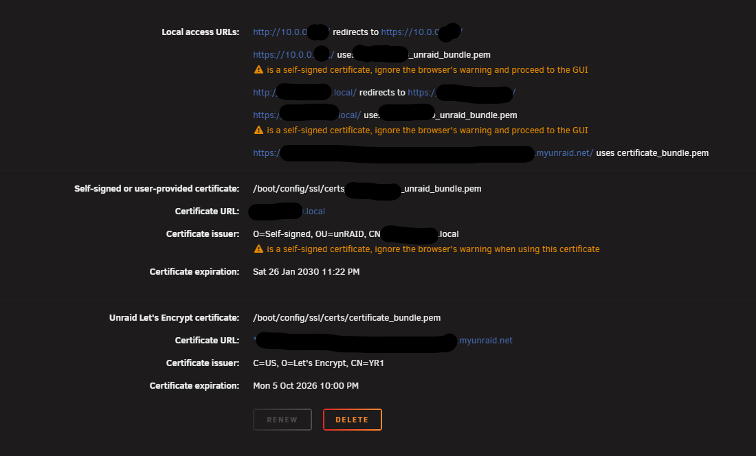

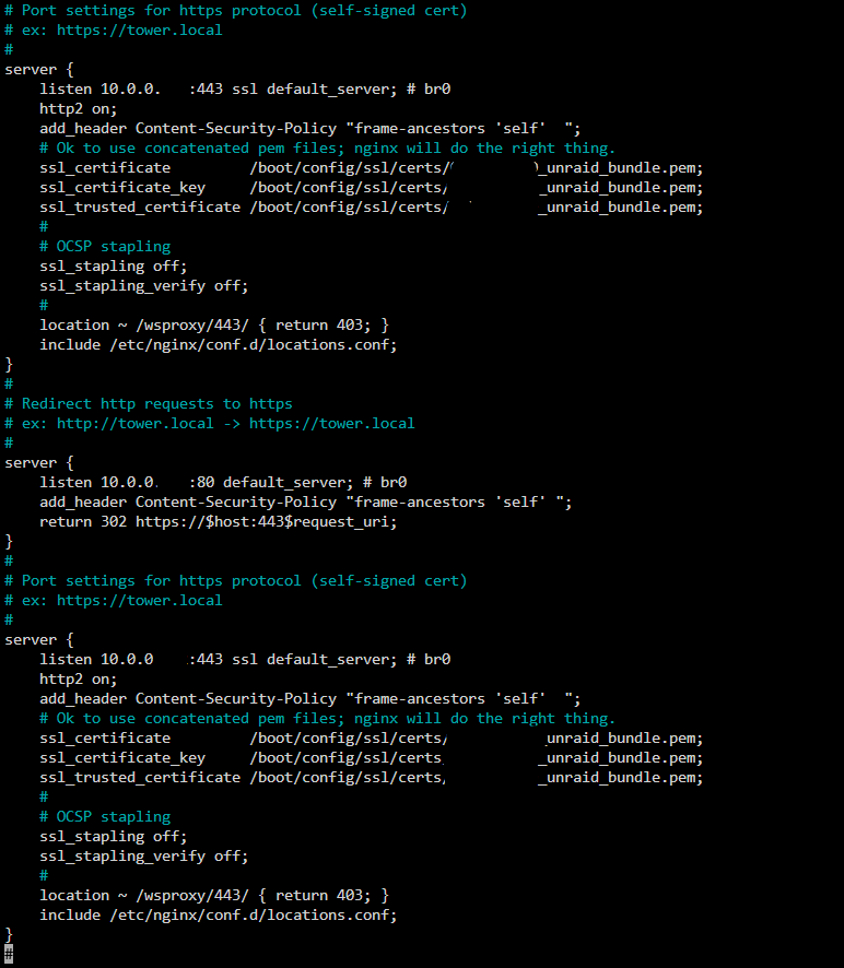

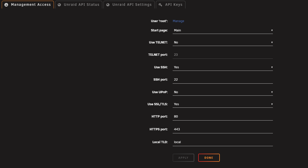

Hi All, I've been using and loving UNRAID for several years now with minimal issues, but this one has had me scratching my head for several months now! I keep getting this Nginx [emerg] warning that "a duplicate default server for x.x.x.x:443 in /etc/nginx/conf.d/servers.conf:70" and indeed if I check servers.conf there are two default server entries in there for the same address and same port. I've tried removing one manually, but some service keeps adding it again and I can't figure out what. If anyone can see a glaring config error I've made, please let me know.
