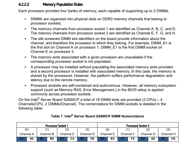

  3. Jorge, Thank you. Using Intel's Tech Spec I was able to find this page: I have pulled C1 & C2 (CPU 0, Channel 2) and so far no spurious reboots. I've already ordered replacement memory, but will run this way for a few days to see if everything looks good. If it does, I'll mark your comment as solution.

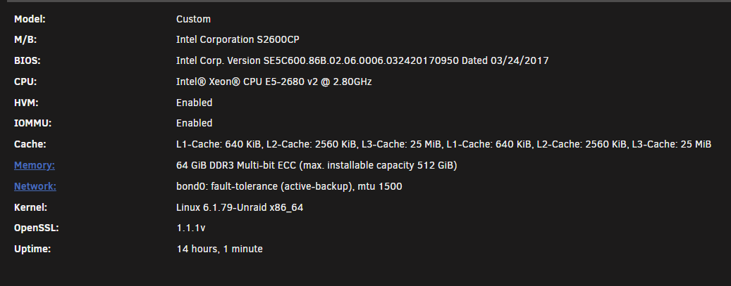

  5. Over past few months since I moved from MD to FL I have had my unraid server reboot unexpectedly. Unraid version: 6.12.10 Fix Common Issues pointed me to mcelog, which at /var/log/mcelog shows below. Parsing through this it appears to be Channel 2 Memory on the Mobo? MEMORY CONTROLLER RD_CHANNEL2_ERR Any recommendations would be appreciated.
