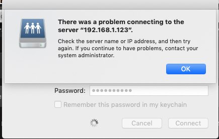

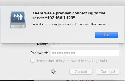

  21. I tried to connect Mac to UNRAID by doing: 1) On UNRAID, settings->Network Settings....under IPv4 address: 192.168.1.123/24 2) On UNRAID, settings->SMB settings-> enable SMB: "Yes (Workgroup)" 3. On Mac, Finder->Go->Connect to server with following settings "smb://192.168.1.123/24". As username and password, I entered my UNRAID username and password, which is "root", and password for root, then clicked on "Connect". I get following error (1st image) When I set "Enhanced macOS interoperability" to "Yes", I get also error (2nd image) What am I doing wrong?
