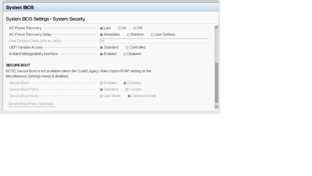

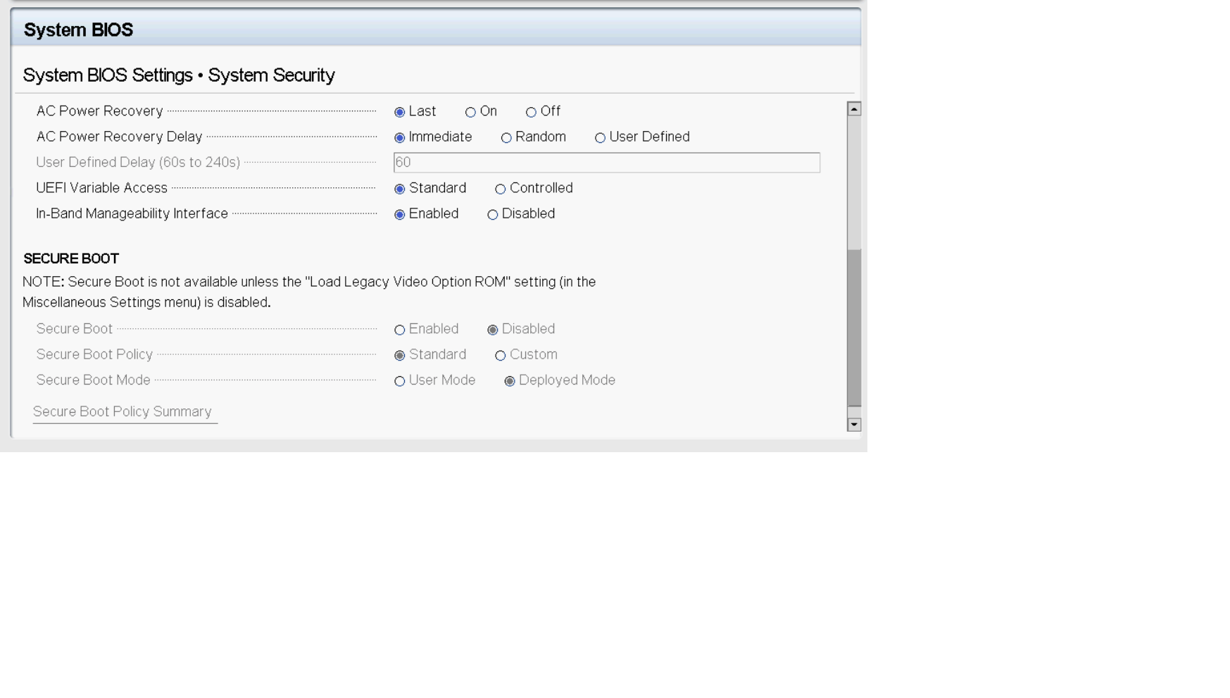

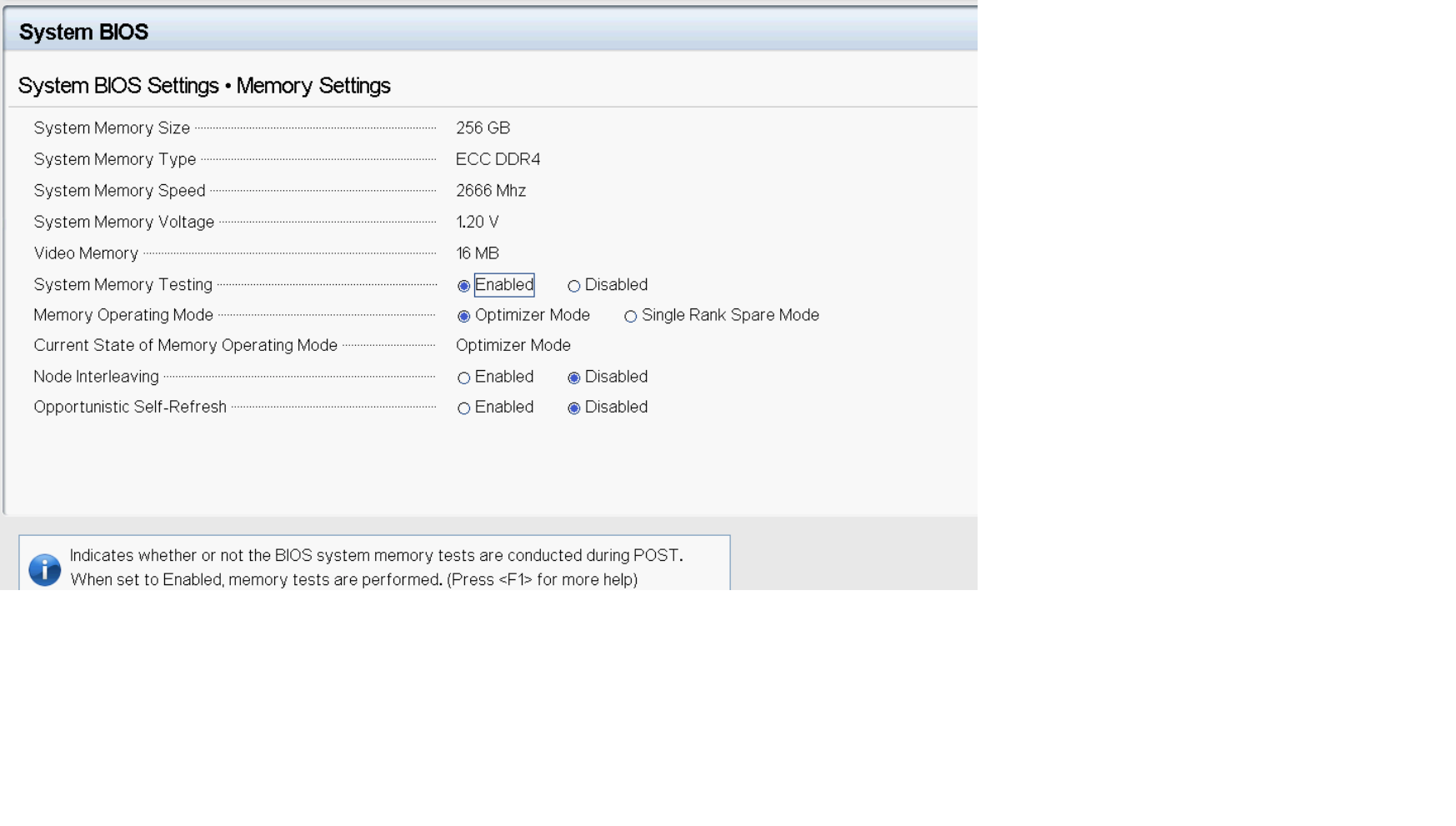

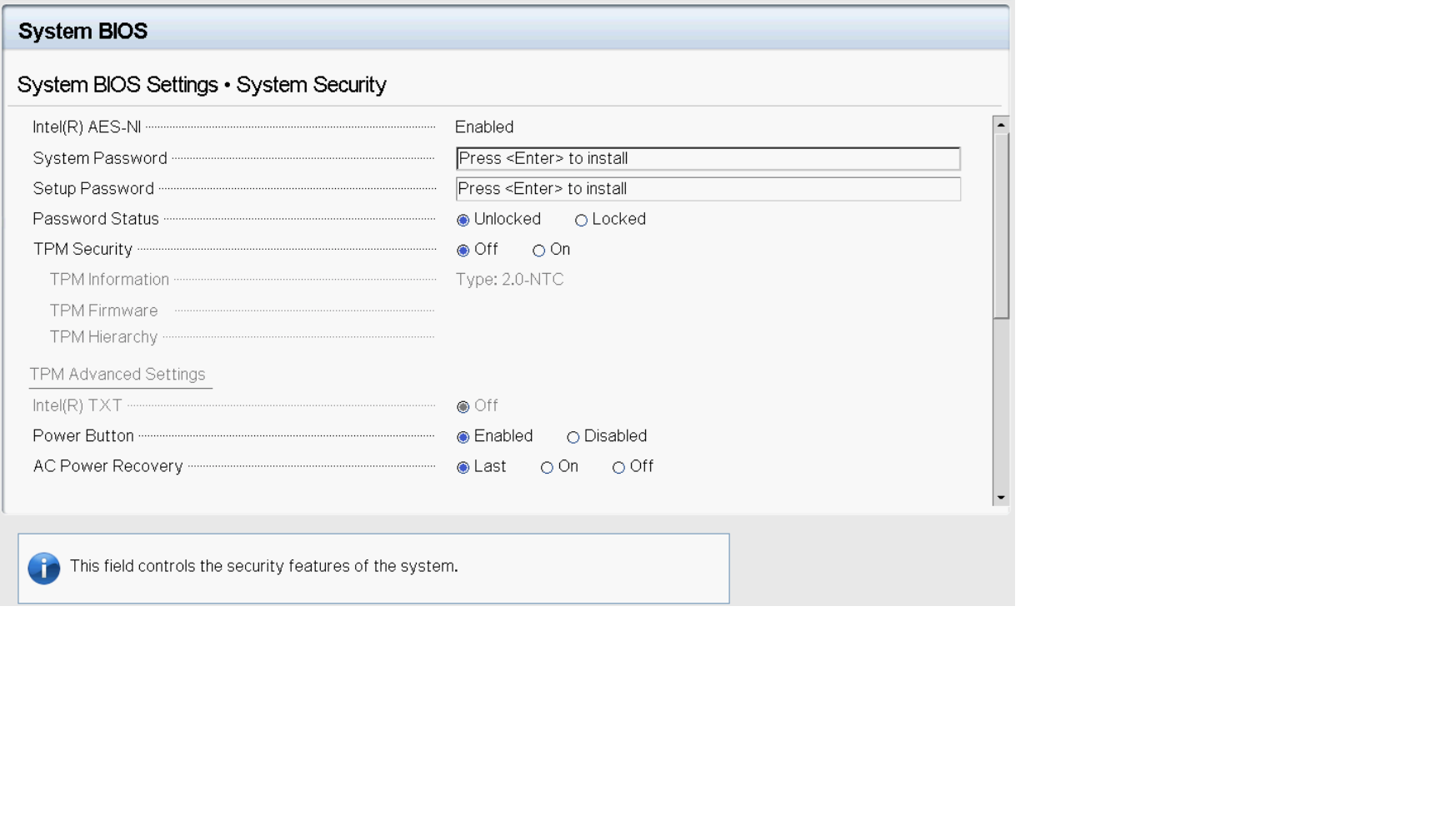

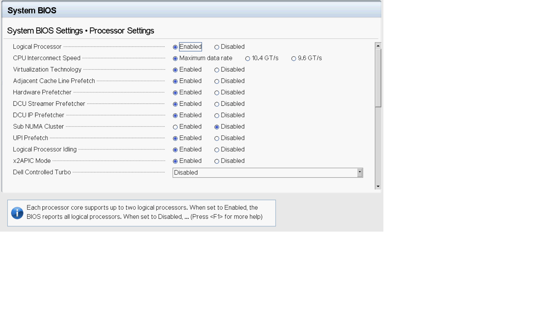

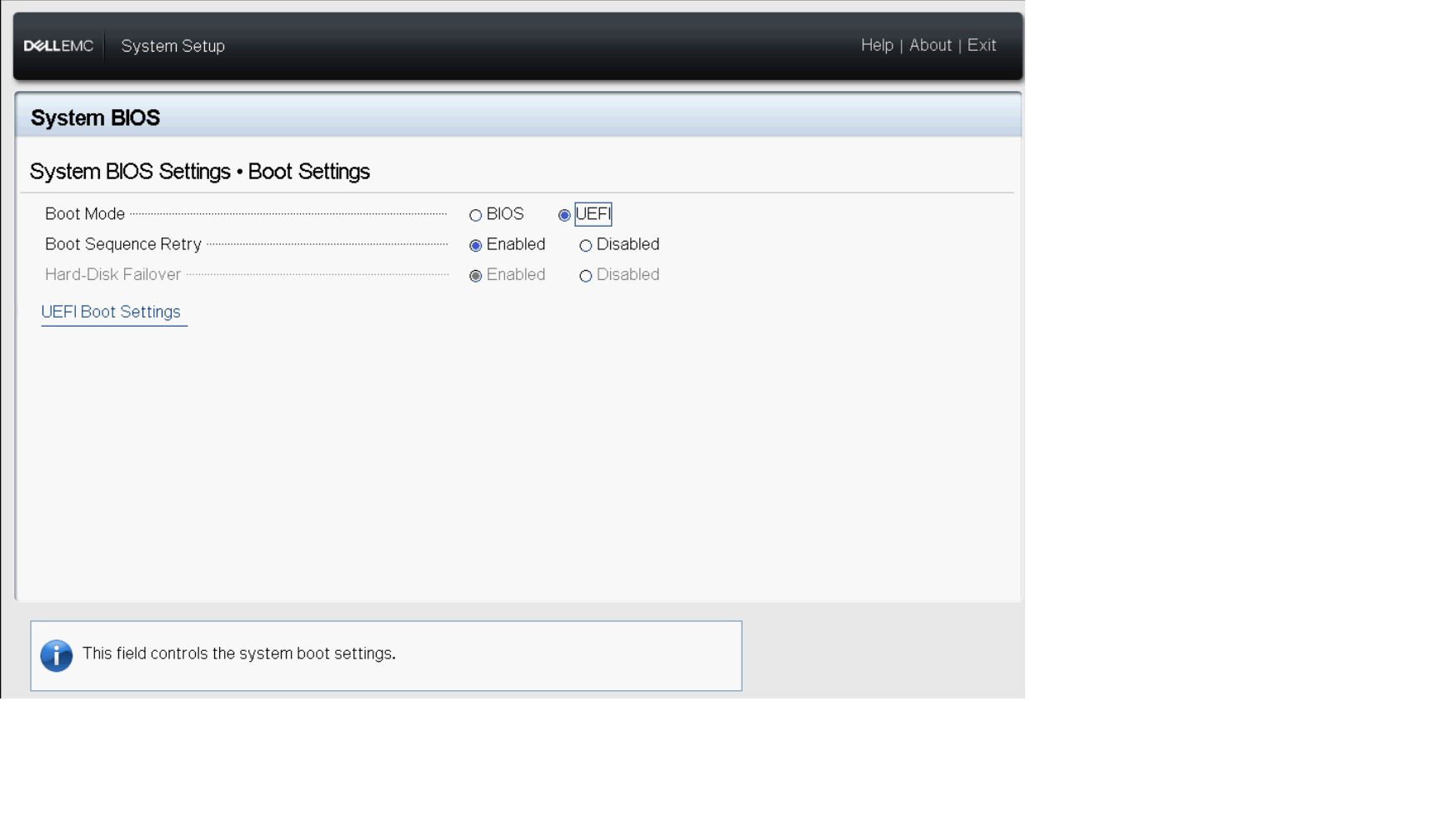

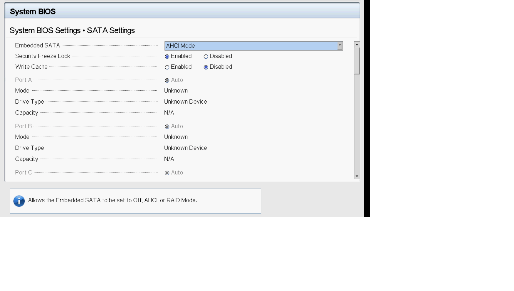

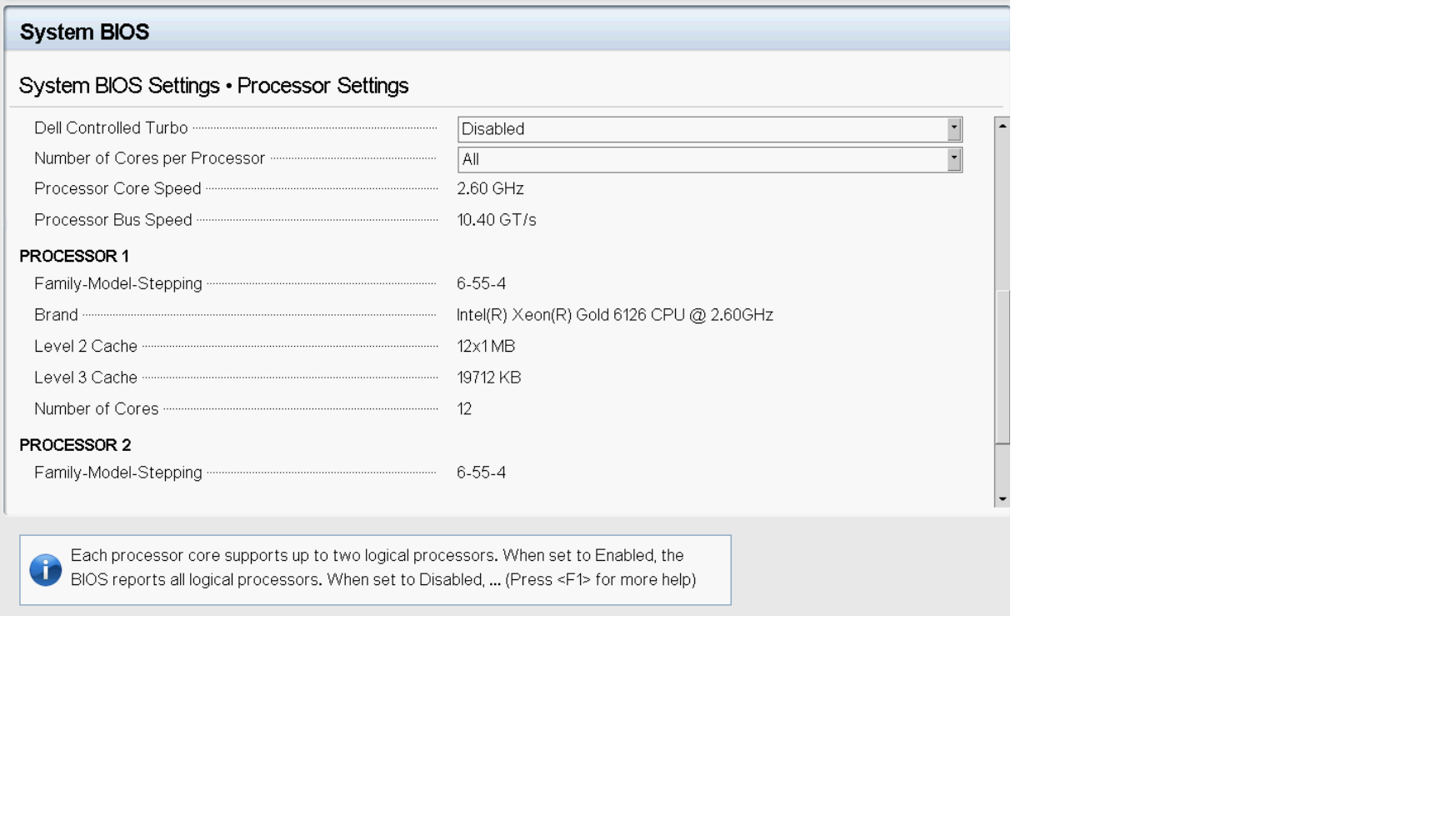

OK, got it nailed down.... Faulty stick of RAM. Very strange though as the BIOS RAM check was passing all of the RAM. Thank you for your help.- Unable to Boot, gets to "loading /bzroot...ok" and goes no further
Hi, Thank you for your reply. Still puzzled here. I have tried the unraid boot flash in all 5 of the USB slots and get the exact same result, i.e. stopping after the Loading /BZroot... OK - There are 2 o nthe front that i think are USB 2 and the others are all usb 3, but I get the same result on all slots. I switched to booting in legacy bios, and it would not get past the drive controllers and would not get as far as booting unraid. So I tried to get drastic and removed both SAS/SATA controllers and again, it made no difference (it was working with both of these previously) I put the unraid boot flash onto another pc, and it booted past the problem point, but not a complete boot, it hung not long after saying no pools available. (there was no SAS controller or drives in this PC, so not sure if that was the problem. So there must be a setting in the server PC Bios that has changed somehow, causing it to stop after the Loading /BZRROOT section. Here are some screenshots of bios settings, the Drive controllers are not installed when I took the screenshots, but I don't think that matters? - [Support] binhex - qBittorrentVPN
