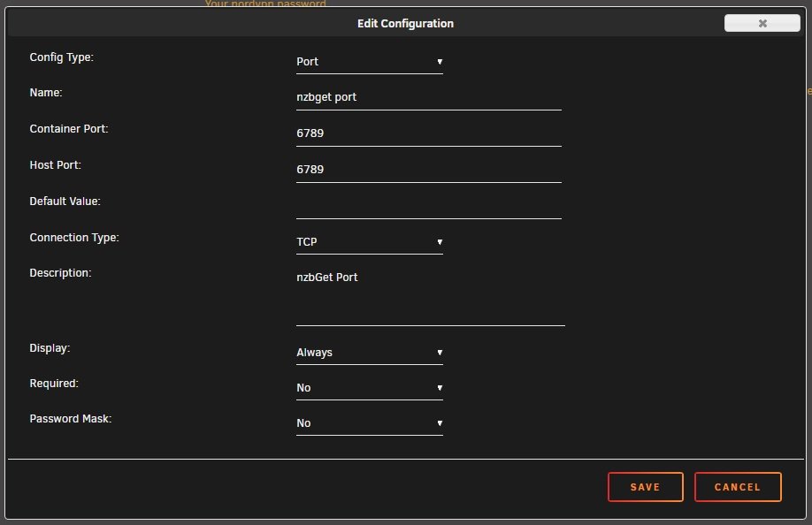

    Ok, As far as I am able to check this container is working with the NordLynx (NordVPN custom wireguard) protocol on my set up. I am able to route several docker containers through this container by changing their container settings as follows - eg NZBget firstly switch to advanced view then Network Type - None add the following to Extra Perameters --net=container:nordvpn Save this and then add an additional port within your nordvpn container Once completed you will need to use the local server URL:port to access the other docker web gui EG - NZBget could be accessed at 192.168.1.1:6789 if your server is local ip address 192.168.1.1 I'm no expert at this but to check what ip address your containers are connecting to open a NordVPN docker Console (Terminal) window by left clicking the Nord icon and selecting console. Type the following curl ifconfig.me The response should be a different IP address to that of your main server terminal window, you can also check other containers, but NZBget does not have Curl installed so it wont show in NZBget console. Hopefully that all makes sense, but if not search up more spaceinvader videos and also this old reddit thread may be worth a read Reddit: Passing dockers through a vpn container

    All Working on NordLynx here. Thanks for a fab docker. So to recap for those with issues- 1- check network setting in the nordvpn template, you need to click 'show more settings' to see this and remember if you access your router settings page on 192.168.100.1 then your network setting would be 192.168.100.0/24 (google CIDR notation for more) 2- check your nord access credentials, its easy to mistype a username or password. 3- add the nzbGET port as an additional port to nordvpn docker. If using the default port 6789 with nzbget then add to nordvpn Config Type : Port Name : nzbGET Container Port : 6789 Host Port : 6789 Connection Type : TCP Description : nzbget port 4- The only setting to change on the nzbGET docker config page is the network, if nzbget worked before then just change the network settings. To do this, select Advanced View, select 'None' for network type and add only the following text to Extra Parameters '--net=container:nordvpn' 4- Start the Nord Docker, there is no web gui but to check its working click its icon and click console then type curl ifconfig.io this should return an ip address, it should be different to your host machine ip - google whats my ip to verify. 5- start or restart nzbGET 6- type your unraid server LAN IP address : 6789 into the address bar ie. 192.168.100.100:6789 7- hopefully you are now seeing the nzbget web gui Well it works for me so sorry if this is confusing or it still doesnt work
