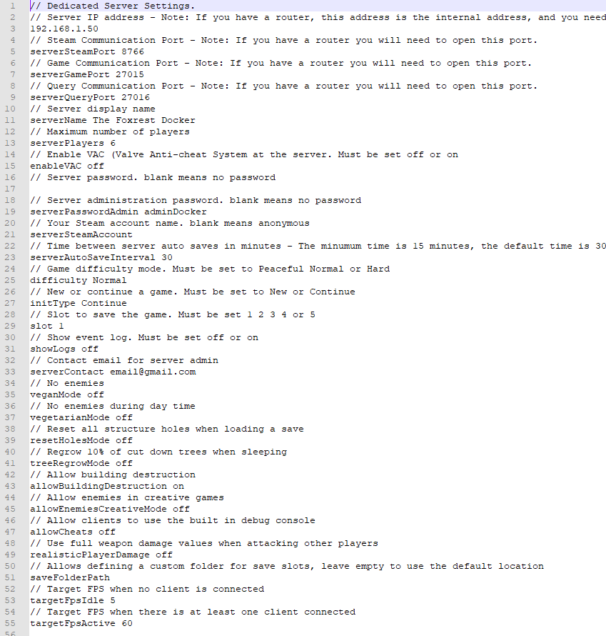

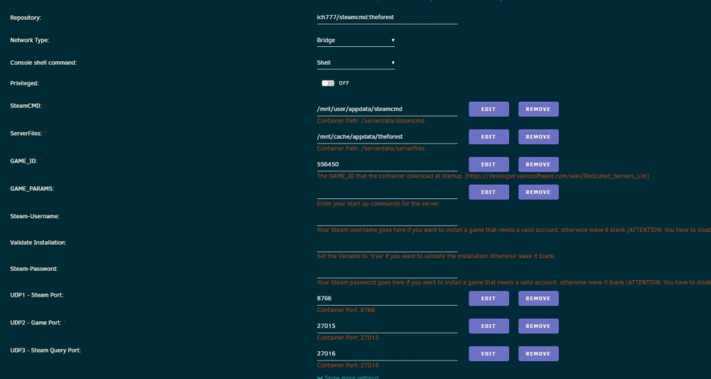

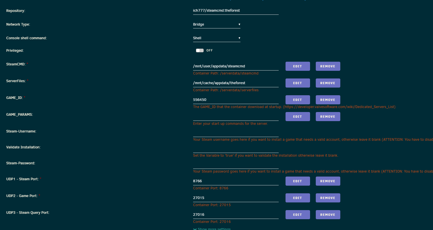

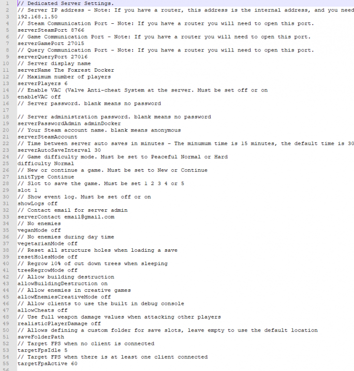

  22. Its working now. the fix was: 1 - do not use another steam account to download the server. use public. 2 - do not edit the IP details in the server config 3 - remove TCP entrties from the docker settings 4 - be patient

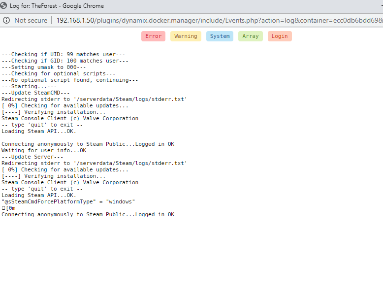

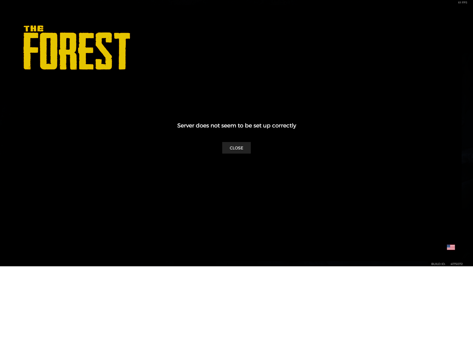

  23. thanks did download in the end. Deleted everything New error now
  24. just gets stuck on here without creds
