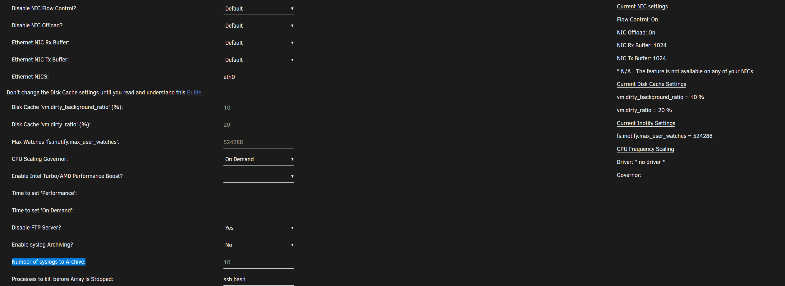

do you have dynamix system temperature? It's a plugin.

Bingo that was it. I am only seeing boosting to 4.15 Ghz. Is that configurable in the bios ?

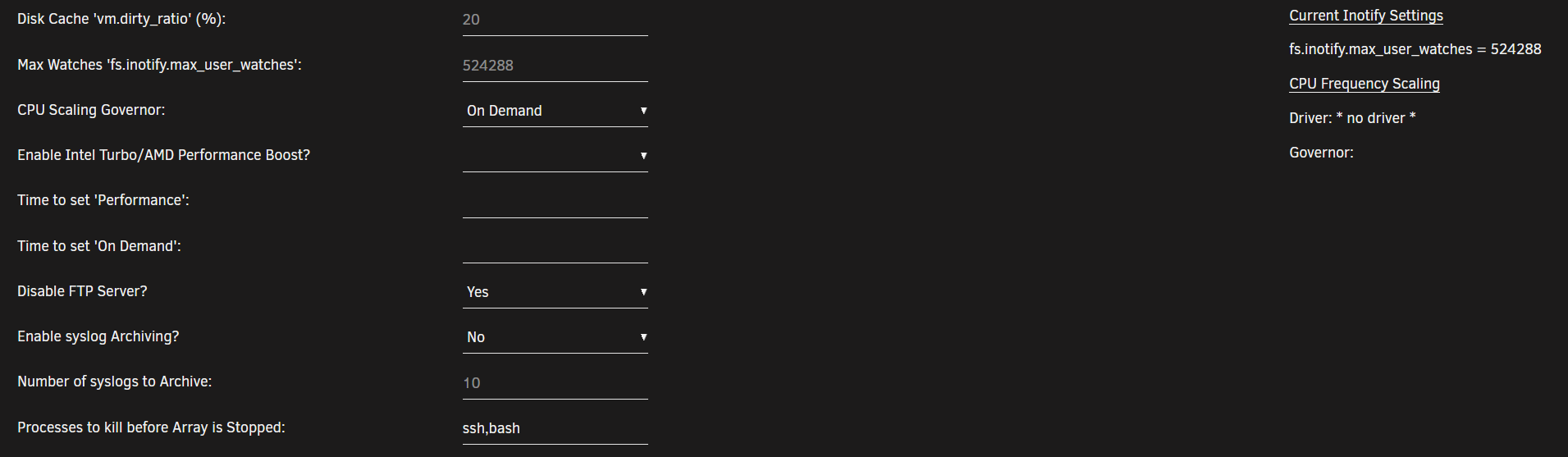

I can't seem to get the proper driver running for my 3900x cpu on an x470 motherboard. Running the penultimate bios. In tips and tweaks it says no driver, with no performance boost option selectable: Any reasons why this may be ? tower-diagnostics-20210804-1459.zip

Running 6.9.2, 3900x on a x470 board. In tips and tweaks it says "no drivers" and Turbo boost option is blank. Governers are selectable. Do I need to load my own driver ? root@Tower:~# cpufreq-info cpufrequtils 008: cpufreq-info (C) Dominik Brodowski 2004-2009 Report errors and bugs to [email protected], please. analyzing CPU 0: no or unknown cpufreq driver is active on this CPU maximum transition latency: 4294.55 ms. analyzing CPU 1:

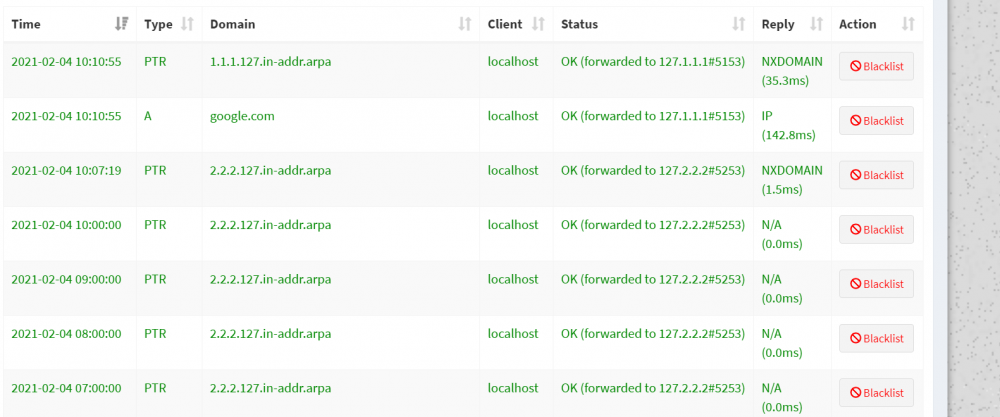

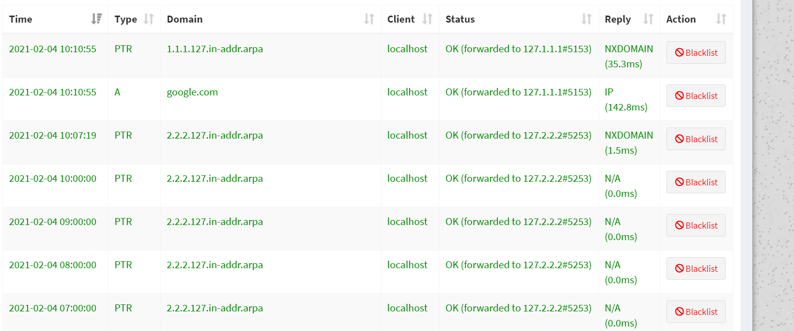

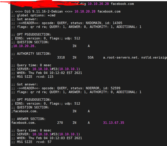

I have a separate VLAN for docker containers (br0.20) , and a separate VLAN for management of unraid. Using static IP. Since the container is pulling the DNS server from the main unraid interface, Pihole is trying to cross the VLAN to the DNS server on the other VLAN for connectivity checks which isn't ideal. 10.10.20.28 is pihole's static address, however it's 10.10.10.1 that responds (which is what the DNS is set to for my management vlan). Is there any way to clean this up, and keep pihole contained on it's own VLAN without having it cross boundries? Also I have these strange dns requests in logging which I can't make sense of. "*.in-addr.arpa"

Regarding pihole, I have a situation where I have a segmented Vlan for all dockers, which means when pihole tries to talk out to the Unraid specified vlan, it tries to go to another network. Is there anyway to hardcode something that is on the same vlan/subnet?
