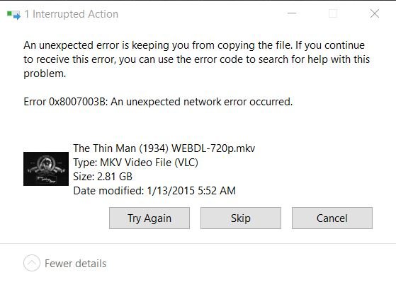

  4. I've also got this issue happening when I copy large files from the unRAID box down to my Windows 10 machine. I've tried this on two different physical Windows 10 boxes and got the same error. unRAID is V6.7.2 Windows 10 is 1803 Build 17134.885
