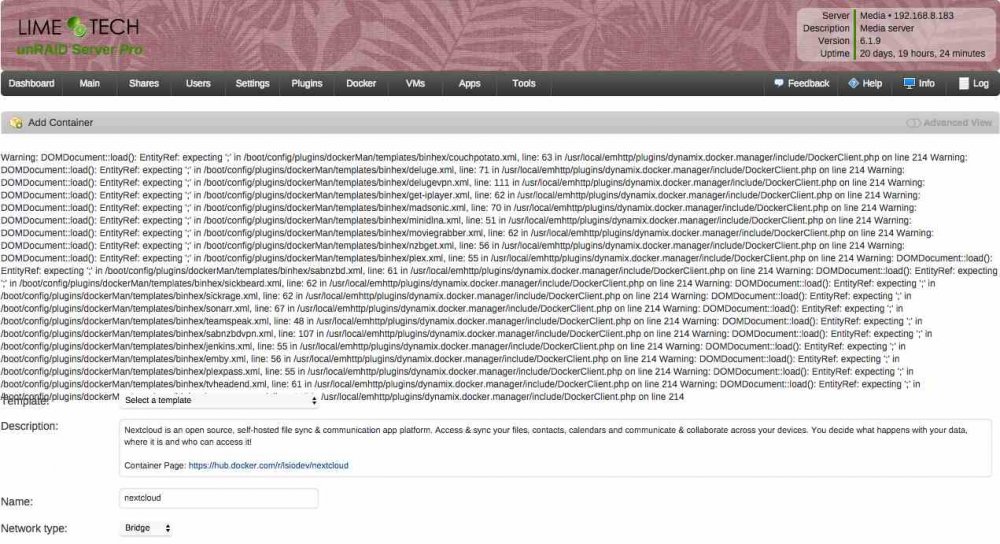

Thank you Squid. That fixed it. I did not realize that CA eliminated the need to have the repositories entered on the docker page.

Tried to install using community applications and got a screenful of error messages. Screenshot attached. I updated the Community applications to the latest version before clicking on the add button. Running UR 6.1.9

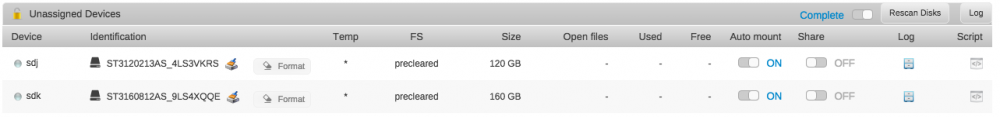

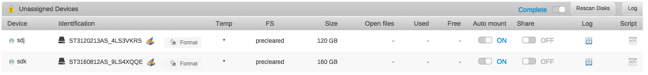

I set up a test server so I can help with debugging. I put 2 small hard drives into the test server and precleared them. The format button appears, but is greyed out. See attached image. This is with UD version 2016.04.16a. Here is what's in UD's log: Apr 14 15:48:04 Removing configuration '//192.168.8.183/cache'. Apr 16 09:26:34 Disk with serial 'ST3120213AS_4LS3VKRS' is not set to auto mount and will not be mounted... Apr 16 09:28:04 Disk with serial 'ST3120213AS_4LS3VKRS' is not set to auto mount and will not be mounted... Apr 16 10:43:07 Disk with serial 'ST3160812AS_9LS4XQQE' is not set to auto mount and will not be mounted... Apr 16 10:57:40 Disk with serial 'ST3160812AS_9LS4XQQE' is not set to auto mount and will not be mounted... Apr 16 11:32:31 Disk with serial 'ST3120213AS_4LS3VKRS' is not set to auto mount and will not be mounted... Apr 16 11:43:21 Disk with serial 'ST3160812AS_9LS4XQQE' is not set to auto mount and will not be mounted... Apr 16 13:34:57 Adding disk '/dev/sdj1'... Apr 16 13:34:57 Mount drive command: /sbin/mount -t precleared -o auto,async,noatime,nodiratime '/dev/sdj1' '/mnt/disks/ST3120213AS_4LS3VKRS' Apr 16 13:34:57 Mount of '/dev/sdj1' failed. Error message: mount: unknown filesystem type 'precleared' Apr 16 13:34:57 Adding disk '/dev/sdk1'... Apr 16 13:34:57 Mount drive command: /sbin/mount -t precleared -o auto,async,noatime,nodiratime '/dev/sdk1' '/mnt/disks/seagate160' Apr 16 13:34:57 Mount of '/dev/sdk1' failed. Error message: mount: unknown filesystem type 'precleared'
