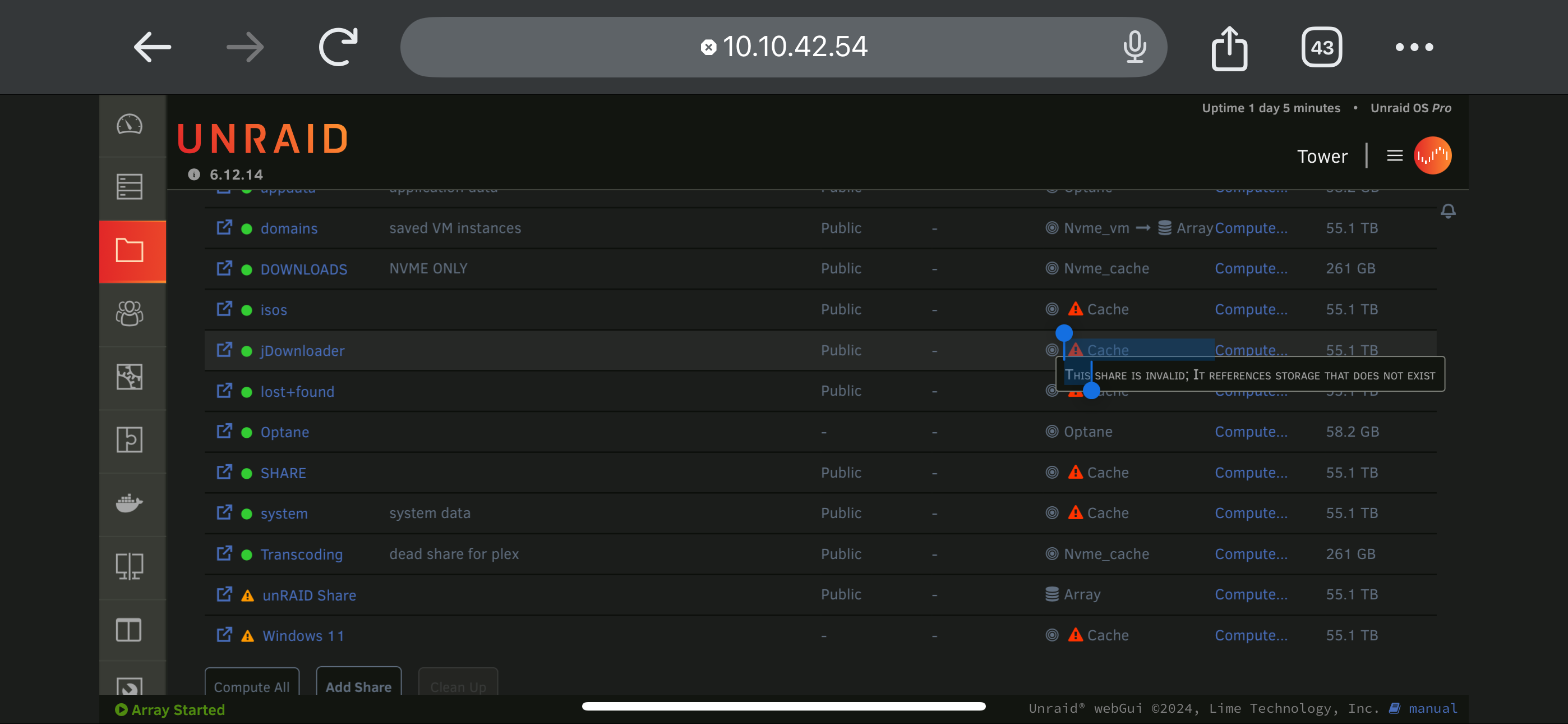

  6. Thanks I selected another pool and then put it back and after saving the changes it fixed the issue. Thanks.
  7. After this update I get many of my shares showing a cache is not found. Oddly enough I never used this cache for any of them and they go straight to the array.

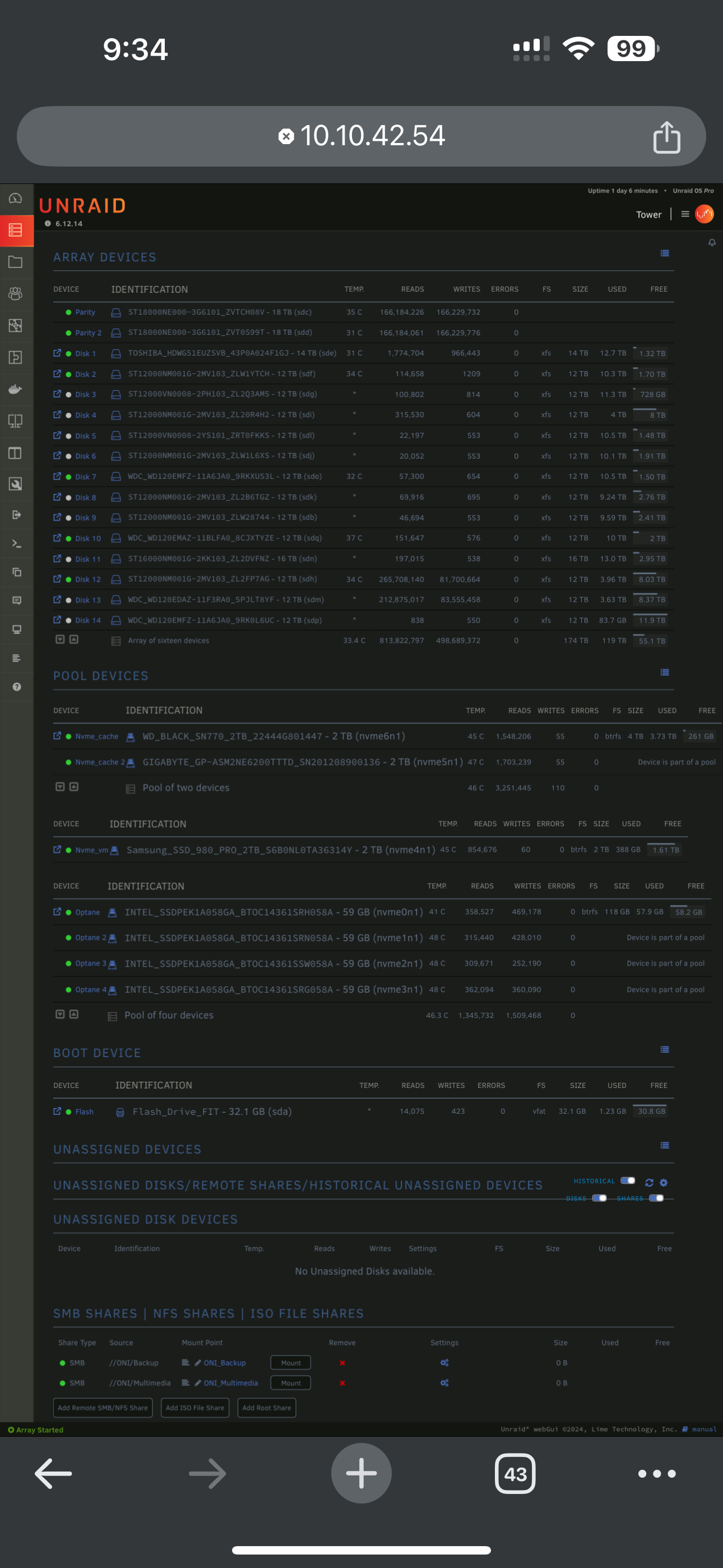

  8. You nailed it. I used more than one splitter on one of my cables. I removed it and reoganized some pSATA cables and I'm back to full speed. Thanks.
  9. Yes I am using a splitter. The PSU is a 1200watt psu so I assumed that power was not a problem but you might be on to something. I am using two splitters for my pSATA.
  10. No I swapped it with Disk 4 for the power cable and used another SATA port and a new sata cable on disk 5. I have a theory; I am using one of the two Asus PCIE cards (I posted about in the first thread) to house the nvme to sata cards. Would that cause these issues?
  11. I replaced the SATA cable with a new one and switched the power cable with another drive. The issue is still the same.tower-diagnostics-20241028-1959.zip
  12. tower-diagnostics-20241027-1331.zip Does this work better?
  13. tower-diagnostics-20241025-2051.zipHere are the diagnostics for my server.
  14. Two of my drives needed to be repaired because they became disabled, and I just had to remove and re-add then to queue the rebuild. The drives are practically brand new and even when I replaced them with another good drive, but they still had a slow rebuild speed. So, I replaced all the SATA cables with new ones, and I still have the same problem (this has happened before, so I got desperate). I know in the past there was some approved sata cards that I added to my setup, but I wanted to make sure I did not have something in my setup that is not good. So here goes: I have two of these: and two of these: Benchmark docker also shows the following: Any help is appreciated!
