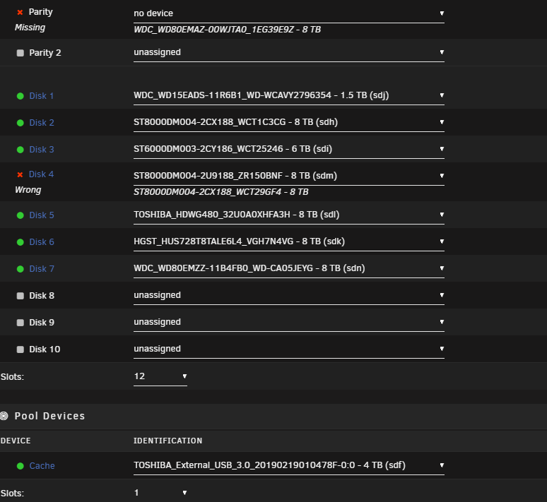

update: my tower is now booting, I am using a new flash drive with the config folder copied over. but it now cant see my parity disk and disk 4 is saying wrong tower2-diagnostics-20241222-2012.zip
