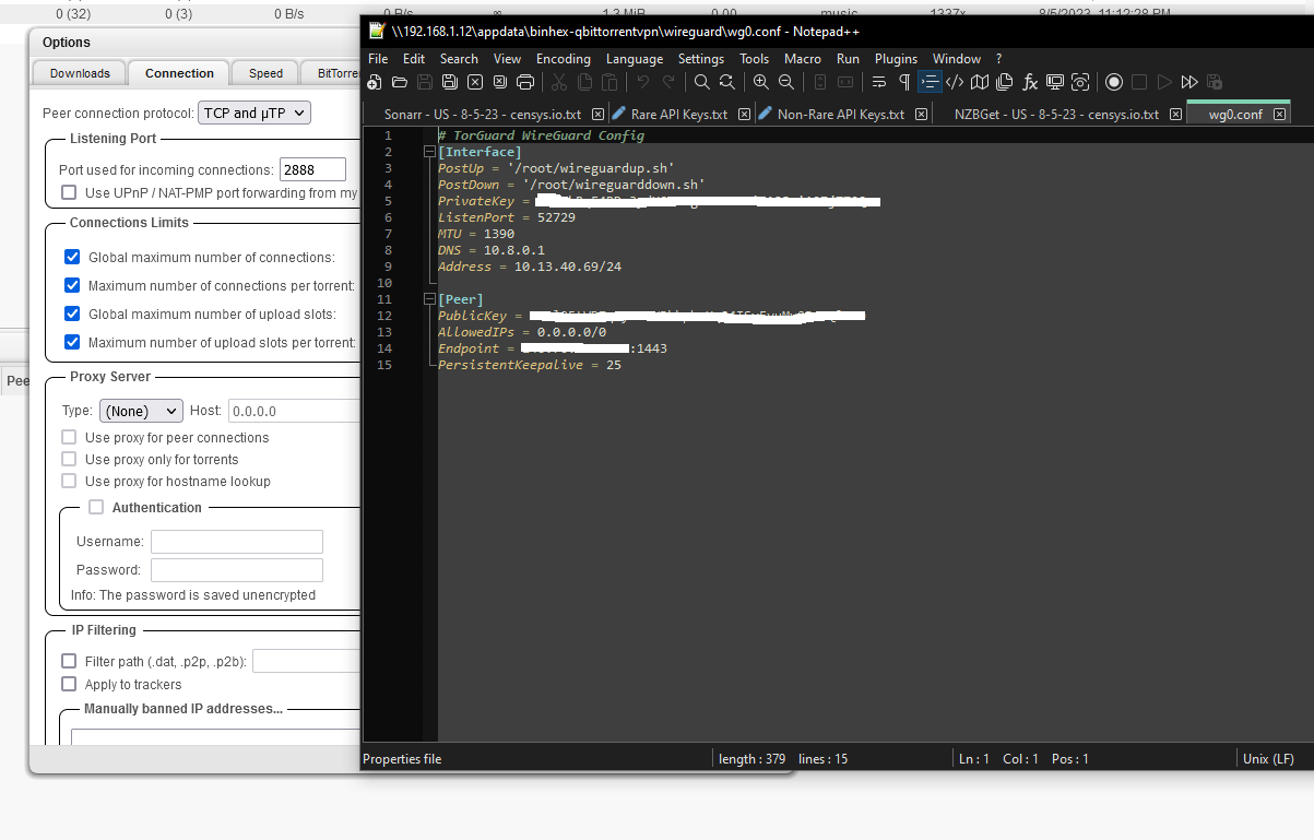

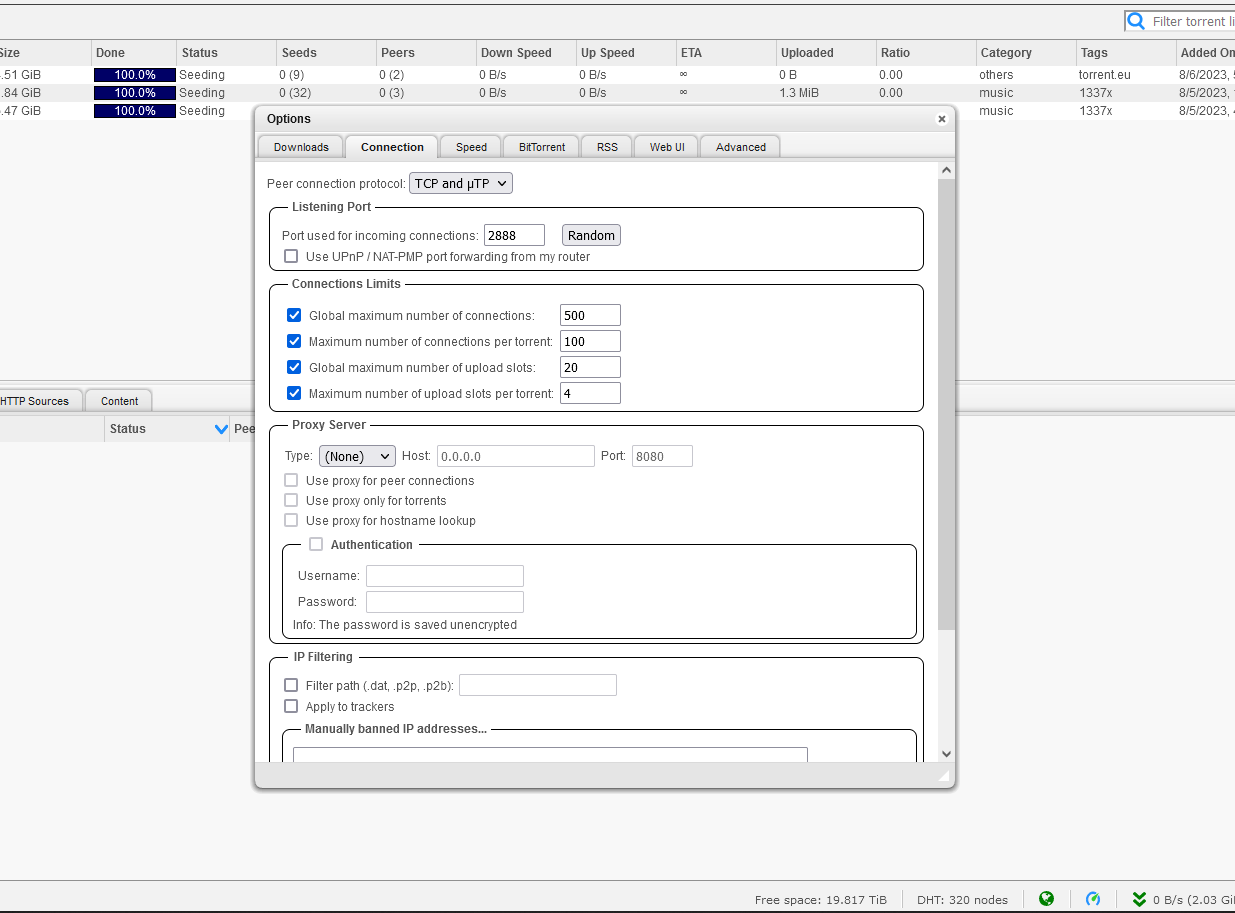

Can you guys help me figure out what's going on here? I'm missing some sort of understand of how things are working. Here's the issue: Every once in a while it seems like my VPN provider (Torguard) either closes or drops my port, leaving me not connectable. I'm using a wireguard connection with the container. Here are some of my settings: You can see here I'm connectable and everything seems to be fine. And it is for now. But the settings and configs are just not adding up to me. Here is the wg0.conf file I created with the config generator on Torguard: And here are my configured ports on Torguard: Now these ports aren't even assigned to the server in the wg0.conf file. I went back to a generic regional (Toronto) server just trying things out to see if I could get something working. I had originally created the wg0.conf file to match the specific IP that I created the ports on, but it wouldn't connect. Can someone help me make sense of this? It's baffling to me. Thanks!
