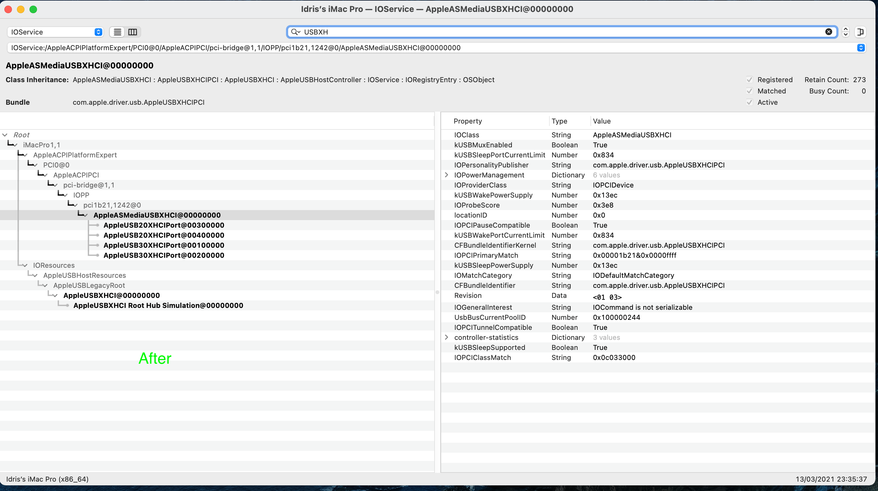

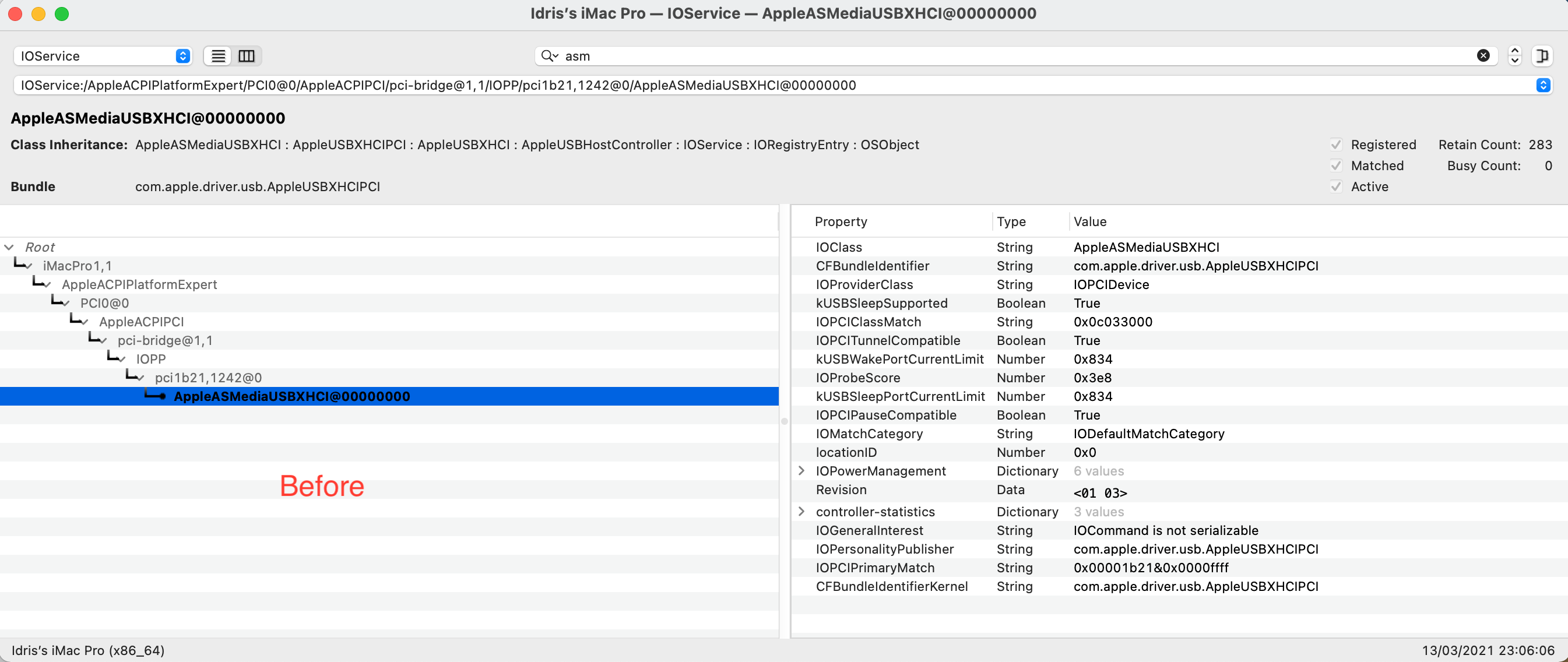

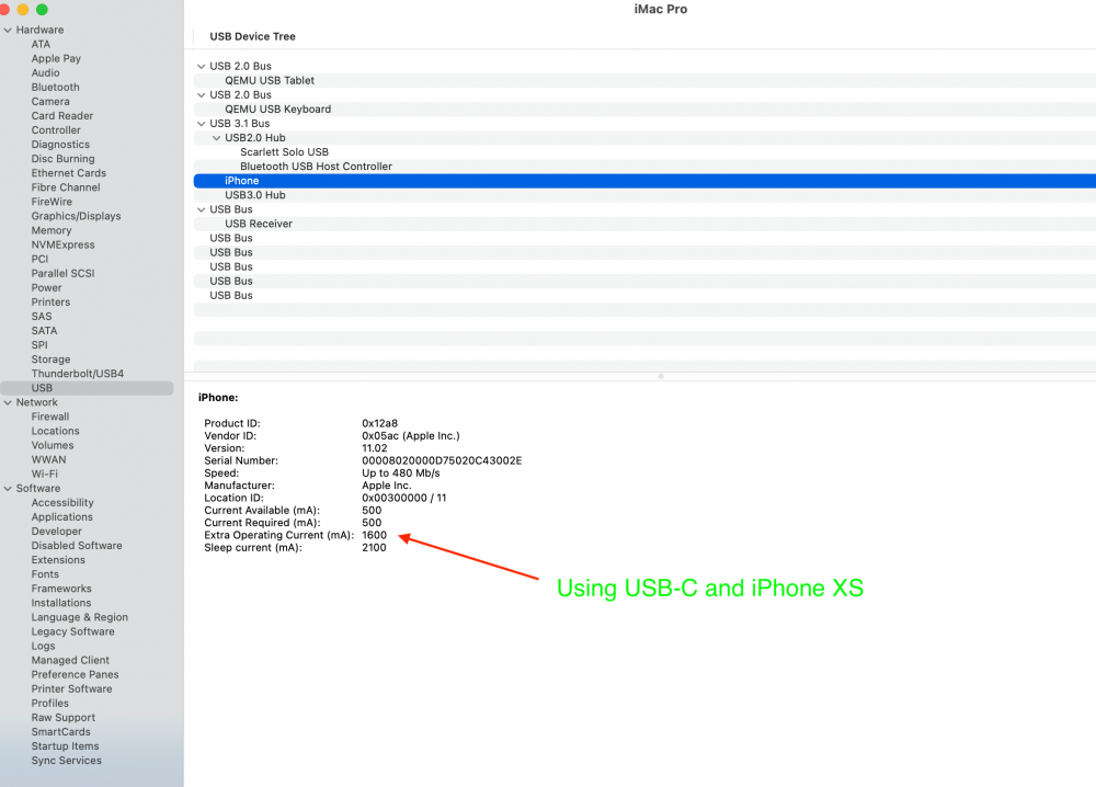

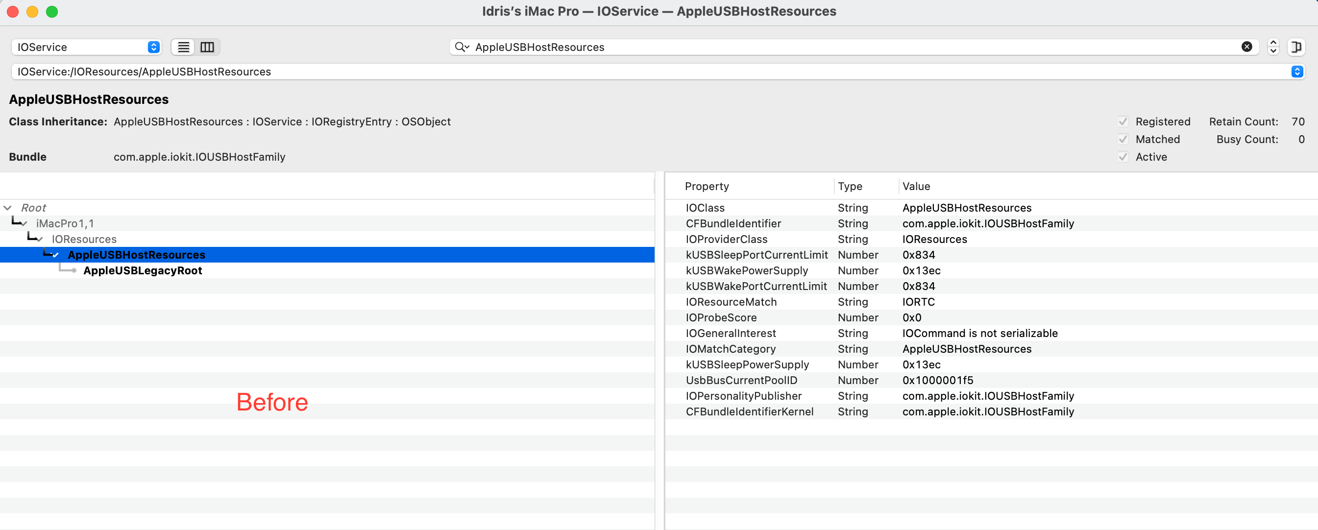

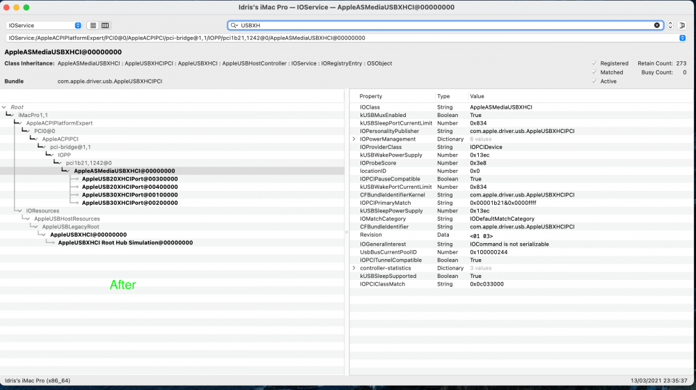

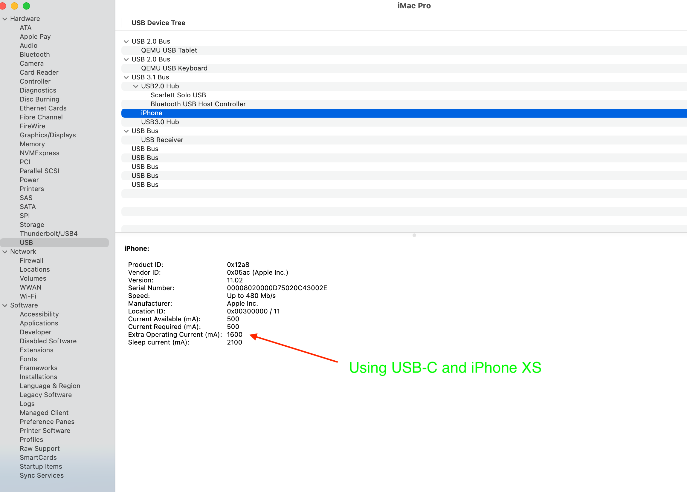

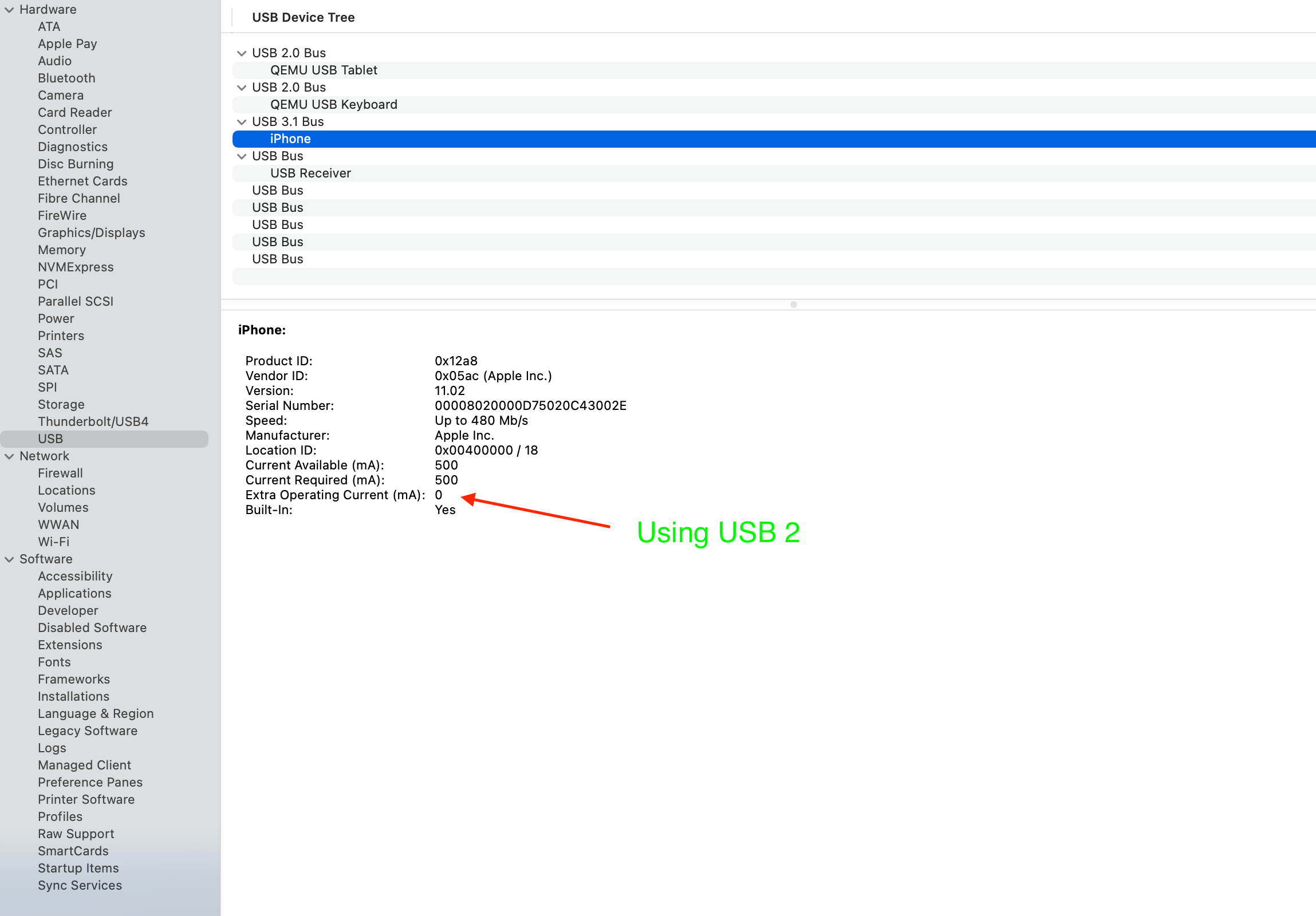

  1. I was able to replicate your kext setup, I combined them in USBPower-ALLINONE.kext. I did map my USB probably using USBMap. I Will give you more feedback about the audio issue but its better than before but I think its related to BigSur more than USB power. When Using Catalina VM work perfect. Yes the right circumstances was USB-C Cable and maybe iPhone that support fast charing? I am not sure as I only have iPhone XS and that support Fast charing.
  2. Thanks. I was able to have the same result as you fully explained where the problem is. Yes the audio dropout I can say it slightly better now, need more testing but there is improvement. Here is the iPhone connected to the AsMedia hub. If you spot something I didn't apply correctly just let me know happy to test
  3. @ghost82 Hello I successfully updated my VM to BigSur everything went smoothly using macinbox. Had the KP but changing the network to virtio as @bjornatic suggested seem has fixed the problem. Now I have a small problem with USB audio dropouts I use ASM1142 and Scarlett 3rd Gen worked great under Catalina. I am not sure if this a general bug as I see some people mentioned in the apple discussion forum. Maybe I am missing something? related to configuring USB Power? I upload my EFI so maybe you can point me out.

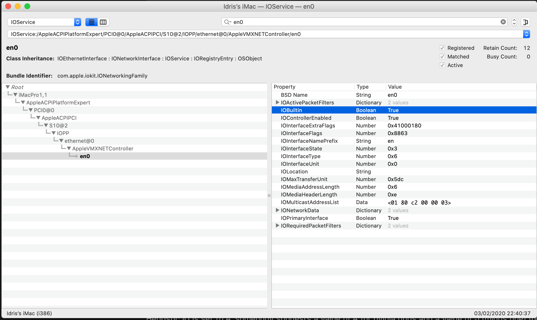

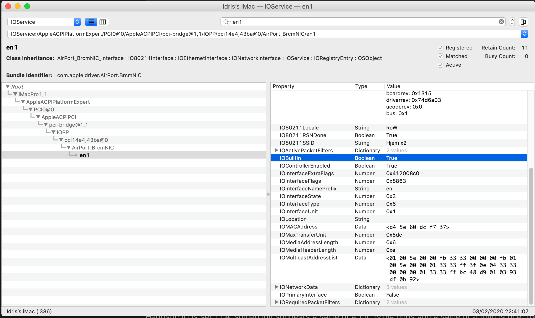

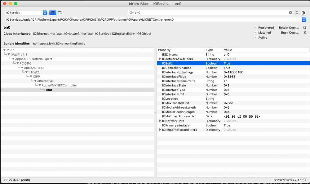

  6. It was a silly mistake to not put the *.aml files in the custom folder in side ACPI, forgive me because I am totally noob when it comes to OC. Everything works now as intended, thank you very much I do really appreciate your time and efforts. I fixed en0 and en1 to built-in=yes. Although one of them is a PCI wireless card. I attached the new modified ioreg file+OC folder in case if you have any more suggestions. But everything work perfectly. Fixed OK.zip

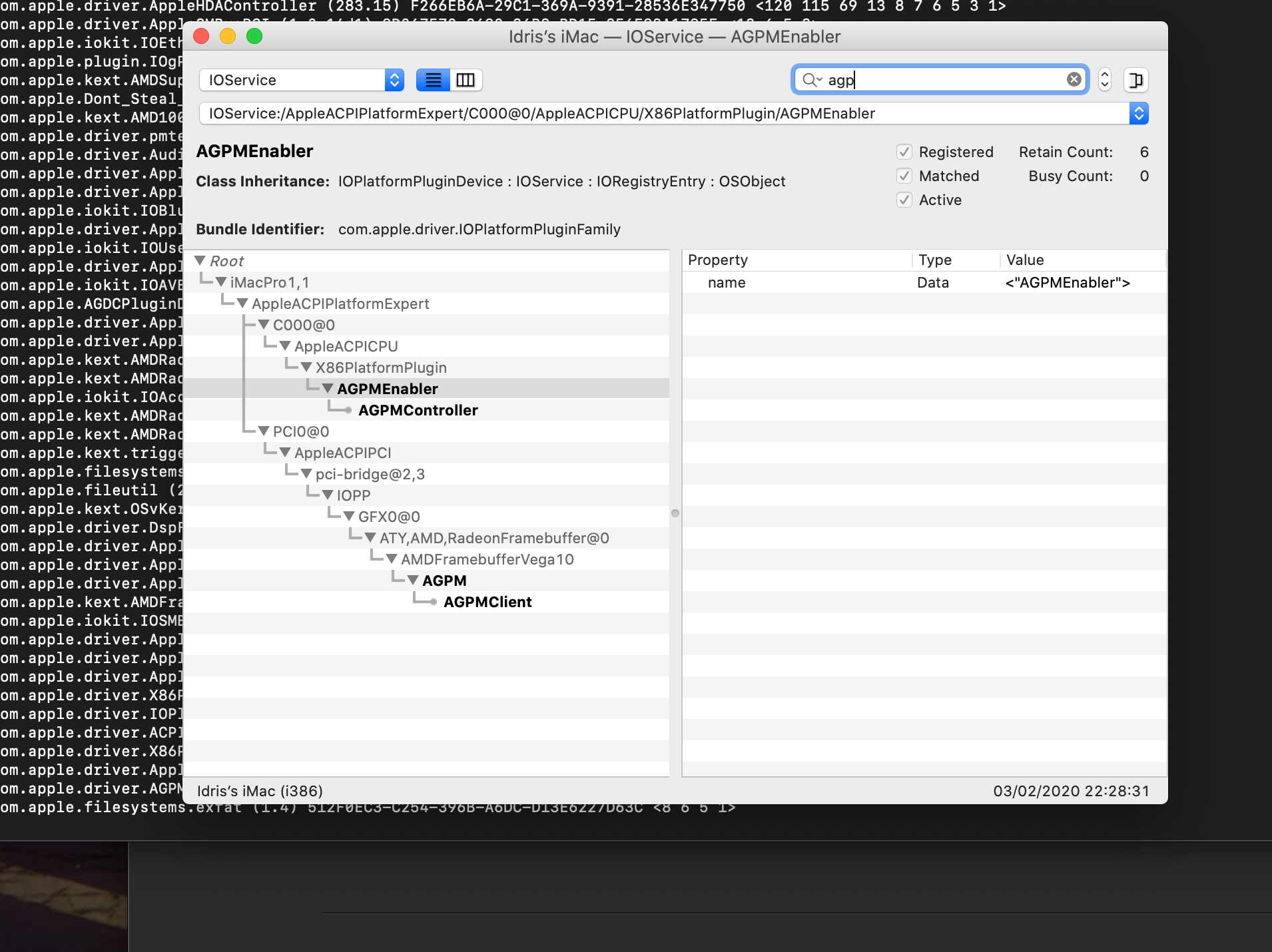

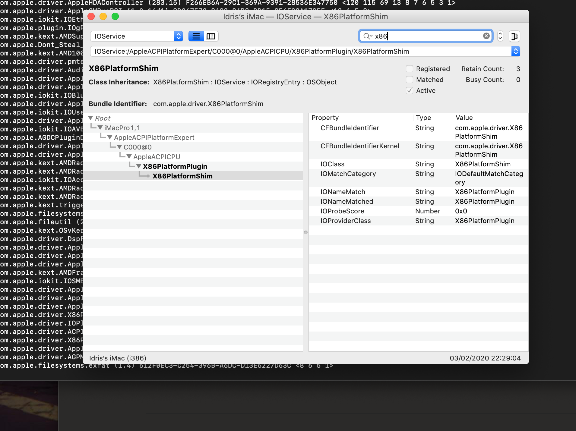

  9. Thank you for the extended clarification and those very useful informations, I was able to apply most of your suggestions and for the first time iMacPro1,1 work without any kernel panic. 1- ACPI section: I did as you suggested and I used the SSDT-cpu.aml you provided, but I couldn't able to make x86platformplugin to load at all, I have the following CPU features: <qemu:commandline> <qemu:arg value='-device'/> <qemu:arg value='-cpu'/> <qemu:arg value='IvyBridge,vendor=GenuineIntel,+hypervisor,-erms,+invtsc,kvm=on,+topoext,+svm,+invtsc,+fma,+mmxext,+avx,+avx2,+aes,+xsave,+xsaveopt,+ssse3,+sse4_2,+popcnt,+sse4a,+bmi1,+bmi2,+arat,+abm,+3dnowprefetch,+adx,+clflushopt,+cr8legacy,+fsgsbase,+fxsr_opt,+misalignsse,+movbe,+osvw,+pclmuldq,+pdpe1gb,+rdrand,+rdseed,+rdtscp,+sha-ni,+smap,+smep,+svm,+vme,+xgetbv1,+xsave,+xsavec,+clwb,+umip,+topoext,+perfctr-core,+amd-ssbd,+wbnoinvd'/> </qemu:commandline> I do planing to make it work because as you suggested it useful to let load AGPM, to manage the power management of the GPU. I read about this a little bit but I am a bit confused do I need SSDT.aml and run Pike's ssdtPRGen.sh script to generate this file. because in my case I passthrough my CPUs as Ivy Bridge? I do use dual E5-2690 v4 "Broadwell" in my unraid system I passthrough all the cores expect one core for other unraid tasks. 2- DeviceProperties section: layout-id it works with <integer> I didn't touch it as use suggested. I do have a BCM94360cs2 card passthorged as PCI device for the apple store/imessage/etc. to work. 3- Kernel section (kexts): I updated Lilu, Whatevergreen and AppleALC, I add the 3 kexts you suggested AppleMCEReporterDisabler, AGPMInjector and AppleLPCInjector. All of them loaded when I check through kextstat expet AGPMInjector: I need to make the x86platformplugin load first so I can confirm if it loading or not. 4- Kernel patch: I changed the "avoid a x86 validate topology error" from 1 to 0 as you suggested. 5- UEFI section: I add HFSPlus.efi didn't know that it is necessary when I have to load the recovery partition, I add also AppleUsbKbDxe even thought my mouse and keyboard work without it before but I add it anyway. I can provide any log or debug files in case if you wanna help me to make the x86platformplugin to load.
