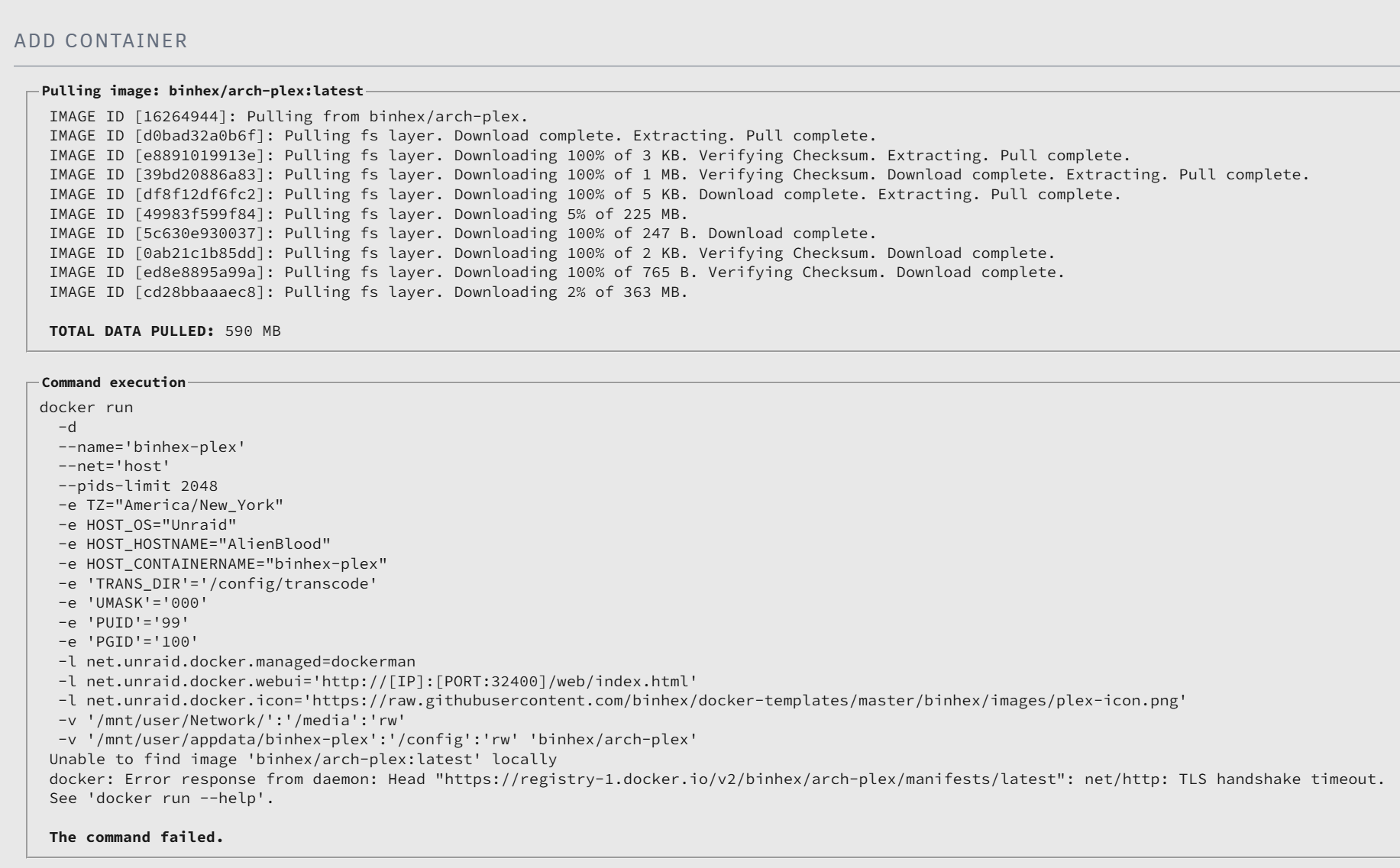

  1. That didn't work either. I can't add the container from the docker page either. I'm attaching screenshots and my diagnostics. alienblood-diagnostics-20250714-0926.zip

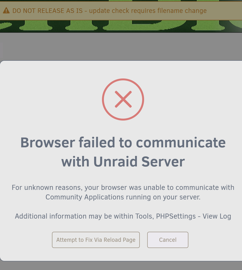

  2. I cannot get my community apps to work. I've tried everything and I'm not sure what else to do. I don't know if it's a DNS issue or if it's my server. Everything else works great, but I can't get it to work. I've even factory reset my router. I have an Xfinity xFi router/modem combo. I'm working on trying to replace it with an individual router and modem, but this is what I'm working with for the time being. I've tried changing the DNS settings on unraid to all of the recommended ones, restarting my server, restarting my router, factory resetting my router, downloading a stock version of unraid to a new flash drive and loading it, same issues. I've tried to uninstall CA, reinstall, restarting my server in between. I deleted my docker image because it was at 50GB so I was going to try to get to the bottom of it, but now I cannot download any of my containers. I'm hitting a wall here. alienblood-diagnostics-20250710-2102.zip
  3. I ran the memtest for 4 passes and everything was great, no errors at all. However, now I have a new problem, I increased my Docker size a while back (I'm not sure why, I was tinkering around). I deleted the image to go back to 20GB, and then I was going to add back my containers from the templates. Well, the templates wouldn't load, so I figured I'd load them from the community apps tab and configure as needed. Then I couldn't get community apps to load, so I did the updates needed and it still wouldn't load. I deleted the community apps plugin and tried several times to no avail. It keeps throwing the error: Download of appfeed failed. Community Applications requires your server to have internet access. The most common cause of this failure is a failure to resolve DNS addresses. You can try and reset your modem and router to fix this issue, or set static DNS addresses (Settings - Network Settings) of 208.67.222.222 and 208.67.220.220 and try again. Alternatively, there is also a chance that the server handling the application feed is temporarily down. Last JSON error Recorded: Syntax error I have tried: changing my DNS settings on unraid to the ones suggested in the error changing them to Google's DNS restarting my router (I have the Xfinity xFi - I'm already looking into changing it, just trying to find the best combo) resetting my router running Fix Common Problems - it shows this as the only comment: Could not perform unknown plugins installed checks | The download of the application feed failed. only apps.unraid.net fails DNS resolution globally I'm not sure what else to do. I'm really hitting a wall here. alienblood-diagnostics-20250709-2128.zip
