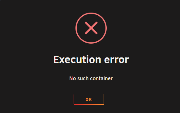

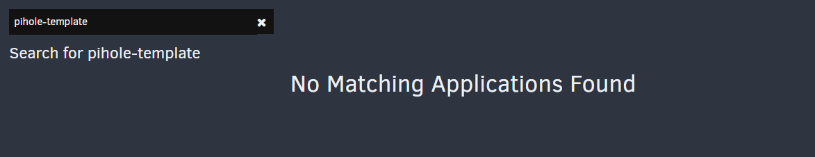

  14. This gives me hits, but the one I have installed is missing, that is why am I wondering has the one I posted been pulled and replaced with the official one?
  15. Has this container been pulled?
