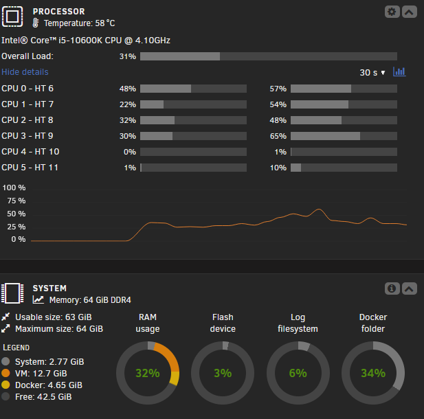

  6. I gave the server a reboot and ran a memtest, it passed. The CPU usage looks a lot healthier after rebooting. I hope I'm not going to need to reboot unraid weekly to prevent this issue.

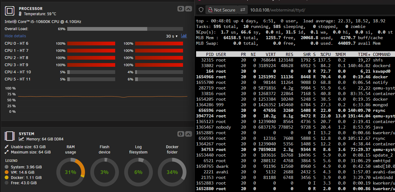

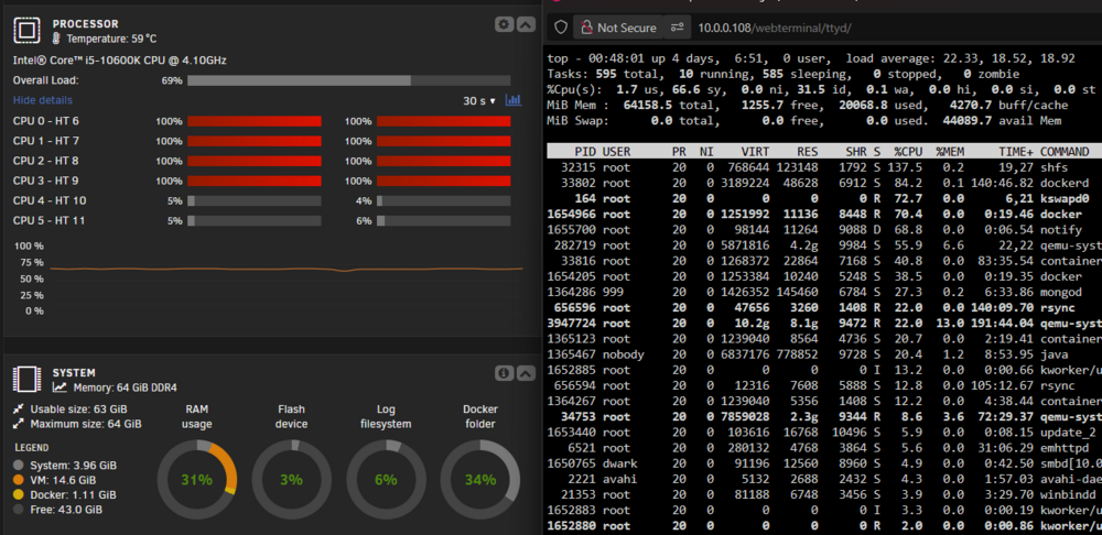

  7. Still not sure what is hitting the cpu so hard. I've double checked the CPU pinning to make sure all dockers are pinned correctly to free up CPU 0 & 1. It's taking minutes to load and check these details so its pretty painful. I stopped my unifi network docker (I have a feeling just stopping any docker would have ben fine) and the cpu usage is no longer stuck at 100%, everything is responsive again. The CPU usage still seems to be spiking unusally high on all (non-isolated) cores though and I have a feeling over time it will return to 100% again. I noticed that loading into plex spikes all cores to 100% and shfs shows high cpu usage in the terminal.

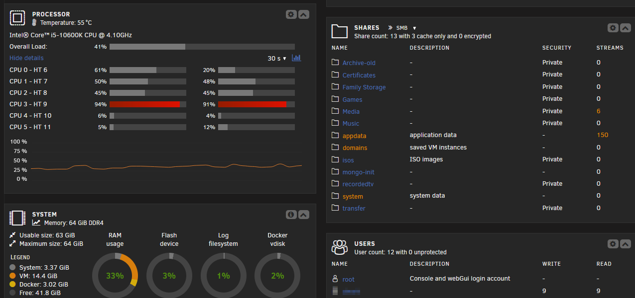

  8. I turned off folder caching and it had no impact. I looked to my dockers and stopped my unifi network docker and the CPU usage went back to normal. I realised I hadn't set up pinning on that docker, so that's configured now. I'm going to continue to monitor but anything CPU intensive is destroying unraid, ive never noticed this before.

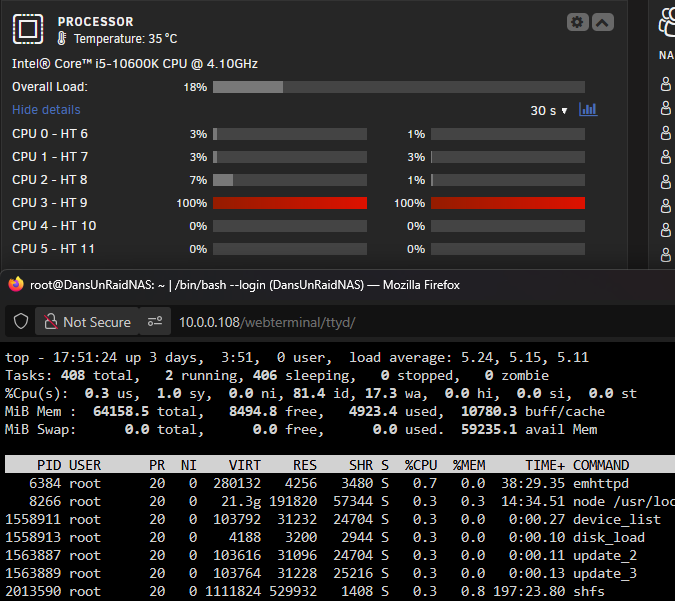

  9. Happened to be sat on the main tab when the issue started again. shfs is using a lot of cpu, apparently it can be related to the folder caching plugin which I was messing around with yesterday. High CPU usage can happen during TRIM too and I was scheduling TRIM weekly, I get this issue with unraid weekly usually... I have a lot of SSDs / Nvmes, I wonder if its related. The CPU load is so high that it is making unraid & the array completely unusable.

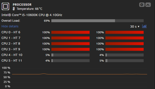

  12. The array wont stop. Has been stuck for an hour... Not having a lot of joy. Something is maxing out two of the cores, not sure wtf is going on. Dockers & VMs aren't even running atm. I've tried to init a reboot or shutdown with no success either. Apr 17 14:20:13 DansUnRaidNAS unassigned.devices: Unmounting Remote SMB/NFS Share '//10.0.0.104/media'... Apr 17 14:20:13 DansUnRaidNAS unassigned.devices: Unmount cmd: /sbin/umount -t cifs -l '/mnt/remotes/QnapUnraid_media' 2>&1 Apr 17 14:22:34 DansUnRaidNAS nginx: 2025/04/17 14:22:34 [error] 15976#15976: *1132710 upstream timed out (110: Connection timed out) while reading upstream, client: 10.0.0.21, server: , request: "POST /update.htm HTTP/1.1", upstream: "http://unix:/var/run/emhttpd.socket:/update.htm", host: "10.0.0.108", referrer: "http://10.0.0.108/Main" Apr 17 14:28:43 DansUnRaidNAS shutdown[95945]: shutting down for system reboot Apr 17 14:28:59 DansUnRaidNAS shutdown[96715]: shutting down for system reboot Apr 17 14:31:39 DansUnRaidNAS shutdown[104472]: shutting down for system halt Apr 17 14:35:27 DansUnRaidNAS ool www[95743]: /usr/local/emhttp/plugins/dynamix/scripts/emcmd 'cmdStatus=Apply' Apr 17 14:36:48 DansUnRaidNAS monitor_nchan: Stop running nchan processes Apr 17 14:43:16 DansUnRaidNAS flash_backup: adding task: /usr/local/emhttp/plugins/dynamix.my.servers/scripts/UpdateFlashBackup update Apr 17 15:00:03 DansUnRaidNAS emhttpd: spinning down /dev/sdg Apr 17 15:05:02 DansUnRaidNAS emhttpd: read SMART /dev/sdg Apr 17 15:11:41 DansUnRaidNAS emhttpd: spinning down /dev/sdl Apr 17 15:11:43 DansUnRaidNAS emhttpd: spinning down /dev/sdm Apr 17 15:19:36 DansUnRaidNAS emhttpd: spinning down /dev/sdd Apr 17 15:19:36 DansUnRaidNAS emhttpd: spinning down /dev/sdt Apr 17 15:19:36 DansUnRaidNAS emhttpd: spinning down /dev/sde Apr 17 15:19:36 DansUnRaidNAS emhttpd: spinning down /dev/sdb Apr 17 15:19:36 DansUnRaidNAS emhttpd: spinning down /dev/sdr Apr 17 15:19:36 DansUnRaidNAS emhttpd: spinning down /dev/sdf Apr 17 15:19:36 DansUnRaidNAS emhttpd: spinning down /dev/sdv Apr 17 15:19:36 DansUnRaidNAS emhttpd: spinning down /dev/sdc Apr 17 15:19:36 DansUnRaidNAS emhttpd: spinning down /dev/sds Apr 17 15:19:36 DansUnRaidNAS emhttpd: spinning down /dev/sdn Apr 17 15:19:36 DansUnRaidNAS emhttpd: spinning down /dev/sdo Apr 17 15:20:10 DansUnRaidNAS emhttpd: spinning down /dev/nvme1n1 Apr 17 15:20:10 DansUnRaidNAS emhttpd: sdspin /dev/nvme1n1 down: 25 Apr 17 15:20:12 DansUnRaidNAS emhttpd: spinning down /dev/sdh Apr 17 15:20:13 DansUnRaidNAS emhttpd: spinning down /dev/sdi Apr 17 15:20:14 DansUnRaidNAS emhttpd: spinning down /dev/sdj Apr 17 15:25:02 DansUnRaidNAS emhttpd: read SMART /dev/sdh Apr 17 15:25:02 DansUnRaidNAS emhttpd: read SMART /dev/sdi Apr 17 16:05:04 DansUnRaidNAS emhttpd: spinning down /dev/sdg Apr 17 16:10:02 DansUnRaidNAS emhttpd: read SMART /dev/sdg dansunraidnas-diagnostics-20250417-1622.zip
  13. I stopped the plex docker and everything is back to normal. Need to investigate further.
