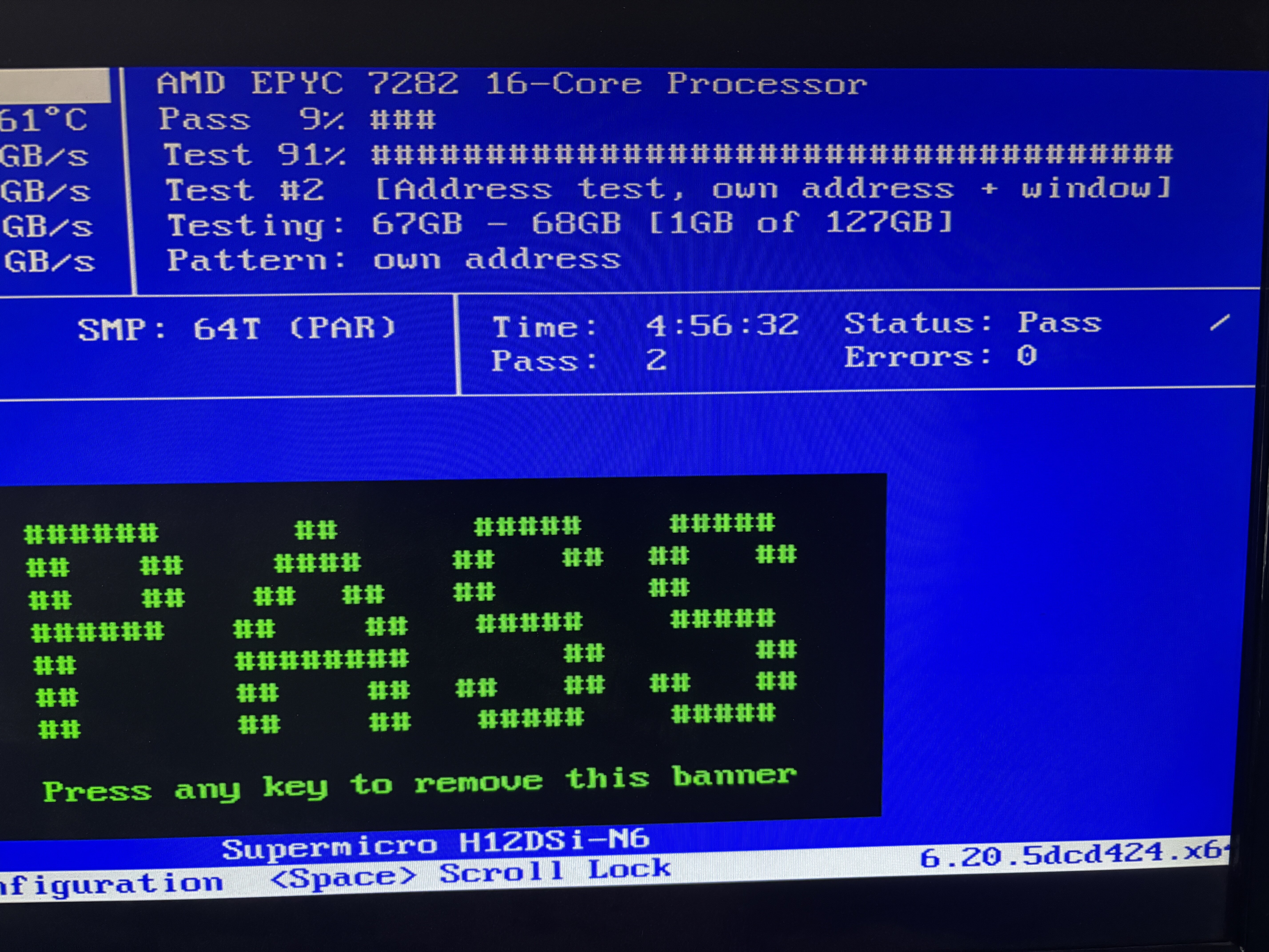

  5. I have been fighting this error for the past couple of days and have made no headway in fixing it. I have repaired (removed the -n) through the graphical interface. I cannot do a repair in console because the drive is encrypted. I ran memory test and let it do two runs and no errors were found. Any further suggestions would be appreciated. Sep 20 17:02:32 KenServer kernel: XFS (dm-7): Unmount and run xfs_repair Sep 20 17:02:32 KenServer kernel: XFS (dm-7): First 128 bytes of corrupted metadata buffer: Sep 20 17:02:32 KenServer kernel: 00000000: 49 4e 41 ff 03 01 00 00 00 00 00 63 00 00 00 64 INA........c...d Sep 20 17:02:32 KenServer kernel: 00000010: 00 00 00 03 00 00 00 00 00 00 00 00 00 00 00 00 ................ Sep 20 17:02:32 KenServer kernel: 00000020: 63 d7 b3 b1 00 00 00 00 62 fd 73 ac 00 00 00 00 c.......b.s..... Sep 20 17:02:32 KenServer kernel: 00000030: 64 08 0e 8a 35 c0 69 0e 00 00 00 00 00 00 00 2c d...5.i........, Sep 20 17:02:32 KenServer kernel: 00000040: 00 00 00 00 00 00 00 00 00 00 00 00 00 00 00 00 ................ Sep 20 17:02:32 KenServer kernel: 00000050: 00 00 00 02 00 00 00 00 00 00 00 00 d0 8e ae 0a ................ Sep 20 17:02:32 KenServer kernel: 00000060: ff ff ff ff b6 76 64 dd 00 00 00 00 00 00 00 09 .....vd......... Sep 20 17:02:32 KenServer kernel: 00000070: 00 00 00 12 00 22 fc 73 00 00 00 00 00 00 00 00 .....".s........ Sep 20 17:04:01 KenServer kernel: XFS (dm-7): Metadata corruption detected at xfs_dinode_verify+0xa0/0x732 [xfs], inode 0x2568a3da2 dinode kenserver-diagnostics-20240920-1910.zip
  6. Thanks for the quick reply. I will give that a shot and see what happens.

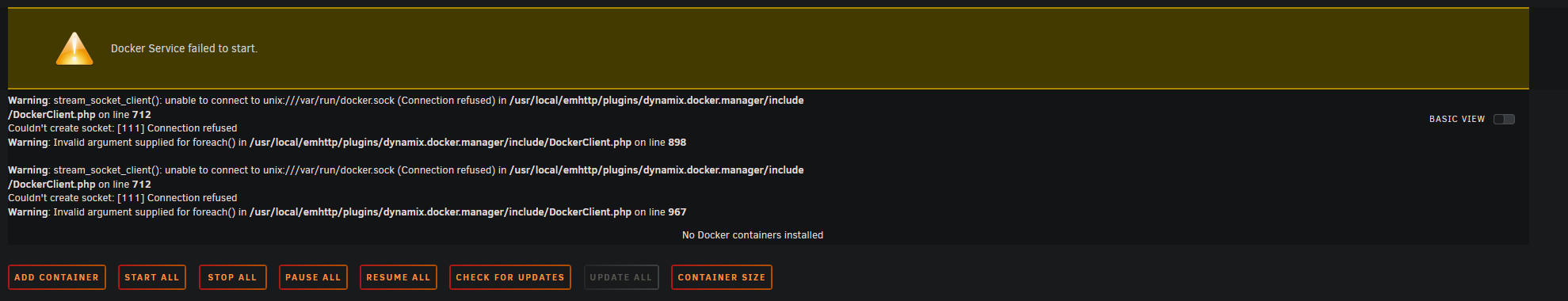

  7. I have been trying to chase down for the past few weeks what is going on with docker. I have tried removing the docker image, increasing the image size, and only starting essential containers that I needed. After anywhere from a day to several days, I will get the following error on the docker page and when I had a VM running, it would stop that too. After this last reboot, the dockers started right up but the server has stated another parity check. Not sure if that is I have also formatted my cache drives this last time with no luck. Any assistance would be greatly appreciated. kenserver-syslog-20230316-1116.zip kenserver-diagnostics-20230316-0611.zip
  8. That worked. I must have left that encrypted when I was trying to encrypt my disks. Thanks a lot for the help.

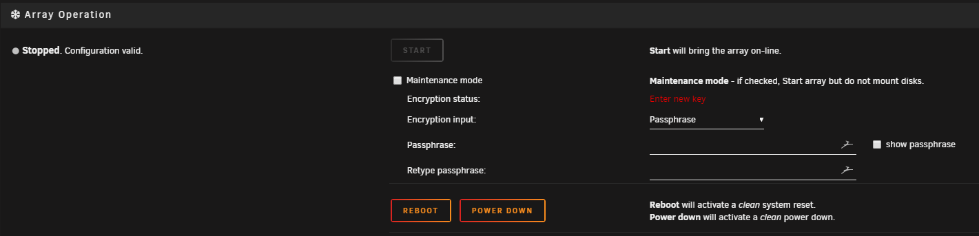

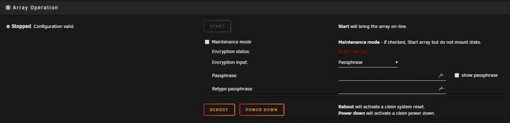

  10. I am trying to add some drives to my array and if I manually stop my array I can't restart it whether I add the drives or not. The only way I can get my array to start is if I reboot the system. I have attached a screenshot of what I am seeing. Thanks for the assistance.
