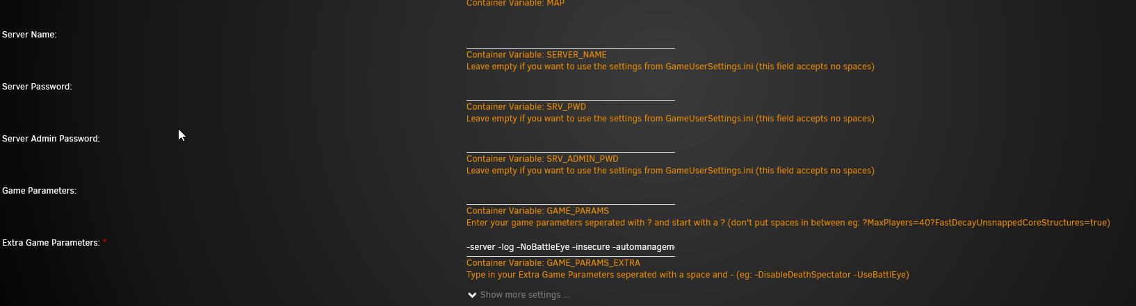

  2. Which is fine, but this is confusing since it's on both the server and admin password fields Leave empty if you want to use the settings from GameUserSetttings.ini Since you can't actually leave these two blank, if you want to set them, might be a good idea to update the template and remove that line.
  3. Yes. VALIDATE is empty. I restart after making any changes. To reiterate my findings: If I leave password, admin password, and do not pass maxplayers param, then the container is rebuilt (after changing config) or restarted, the password, adminpassword, and maxplayers values in GameUserSettings.ini are defaulted to blank and 70 respectively. So, what I have opted to do is set the passwords in the container config, and pass the MaxPlayers param in the container config, then leave server name and the rest of my configurations in GameUserSettings.ini and Game.ini and they do not appear to be overwritten on container restart. So, it's working now. Leaving the passwords values empty seemed to be the culprit. Set those in the container config and my .ini files are untouched.
  4. I'm talking about survival evolved. Setting the password and admin password via the container variables seems to prevent the overwrite. Adding the `?MaxPlayers` param under GAME PARAMS seems to prevent that from overwriting as well. SERVER_NAME is never touched, so I was able to leave that configured only in the .ini and the rest of the configuration appears to persist through restarts.
  5. Having the same issues as this user: And tried with validate set to true and left empty, per here: It seems that all [ServerSettings] are defaulted any time the container is restarted. Also, defaults MaxPlayers=70 under [/Script/Engine.GameSession] unless I specify the `?MaxPlayers=X` parameter. [MessageOfTheDay] and [SessionSettings], and the other sections appear untouched as my session name, duration, and message persist through container restarts. I've left the variables blank as I wanted to configure them in GameUserSettings.ini On Unraid 6.12.6 and using the latest from `ich777/steamcmd:arkse`

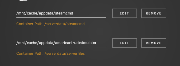

  13. appdata is set to "prefer cache" and the template shows `/mnt/user/appdata/...

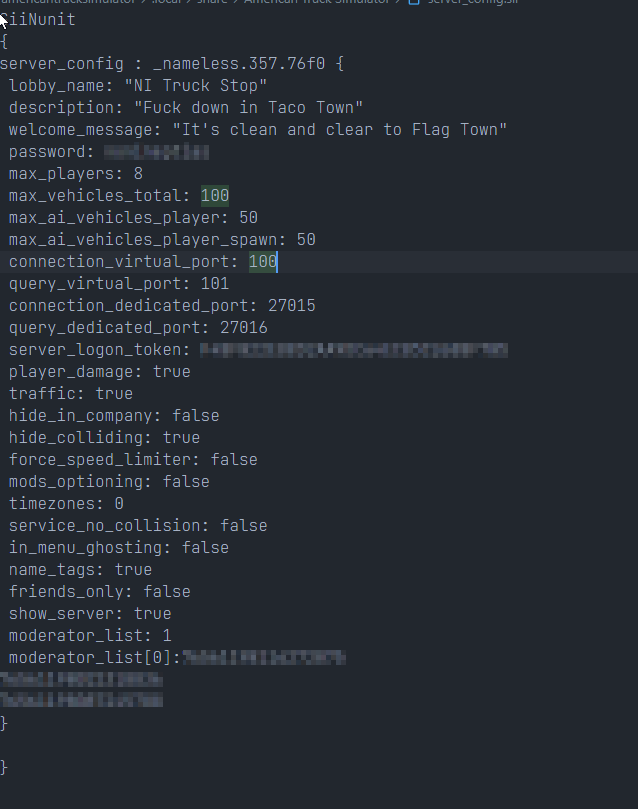

  16. Same issue. I left the password even defaulted to "docker" Opened the created config file and only changed the name and desc. Same issues.
  17. I tried it without any moderators set. I left all it all default and only changed name and desc.

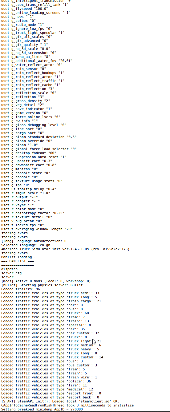

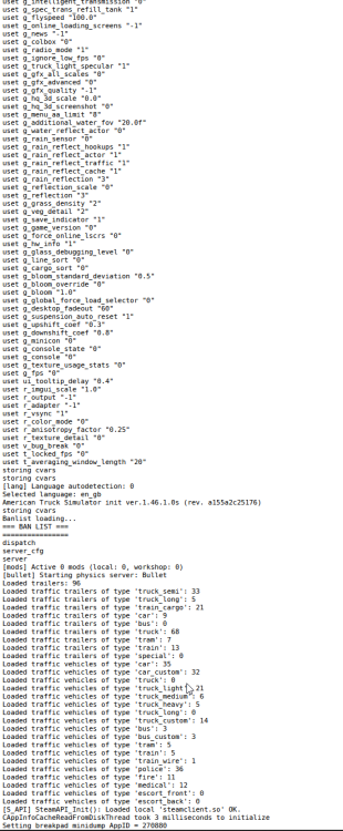

  20. Finally got around to updating my server to 6.11.5 and gave this another shot. Same issues as before, unfortunately. If I change anything in the config file it just stops at Setting breakpad minidump AppID = 270880 and the server does not appear in the convoy list when searching by the name I provided in the config.

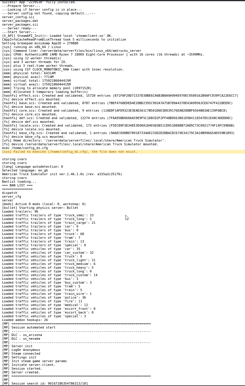

  23. Attaching screenshots. One is a clean install of the image and fresh start of the container. This is what it looks like at the end. Some [MP] info and a session search ID. I can then use that ID to search and find the server in the convoy list. If I go into `.local/share/American Truck Simulator` and edit the `server_config.ssi` where I'm changing the lobby name, description, welcome message, adding my steam token, and a mod list, when I restart, log looks way different and simply stops at `Setting breakpad minidump AppID = 270880` If this is normal, that's fine. Just curious as to why the server doesn't appear in the convoy list by name and after I make the changes and restart, I'm not given a Session ID at least, because I could at least find it by that before.
  24. But it is different if I make zero changes compared to after I make changes? Server doesn't appear in the convoy list and I don't have a session ID to search with, unlike if I just start the container the first time without making any changes
  25. Having an issue with American Truck Simulator. When I first download from Community apps and it runs, it works perfectly fine. Gets all the way to the `Session automated Start` panel with some info and the session search ID. If I try to edit the server_config.sii in any way (change title, description, welcome message, or include my login token string) when it restarts it simply just gets stuck at "Setting breakpad minidump AppID = 270880" and never gets passed that. I even just tried to change one of those options at a time, starting with the title. Restart the container, same issue.
