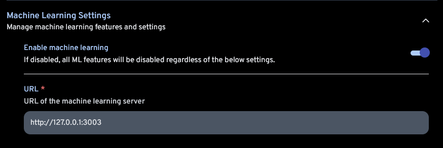

Immich docker self-hosted google photos setup
Hi Foo_fighter, 0.0.0.0 works because the system is "listening" on any available network interface for the machine learning processes. You could also simply set it to localhost (127.0.0.1) and it would work as well, since you have those processes running in your docker container along with Immich. It won't work with "immich-machine-learning" unless you have a server with a DNS record for that name, and the necessary machine learning processes active on that server. best, JP

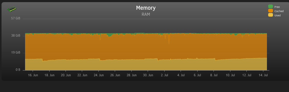

Out Of Memory errors help
I am having a similar "intermittent" issue. I'm not seeing any problems with the server, just the warning from "Fix Common Problems" plugin. When I first noticed it last year, I tried to upgrade my RAM to 48GB, but that didn't help. My Ram usage seems within reason, and cache fully utilizing the available RAM. I can tell from my sys logs that the "used" dips, are not related to my OOM-reaper killing any tasks. It seems to me that the cache isn't being culled properly or is being over-utilized, not leaving space for system usage when a demand comes. Is there a way to modify how much "free" RAM remains, rather than utilizing it for "cache"? Wish I could be more help, Velourfogg. But maybe we can get a discussion started here? JP

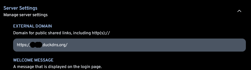

I am having an issue connecting the android app to my immich server via reverse proxy. The reverse proxy works fine with a browser on the same phone, but the app log states "invalid SSL cert" and "Error while checking server availability", in that order. In my digging around I've seen references to websockets and intermediate certificate relays. I'm not ashamed to say that is over my head. I truly don't think there is anything out of the ordinary for my configuration, so maybe just another set of eyes will see what I am doing wrong? any help would be appreciated! immich.subdomain.conf, SWAG file: ## Version 2024/03/28 # make sure that your immich container is named immich # make sure that your dns has a cname set for immich # immich v1.88+ only server { listen 443 ssl http2; #listen [::]:443 ssl http2; server_name [redacted].*; include /config/nginx/ssl.conf; client_max_body_size 0; # enable for ldap auth (requires ldap-location.conf in the location block) #include /config/nginx/ldap-server.conf; # enable for Authelia (requires authelia-location.conf in the location block) #include /config/nginx/authelia-server.conf; # enable for Authentik (requires authentik-location.conf in the location block) #include /config/nginx/authentik-server.conf; location / { # enable the next two lines for http auth #auth_basic "Restricted"; #auth_basic_user_file /config/nginx/.htpasswd; # enable for ldap auth (requires ldap-server.conf in the server block) #include /config/nginx/ldap-location.conf; # enable for Authelia (requires authelia-server.conf in the server block) #include /config/nginx/authelia-location.conf; # enable for Authentik (requires authentik-server.conf in the server block) #include /config/nginx/authentik-location.conf; include /config/nginx/proxy.conf; include /config/nginx/resolver.conf; set $upstream_app immich; set $upstream_port 8080; set $upstream_proto http; proxy_pass $upstream_proto://$upstream_app:$upstream_port; } location ~ (/immich)?/api { include /config/nginx/proxy.conf; include /config/nginx/resolver.conf; set $upstream_app immich; set $upstream_port 8080; set $upstream_proto http; proxy_pass $upstream_proto://$upstream_app:$upstream_port; } }
