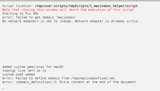

  5. Having problems with the helper script. I have tried a couple of times starting fresh but still have issue. I tried changing the vm name in my script as per the docker name but still get the error below. I am sure it is something stupid:) Any help appreciated. Thanks
