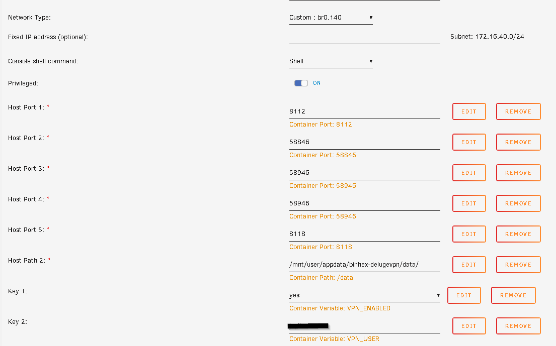

Thanks for the response. Yes, I have a pfsense router with a Unifi switch. pfSense sees these VLANS and I use these within the network currently. Unifi also sees these with no issues. As you can see from the Screen Shot, I have it set the way you stated above, however I am unable to assign an IP from the other VLANs to the Docker Container for use. (NOTE: Doing it this way does not cause the SSH to drop. Meaning just doing NONE). I would like to be able to assign my DOCKER App an IP on the VLAN 130 which is 192.168.30.x or the 140 192.168.40.x.
While I am green to Unraid, I am trying to add a VLAN to an interface as I have 3 VLANS which I would like to use for Apps. Presently my Unraid Server has 4 NICs, I have tried several different options to get this to work with ZERO success. I have read several of the posts trying to get this to work but every time I add a VLAN to a specific interface, my SSH session to the Unraid host dies after 30 seconds. If I remove the VLANs all works as expected with the exception I am unable to assign a Specific ip within one of the VLANs I would like to use. I am going crazy trying to figure this out and what could be the cause. NIC 1 = IP for Management of Unraid (eth0) NIC2 = IP for VLANs (eth1) - NOTE: No VLAN Tags setup yet on this interface NIC3 / NIC4 = (BOND) for 802.3 LAG (LAG setup on the Switch) SSH to the host, run a pin test - Pings as normal does not break NIC2 = Add VLAN, Either statically assign an ip or let it pull from DHCP. SSH back to the host, run a ping test - Pings for 30 seconds then SSH closes Reopen SSH back to the host, re-run the ping, same results. Remove the VLAN from the interface, SSH works as Normal. Anyone have any Suggestions because I am going nuts here. Does not make sense.

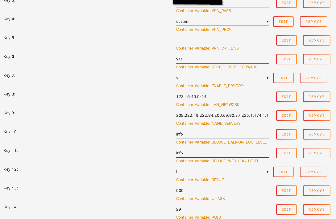

Thanks for the information, I did change the LAN as noted below, however that did not seem to change the issue which I am still seeing. Still unable to open the WebUI and also showing the events in the log. Am I missing something? 2020-01-20 10:29:18,548 DEBG 'start-script' stderr output: Error: error sending query: Could not send or receive, because of network error 2020-01-20 10:31:23,664 DEBG 'start-script' stderr output: Error: error sending query: Could not send or receive, because of network error 2020-01-20 10:33:28,787 DEBG 'start-script' stderr output: Error: error sending query: Could not send or receive, because of network error
Currently I am new to the unraid binhex-delugevpn and started to setup the configuration. I am however having a hard time with getting this to work. I however may be not setting this up correctly. One of my core requirements which I need to have is a custom VLAN configuration. I have setup Unraid to have VLAN support enabled along with adding the specific VLAN. I am also using a different OpenVPN configuration than AirVPN or PIA. The error I am getting is that the GUI will not connect. I have checked the configuration along with the Logs and I do see that Error in the log calling Error Sending Query: Could not send or receive, because of network error. Any help would be great. ___. .__ .__ \_ |__ |__| ____ | |__ ____ ___ ___ | __ \| |/ \| | \_/ __ \\ \/ / | \_\ \ | | \ Y \ ___/ > < |___ /__|___| /___| /\___ >__/\_ \ \/ \/ \/ \/ \/ https://hub.docker.com/u/binhex/ 2020-01-20 09:14:21.329401 [info] System information Linux 5a18ce5e2b16 4.19.94-Unraid #1 SMP Thu Jan 9 08:20:36 PST 2020 x86_64 GNU/Linux 2020-01-20 09:14:21.385468 [info] PUID defined as '99' 2020-01-20 09:14:21.445080 [info] PGID defined as '100' 2020-01-20 09:14:22.467884 [info] UMASK defined as '000' 2020-01-20 09:14:22.523812 [info] Permissions already set for volume mappings 2020-01-20 09:14:22.586296 [info] DELUGE_DAEMON_LOG_LEVEL defined as 'info' 2020-01-20 09:14:22.648026 [info] DELUGE_WEB_LOG_LEVEL defined as 'info' 2020-01-20 09:14:22.703476 [info] VPN_ENABLED defined as 'yes' 2020-01-20 09:14:22.777663 [info] OpenVPN config file (ovpn extension) is located at /config/openvpn/custom.ovpn 2020-01-20 09:14:22.883726 [info] VPN remote line defined as 'xxxxsitename portxxxx' 2020-01-20 09:14:22.940044 [info] VPN_REMOTE defined as 'xxxxsitenamexxxx' 2020-01-20 09:14:22.995681 [info] VPN_PORT defined as '1194' 2020-01-20 09:14:23.063316 [info] VPN_PROTOCOL defined as 'udp' 2020-01-20 09:14:23.121373 [info] VPN_DEVICE_TYPE defined as 'tun0' 2020-01-20 09:14:23.178801 [info] VPN_PROV defined as 'custom' 2020-01-20 09:14:23.235258 [info] LAN_NETWORK defined as '172.16.40.0/24' 2020-01-20 09:14:23.290911 [info] NAME_SERVERS defined as '209.222.18.222,84.200.69.80,37.235.1.174,1.1.1.1,209.222.18.218,37.235.1.177,84.200.70.40,1.0.0.1' 2020-01-20 09:14:23.351944 [info] VPN_USER defined as 'xxxxusernamexxxx' 2020-01-20 09:14:23.407993 [info] VPN_PASS defined as 'xxxxuserpasswordxxxx' 2020-01-20 09:14:23.466256 [info] VPN_OPTIONS not defined (via -e VPN_OPTIONS) 2020-01-20 09:14:23.523009 [info] ENABLE_PRIVOXY defined as 'yes' 2020-01-20 09:14:23.584489 [info] Deleting files in /tmp (non recursive)... 2020-01-20 09:14:23.637068 [info] Starting Supervisor... 2020-01-20 09:14:23,979 INFO Included extra file "/etc/supervisor/conf.d/delugevpn.conf" during parsing 2020-01-20 09:14:23,979 INFO Set uid to user 0 succeeded 2020-01-20 09:14:23,985 INFO supervisord started with pid 6 2020-01-20 09:14:24,988 INFO spawned: 'start-script' with pid 156 2020-01-20 09:14:24,991 INFO spawned: 'watchdog-script' with pid 157 2020-01-20 09:14:24,992 INFO reaped unknown pid 7 2020-01-20 09:14:25,003 DEBG 'start-script' stdout output: [info] VPN is enabled, beginning configuration of VPN 2020-01-20 09:14:25,004 INFO success: start-script entered RUNNING state, process has stayed up for > than 0 seconds (startsecs) 2020-01-20 09:14:25,004 INFO success: watchdog-script entered RUNNING state, process has stayed up for > than 0 seconds (startsecs) 2020-01-20 09:14:25,143 DEBG 'start-script' stdout output: [info] Default route for container is 172.16.40.1 2020-01-20 09:14:25,149 DEBG 'start-script' stdout output: [info] Adding 209.222.18.222 to /etc/resolv.conf 2020-01-20 09:14:25,155 DEBG 'start-script' stdout output: [info] Adding 84.200.69.80 to /etc/resolv.conf 2020-01-20 09:14:25,161 DEBG 'start-script' stdout output: [info] Adding 37.235.1.174 to /etc/resolv.conf 2020-01-20 09:14:25,166 DEBG 'start-script' stdout output: [info] Adding 1.1.1.1 to /etc/resolv.conf 2020-01-20 09:14:25,173 DEBG 'start-script' stdout output: [info] Adding 209.222.18.218 to /etc/resolv.conf 2020-01-20 09:14:25,179 DEBG 'start-script' stdout output: [info] Adding 37.235.1.177 to /etc/resolv.conf 2020-01-20 09:14:25,184 DEBG 'start-script' stdout output: [info] Adding 84.200.70.40 to /etc/resolv.conf 2020-01-20 09:14:25,189 DEBG 'start-script' stdout output: [info] Adding 1.0.0.1 to /etc/resolv.conf 2020-01-20 09:16:25,309 DEBG 'start-script' stderr output: Error: error sending query: Could not send or receive, because of network error
