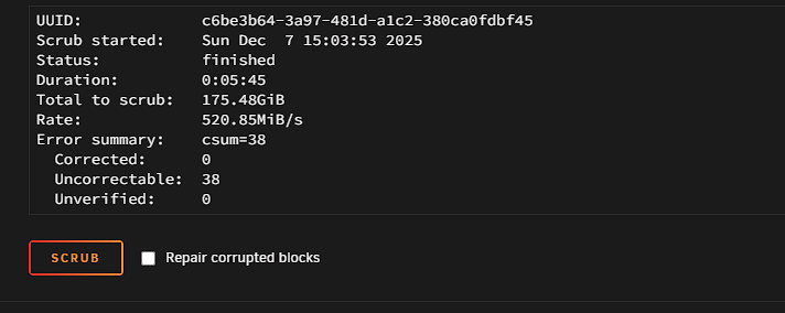

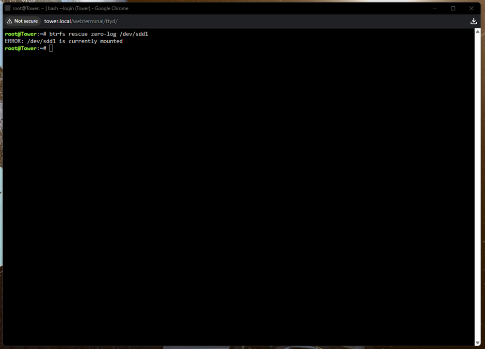

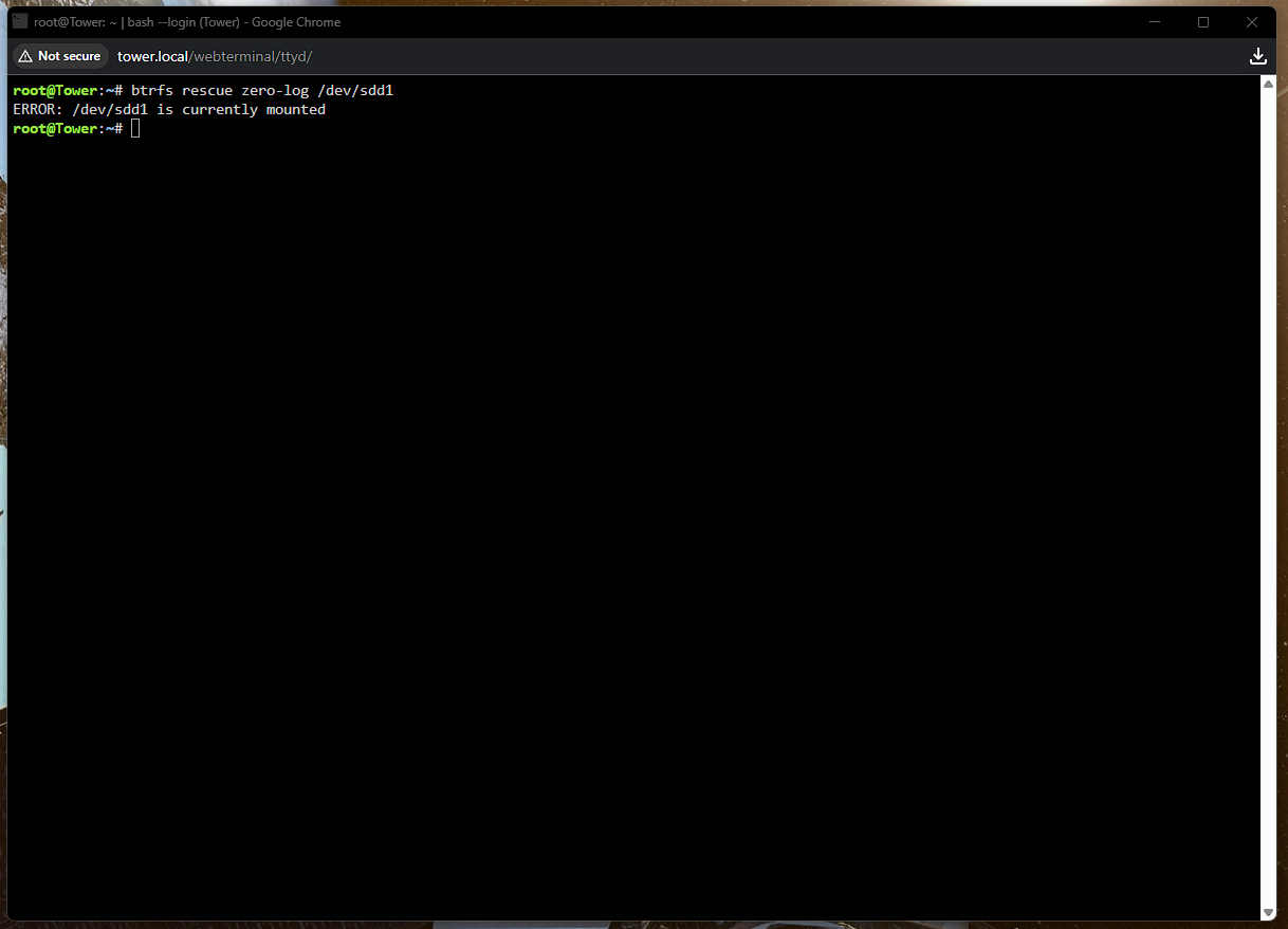

  3. ran umount /dev/sdd1 then btrfs rescue zero-log /dev/sdd1 The drive seems fine after restarting array

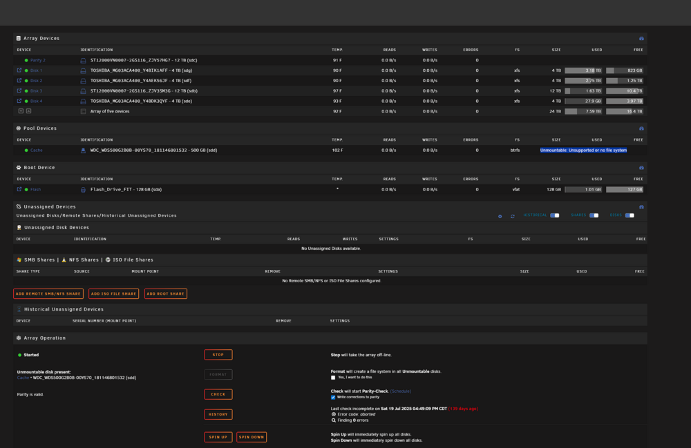

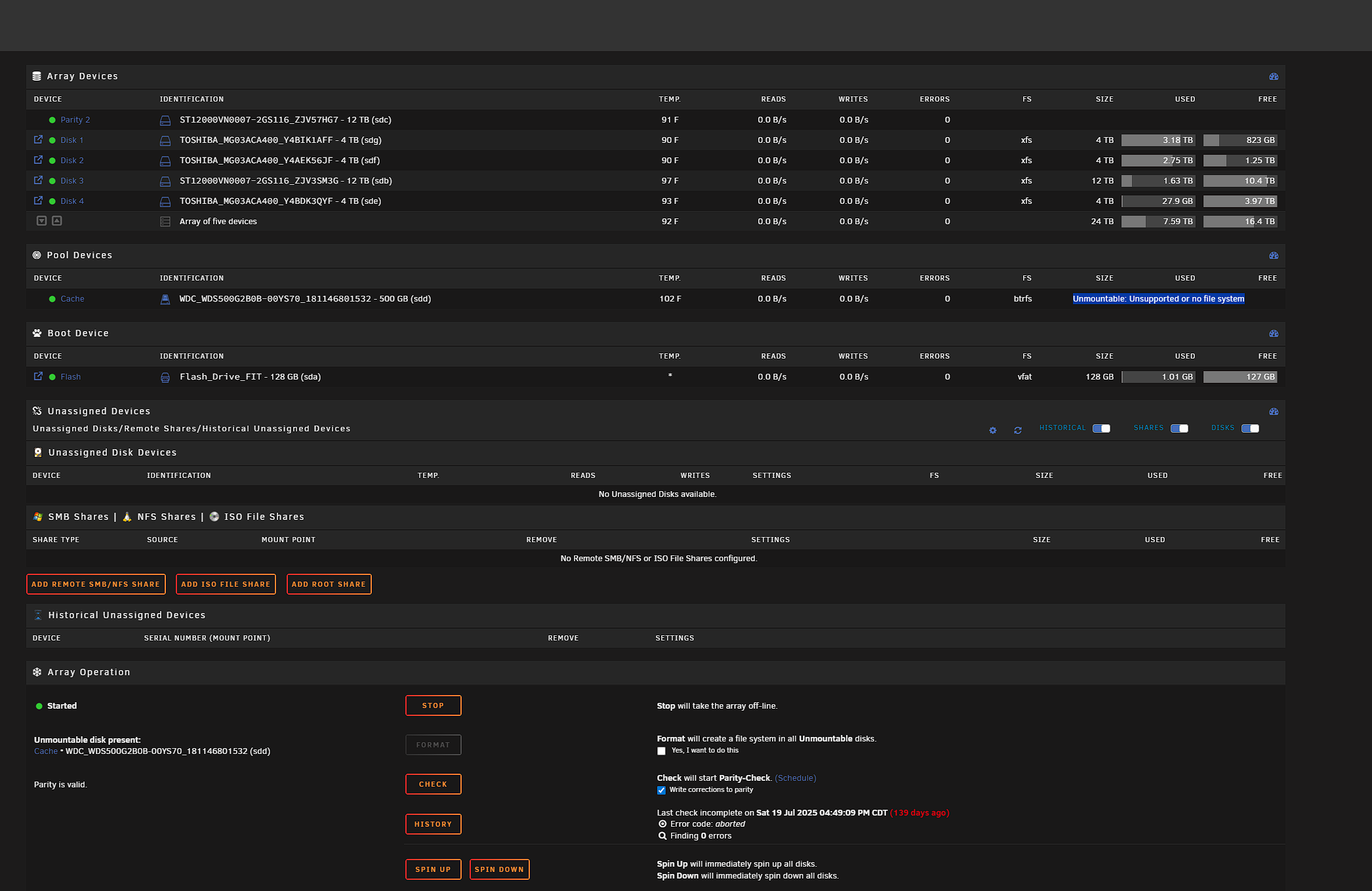

  5. Restarted my server via the webgui, appon restart is says my cache drive as unmountable. Any assistance would be appreciated.
