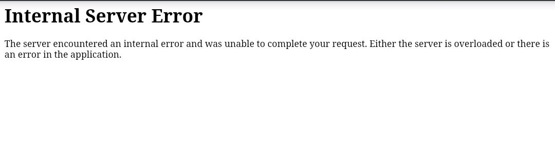

  6. Getting this error when I select the pools tab with the latest (just updated) test branch
