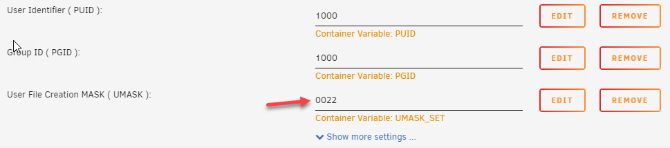

  11. I'm curious, why have this limitation/restriction? I ran into the same permissions issue but I don't see this behavior in similar dockers (nzbget, syncthing, etc) that create and access files on my public shares. Edit: Changing the UMASK to 0022 fixes this permission issue. The project as outlined on github uses 022 as the default, but for some reason my docker was set to 044 which was too restrictive for my use case.
