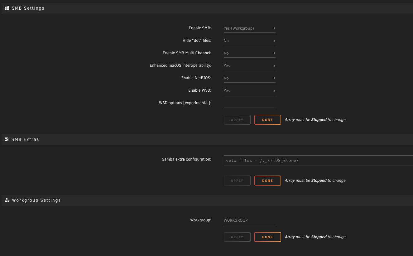

unable to transfer files from MacOS to Unraid Share on SMB
Dear JorgeB, I was looking around at the shares and I saw that the permissions were wrong. made adjustments and it seems to be working again. I created the share with ZFSmaster so i believe the permissions were not input properly. If i find any other issues will ask again. Thanks for the help!
i have been having issues setting up my server. I have previously setup a server with similar SMB share settings and there wasnt any issues On my new server when i am trying to setup a new SMB share i cant seem to transfer into it. I am able to view the folder but when i try and move a file it brings up an error Below are my SMB settings for that share. I have similar problems with other shares This is my general SMB share settings Is there some setting that i am missing? Thanks in advance!
