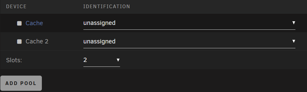

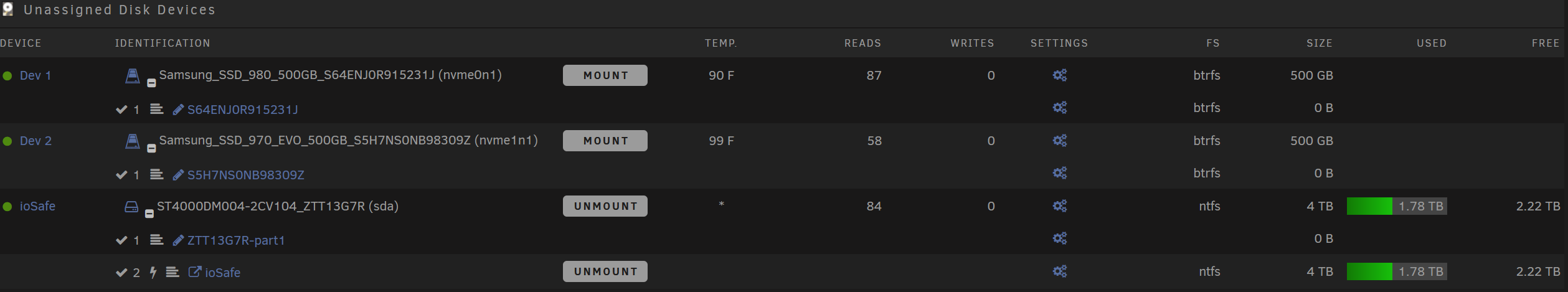

I upgraded from 6.9.2 to 6.11.5 last week. The only things that have changed are I installed the My Servers plugin and uninstalled plugins that are no longer supported. (CA Backup v2 and the Nerd Pack) Then installed CA Backup v3 (Kluth version) Since then I have been getting notifications multiple times a day that Cache 2 is at 183 degrees. ( I have no clue as to why...) Then about 20-30 mins. later it goes back to normal. This is not normal behavior for my server. Very rarely would I ever get a notification the either of my cache drives are hot. Cache 2 has a heat sink and there is a fan that blows across both Cache drive 1 and 2. Any ideas? Thanks! unraid-diagnostics-20230108-0812.zip
