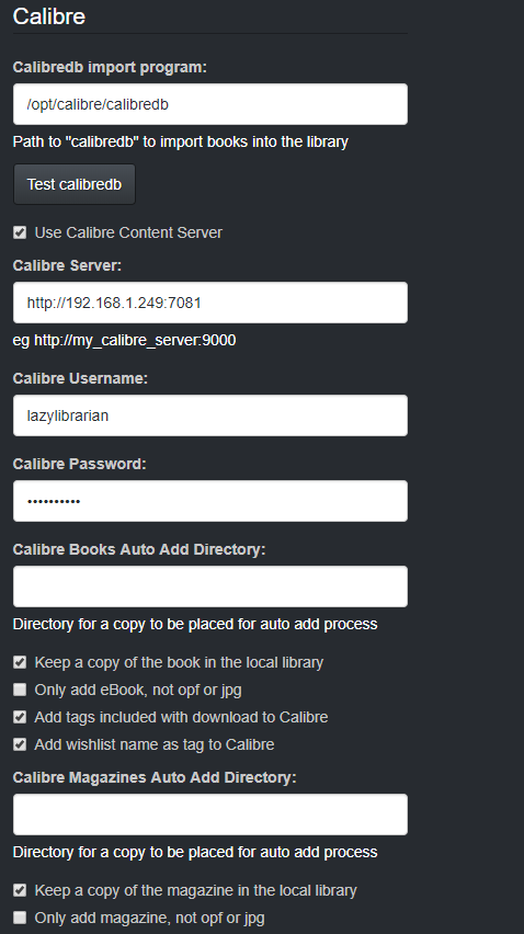

  2. @fuzzewuzze LL operates in two modes. 1. LL creates and manages the library 2. LL works in conjunction with Calibre and looks at a Calibre library This docker presumes the second case. To solve your issue. 1. Empty your /books/Calibre directory completely 2. Use the windows app to Switch / Create library select that folder and create a new library so it will generate a metadata.db file for calibredb in the docker to access As you evidently did create a metadata.db using the terminal with "/opt/calibre/calibredb add /books/Calibre/* --library_path books/Calibre/ -r " any books downloaded after that point should import using calibredb correctly in the future. IF you have your LL config set to use "/opt/calibre/calibredb" as the calibre import program.

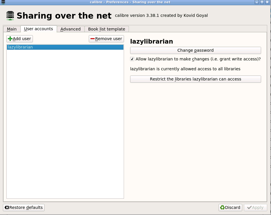

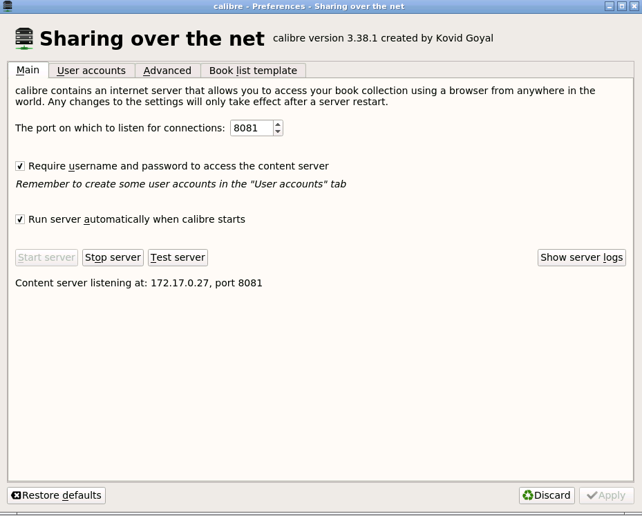

  3. To use the Content Server with RDP-Calibre goto preferences -> Sharing overt the net. enable "Requre username and password" and "Run server automatically" then "Start Server" Create a user and make sure they have write access Check your Docker Settings to see what IP and port you used for the :8081 port mapping. Goto Lazy Librarian and setup the Calibre Settings to use the Content Server. Now when Lazy Librarian processes a book it will use the RDP-Calibre to do so, which will automatically update the book list to include the new book.
  4. The issue you have described is expected behavior. Calibre (ie RDP-Calibre) loads calibre library database when it starts and does NOT monitor for changes made by other Calibre instances (LL-Calibre) that directly access the Calibre Library. To do what you would like you would need to setup Calibre as a Content Server and use the remote server options to add books. This is not something I have tried to setup and use yet as my workflow does not rely on RDP-Calibre, I do all my metadata updates using a desktop client that I only run at the time I wish to do metadata updates.

  6. The lazylibrarian-calibre docker has been updated Please note that the Calibredb import program should always be set to: /opt/calibre/calibredb in the config as noted in the settings image at the start of this thread.
