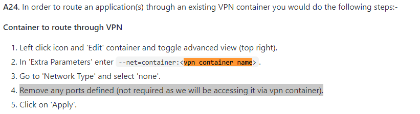

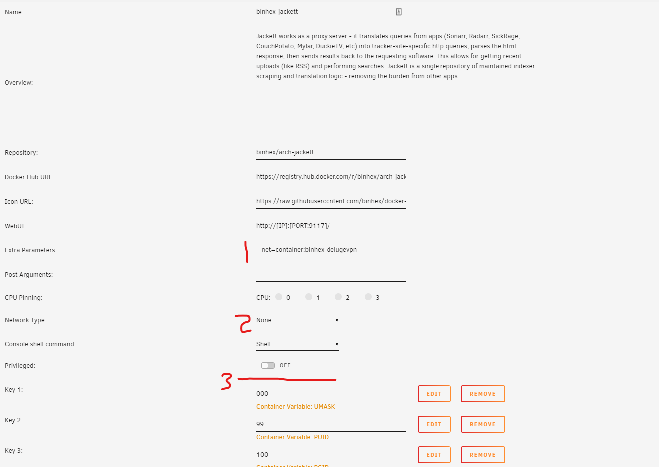

  5. So I tried that earlier, but I tried again just to confirm. There's the start of Q24 from the FAQ... Here's what I changed my Jackett container to: Added the extra parameter as dictated. I assume "binhex-delugevpn" is the VPN container name? If not, I don't know what is. Switched Network type to none Removed what used to be the first environment variable. It was the port setting, which was previously 9117. Unfortunately, this results in a failed Docker restart. "The command failed." And then my docker page shows an orphan image where binhex-jackett used to be. So something isn't right. Thanks for the help so far. I'm eager to go down the path of binding Jackett to the VPN container. However, it seems awfully strange that Jackett literally has a setting for this (which would allow me to tell Jackett to just use privoxy), and we're unable to do that anymore...
