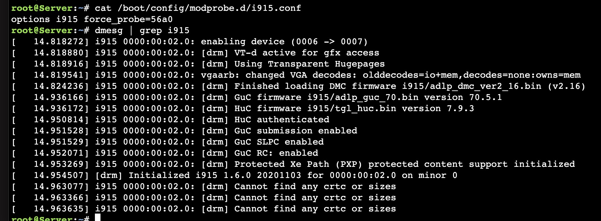

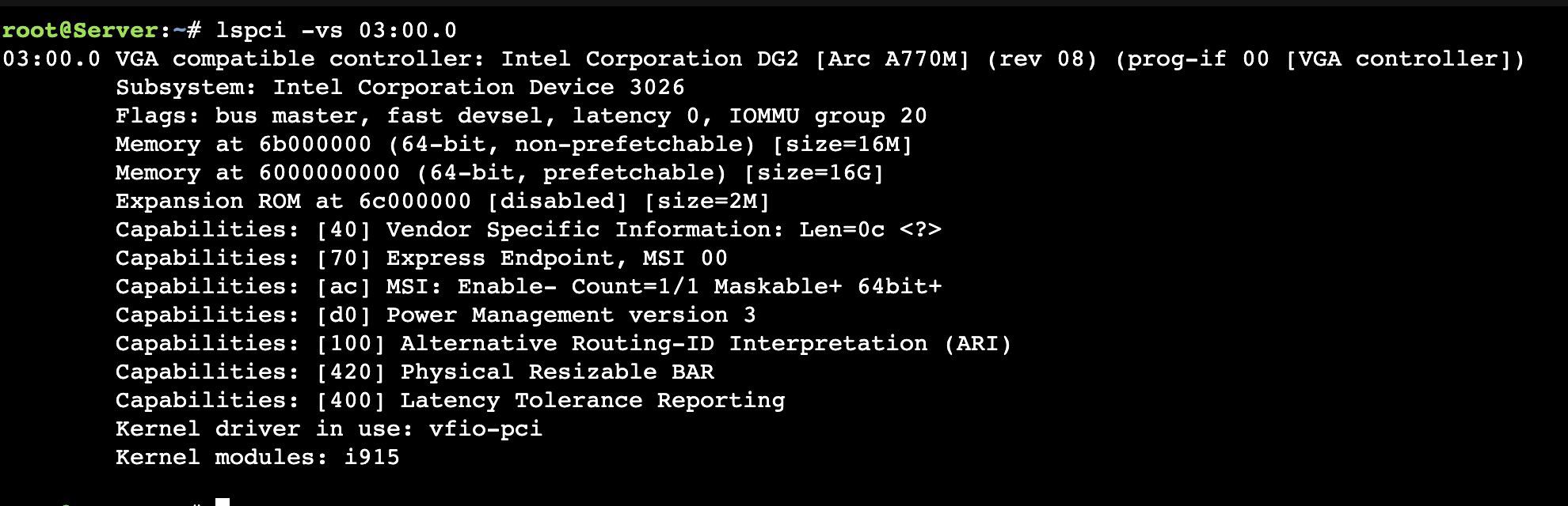

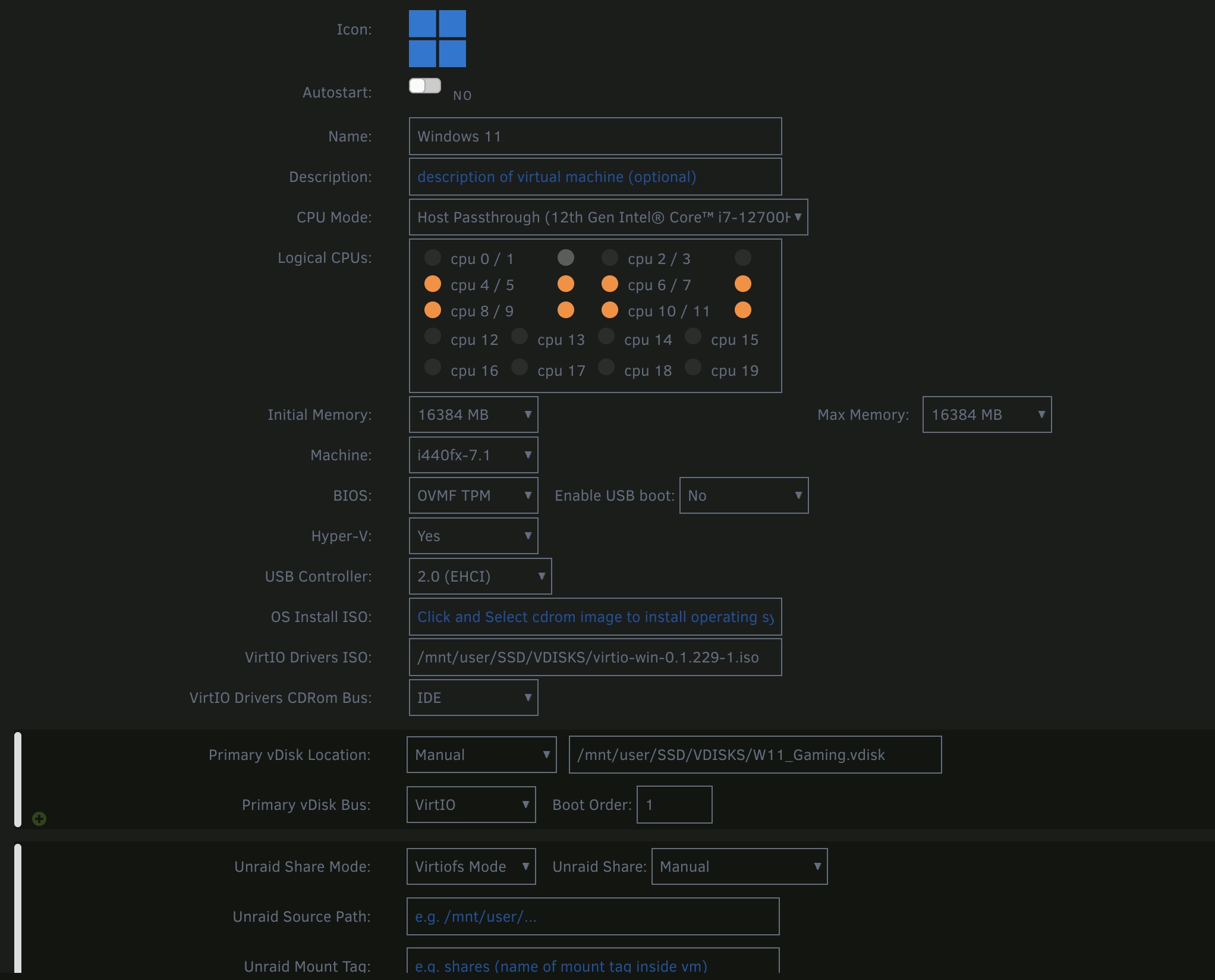

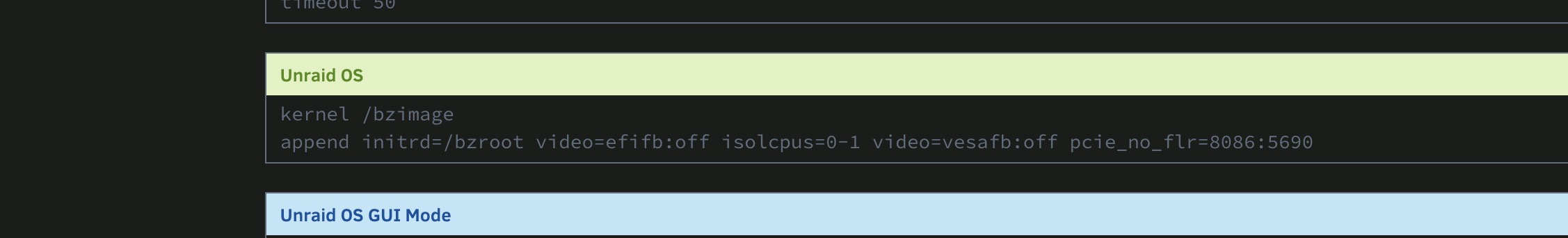

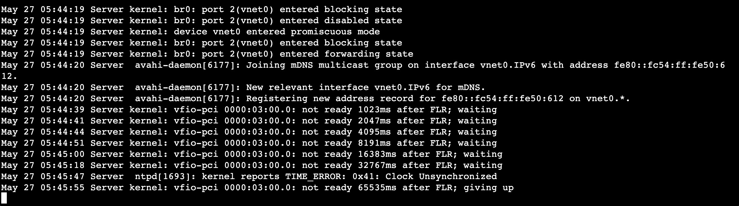

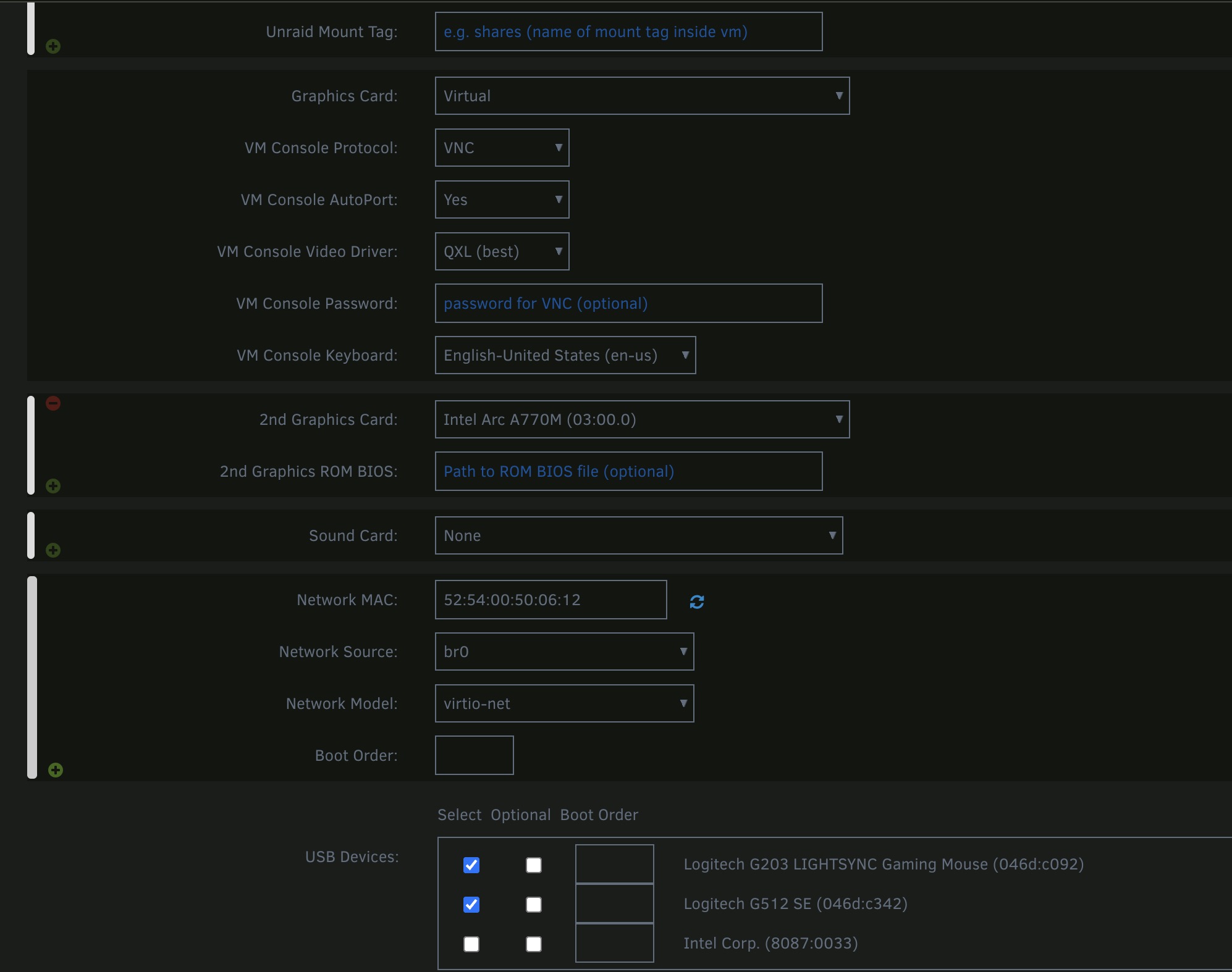

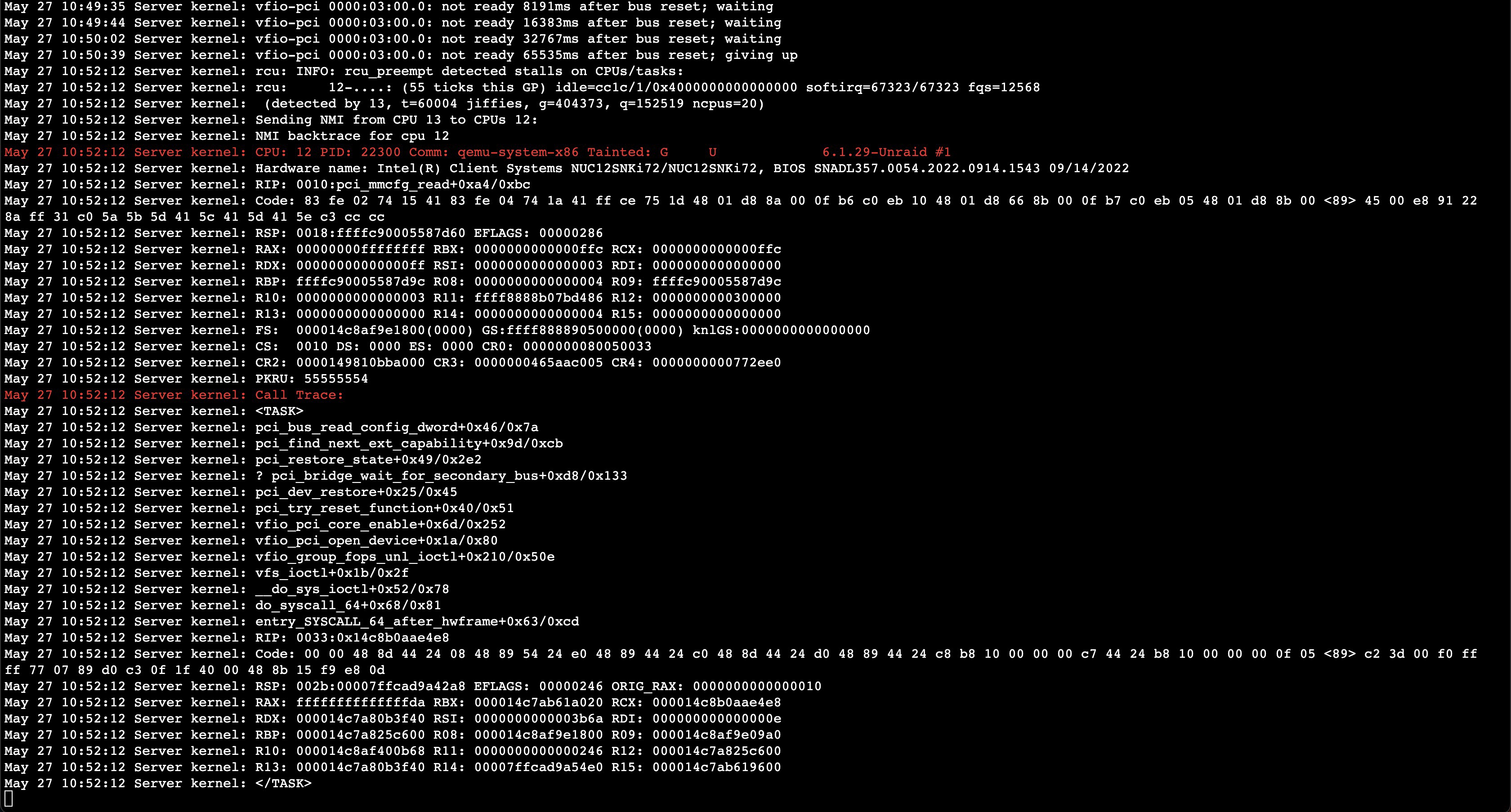

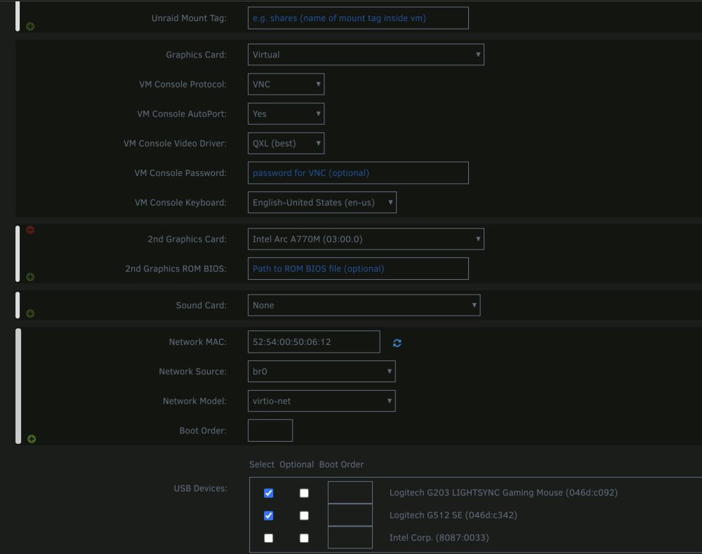

  1. Turns out I had edited /boot/config/modprobe.d/i915.conf with 56a0.. (wrong gpu ID). It was erasing the /etc/modprobe.d/i915.conf on reboot :). So I edited again both files, rebooted, checked the value, did the bios update (357.0057) and changed the two bios settings... Tried removing the options : video=vesafb:off and pcie_no_flr=8086:5690 Did another VM, made sure to take the Q35 TPM, last version. W11 VM booted once, with screen plugged, and turned off without issues. GOOD. But then, on restart, I faced again (log containing on/off/on): And after a reset... No config change.. Booting doesn't work anymore :D. After deleting uuid, loader and nvram : still doesn't work. Restarting the same VM config from 0 : Same. Turning screen on and off : same. I still haven't found why sometimes it seems to work fine, despite spending hours rebooting the nuc.
  2. You should find all related officia docs on the intel's support page : https://www.intel.com/content/www/us/en/products/sku/196170/intel-nuc-12-enthusiast-kit-nuc12snki72/support.html It has the "A770M" ARC dGPU. Not sure to understand the relation with the UHD770. Regarding the iGPU (Intel Xe), I have no issue, it behaves the same as desktop iGPU counterparts and I can pass it to dockers.
  3. And I just finished reading the INTEL ARC SUPPORT where you contributed a lot just in case I could find a tip. I did that, but still facing the the same issue, same with Ubuntu VM.
  4. Hello dear Unraid enthusiasts, I recently got my hand over an Intel Nuc Enthusiast (1200H + ARC 770M). So I first checked on the forum and saw the difficulties faced on the desktop version, but still wanted to try out and repport. I thought it would be pretty nice if the onboard iGPU and dGPU could be used separately. I own a Lenovo Legion 5 Pro with the same hardware, but with a nVidia GPU instead of the ARC. One of the limitations of this system is the presence of a mux switch, that force me to choose the dGPU or iGPU on boot, and stick with it. In the case of the Intel NUC, there's no switch. I was able to use the iGPU for Jellyfin without much issues, and to boot a W11 VM... But problems started quickly after I shut it off. It turns out that I have issues on VM reboots, and even sometimes on boot. At one point, I booted it twice and forced stopped it twice before a failed 3rd reboot ; it gives me hopes. I tried to troubleshoot it alone for a few days without success. It doesn't mean the situation can be solved considering how the hardware is known to not be optimised for virtualisation... But I thought I could try to take a shoot, or at least repport for the curiosity of the experiment. Any help will be appreciated and I will gladly do any suggested test. Here's the VM Config. I also tried Q35 OVMF / OVMF TPM. The XML : The log when the freeze happens : An example of log I obtained by activating logging directly on the flash : I tried these arguments one by one : video=efifb:off, video=vesafb:off and pcie_no_flr=8086:5690 server-diagnostics-20230527-1453.zip
