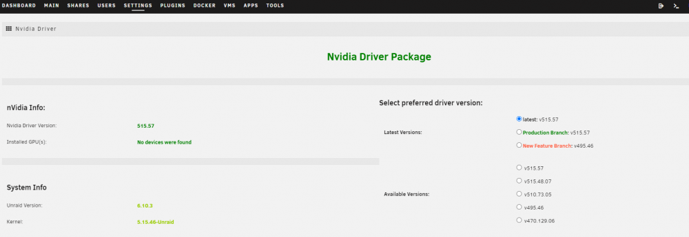

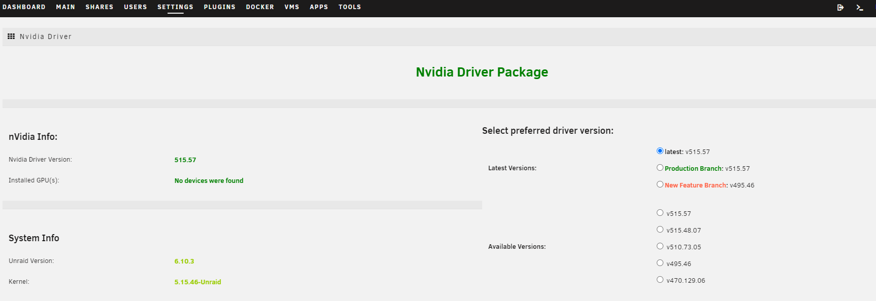

  1. Hi again, I was able to get the card to work in a VM oddly enough but not in Unraid. However, I installed another card I had laying around (1060 3gb) and it worked flawlessly with the plugin. Very strange indeed and perhaps there is something wrong with the card.
  2. Haha, I managed to get the card for a good price on eBay (200€). I understand that, but should the card work in a VM it should mean that there are no errors with the risers/pci-e slots/bios. I will take a look and also see if i can PM someone who got it to work, maybe I am overlooking something in BIOS.
  3. I just plugged the card into my desktop and can confirm that it’s working. 4G decoding is enabled. I have so far tried in two PCI-e slots, one x16 and one x8. I’ll try in the other 4 though I believe they are x8 only. I will also try to pass the cards to a VM, if that works then I’m not sure what is next.
  4. Sorry. See attached. anton-diagnostics-20220724-1912.zip
  5. Hi, Thank you for a great plugin, however it does not work for me. I have a R730 and installed a Quadro P2000. The card does not seem to be recognized by the plugin but I can see it in system devices. anton-syslog-20220724-1553.zip
