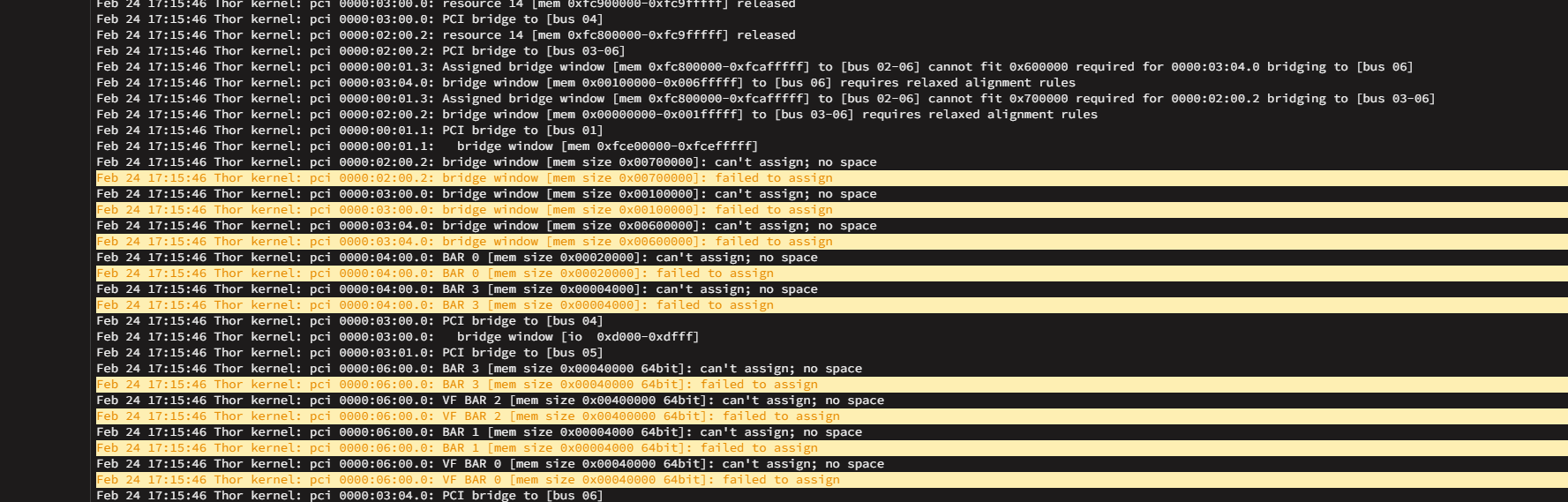

(SOLVED) Docker daemon failed to start suddenly after appdata backup run
Yes i did. and it said 2133 in unraid and everywhere els so assume it was running at 2133. So i would assume does 2 sticks i had is faulty :(. luckily i had 1 extra 16GB stick "running at 2133" i have put in and also did a memtest and got a PASS on it. first failed memory i have ever had. So what's the safe best now to do ? format the cache drive and restore a appdata backup ? Or recommend do more tests ? only error i see now is root: error log : /var/log/graphql-api.log and mem kernel: pci 0000:02:00.2: bridge window [mem size 0x00700000]: failed to assign errors. but that maybe because i when from 32GB to 16GB ? also added another diagnosis file thor-diagnostics-20260224-1724.zip

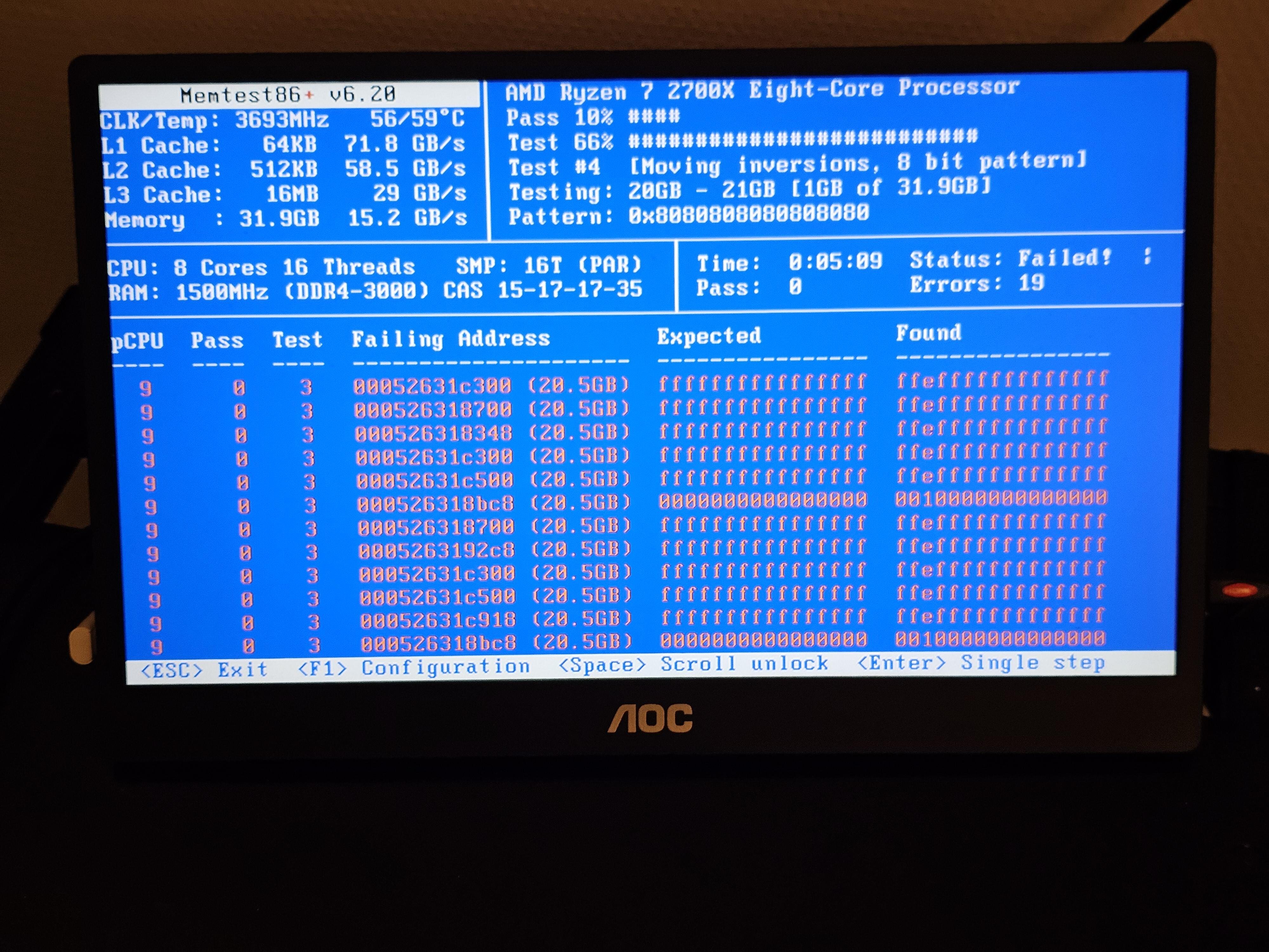

it have been working fine for many years now. and i always tout as the mb supported the memory expo it was all fine... the test is up in 81 errors now.
i did it after infact right before you replied the first time. but running memtest now and not looking good :( . but i still see it says (ddr4-3000) does that mean that the change i did didnt stick ?
So its still the same issue ? i did just now turn off the expo on my memory in the bios. and set it to auto in the asus bios ( AI tweaker settings ) So memory is now running at ( Configured Memory Speed: 2133 MT/s ) But i will also run a mem test and see. and come back when its done.

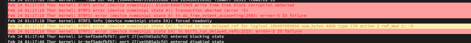

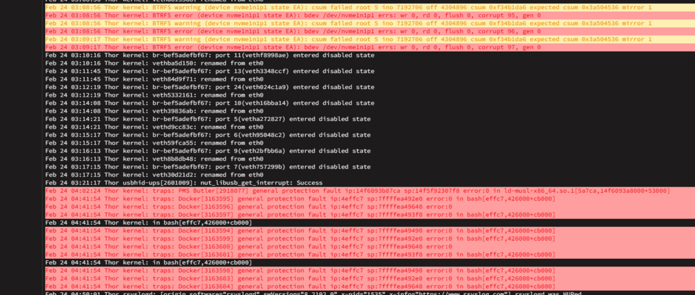

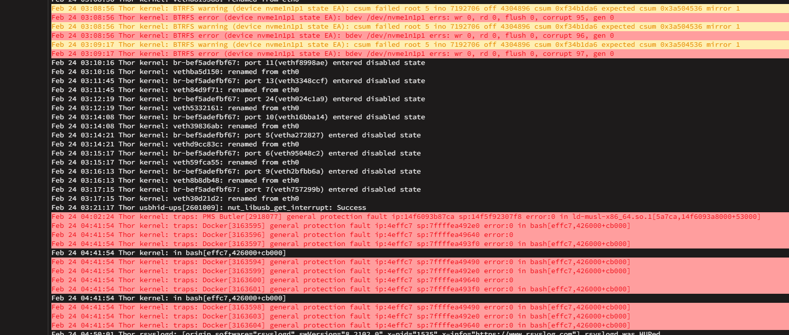

Hi again. So suddenly during the night after my app data backup had run they didn't want to start again it seems. So when i also tried to manually start it i noticed rc.docker: Docker daemon... Failed. in the logs + some corrupted files on the cache drive it seems. also fix common problems saying my cache drive is write only Everything have been working fine since my last post on Friday. Only thing i have done since then is update my bios to latest version and got recommended to change docker from docker.img to docker directory. So i did that. Did some searching but got me just more confused. That it could be a normal btrfs corruption issue and that changing to xfs would minimize that. . or the docker.img change to docker directory. Also added the Diagnostics file. thor-diagnostics-20260224-0955.zip
