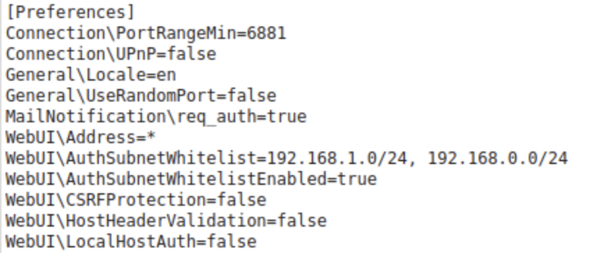

  10. I found my own issue. Without my knowledge I was connected over wireguard so my IP was not in fact whitelisted.
  11. Sorry, that was a typo. I meant that my local IP is 192.168.1.57. My previous fix was rolling back, making a personal password and white listing my IP ranges before updating again.
  12. Suddenly having issues reaching the WebUI (again). I fixed it recently due to the update requiring password etc, but now out of the blue I can't reach it. It's running fine and talking to *arr apps. Trying to reach locally from 192.167.1.57, and thought this was the correct setting for it.
