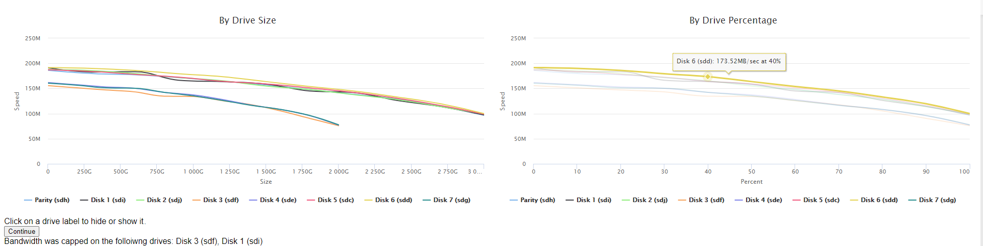

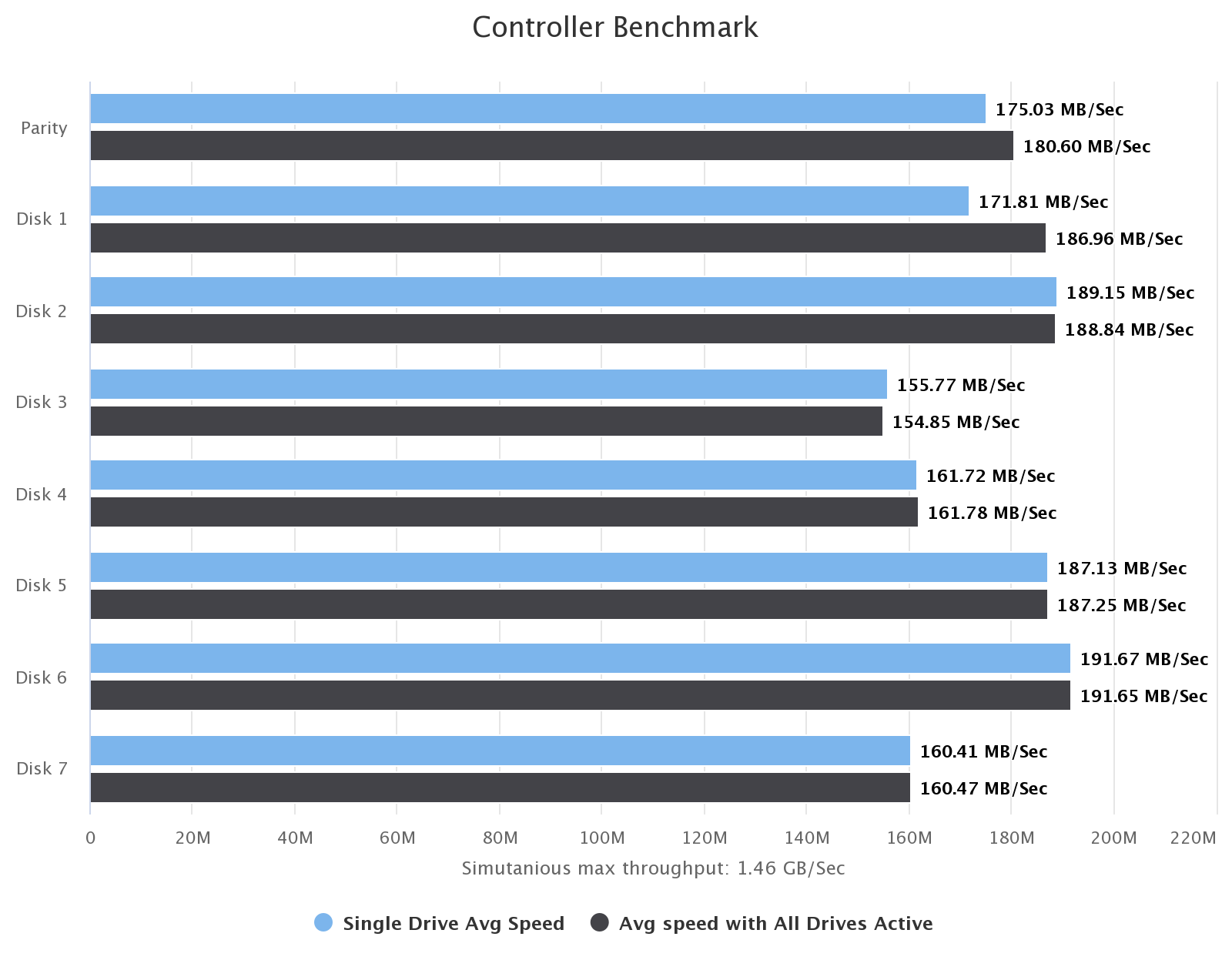

  13. I noticed this time around that different drives showed up as being capped. Unless im looking at this wrong. I have some really slow drives.
  14. I have tried searching but all i get is the beginning of this thread and going through 22 pages is a task lol. I am getting "bandwidth capped on disk" for all of my disks. What should i start looking at? Thanks I am running on a dell R720 with SAS2008 PCI-Express Fusion-MPT SAS-2 [Falcon] Dell (Broadcom / LSI) Serial Attached SCSI controller Type: Onboard Controller Current & Maximum Link Speed: 5GT/s width x8 (4 GB/s max throughput) Capabilities: storage pm pciexpress vpd msi msix bus_master cap_list rom
