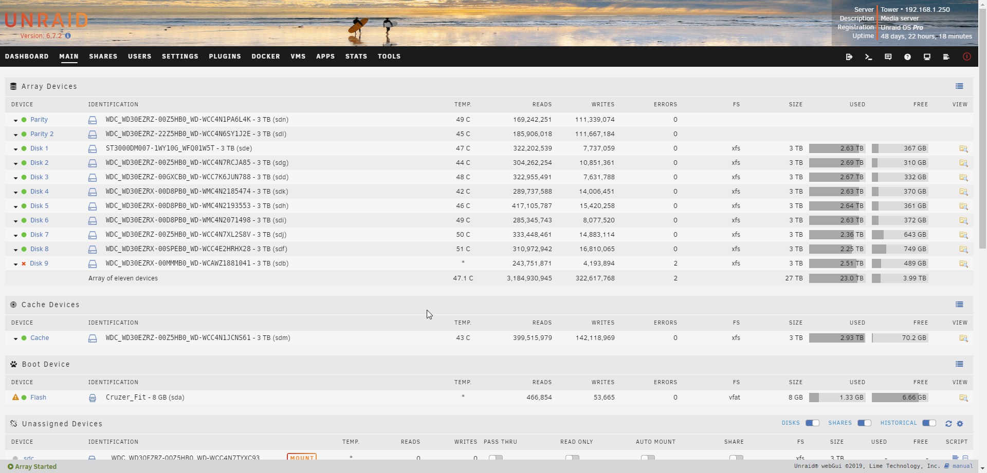

Device is disabled, contents emulated.

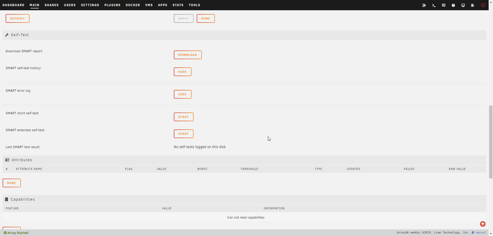

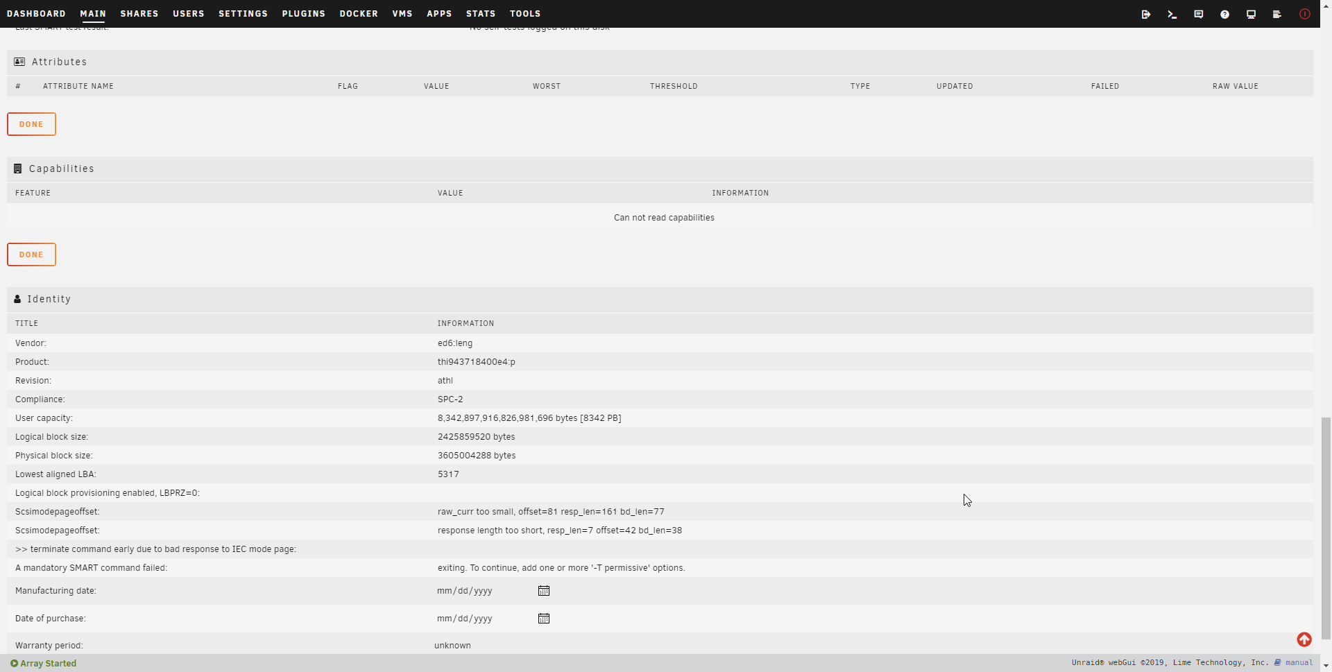

Disk dropped offline so there's no SMART report, check/replace cables and post new diags.

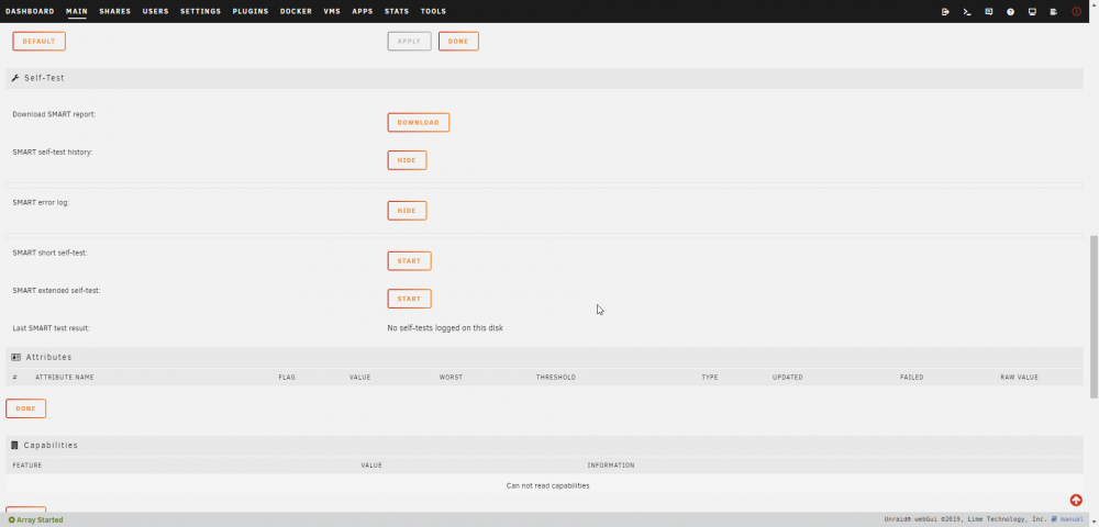

SMART is showing some issues, you should run an extended test.
It passed so it's fine for now, recommend replacing/swapping cables just to rule them out and if the emulated disk contenrs look correct rebuild on top.

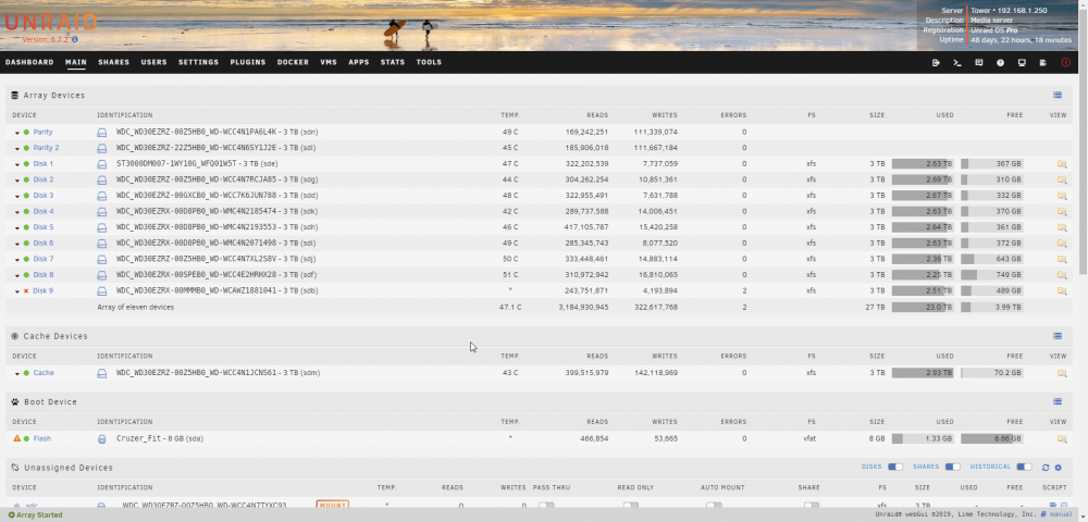

How to reuse the drive?
When I assigned the drive it says device emulated. Is there a steps I should follow? Im not sure what are the keyword to search in the wiki.
Please advise. thanks.

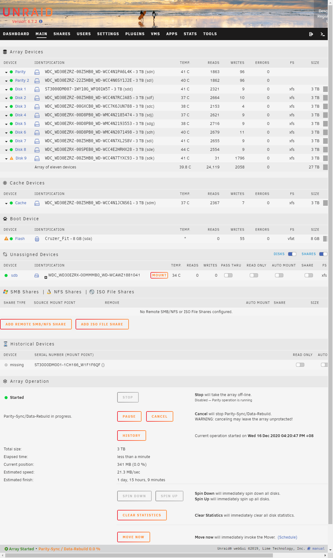

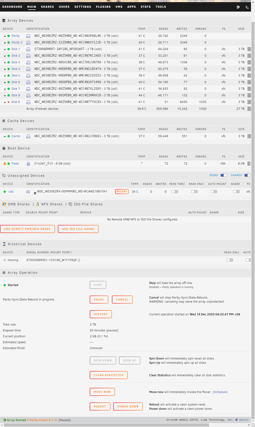

Thanks. Rebuilding now.

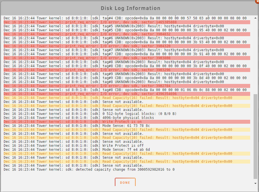

After a while, I get red x again. Elapse time is 21 minutes (paused). What should I do?

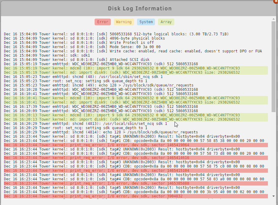

This is the disk log information.
image.png.cff0d86b7b77f4eae81cfb78d412f59c.pngtower-diagnostics-20201216-0845.zip

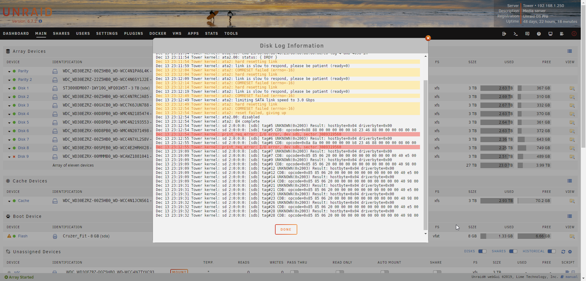

I have attached latest diagnostics.
What should I do? Buy a new replacement drive?
Did you
If yes, replace the drive.
