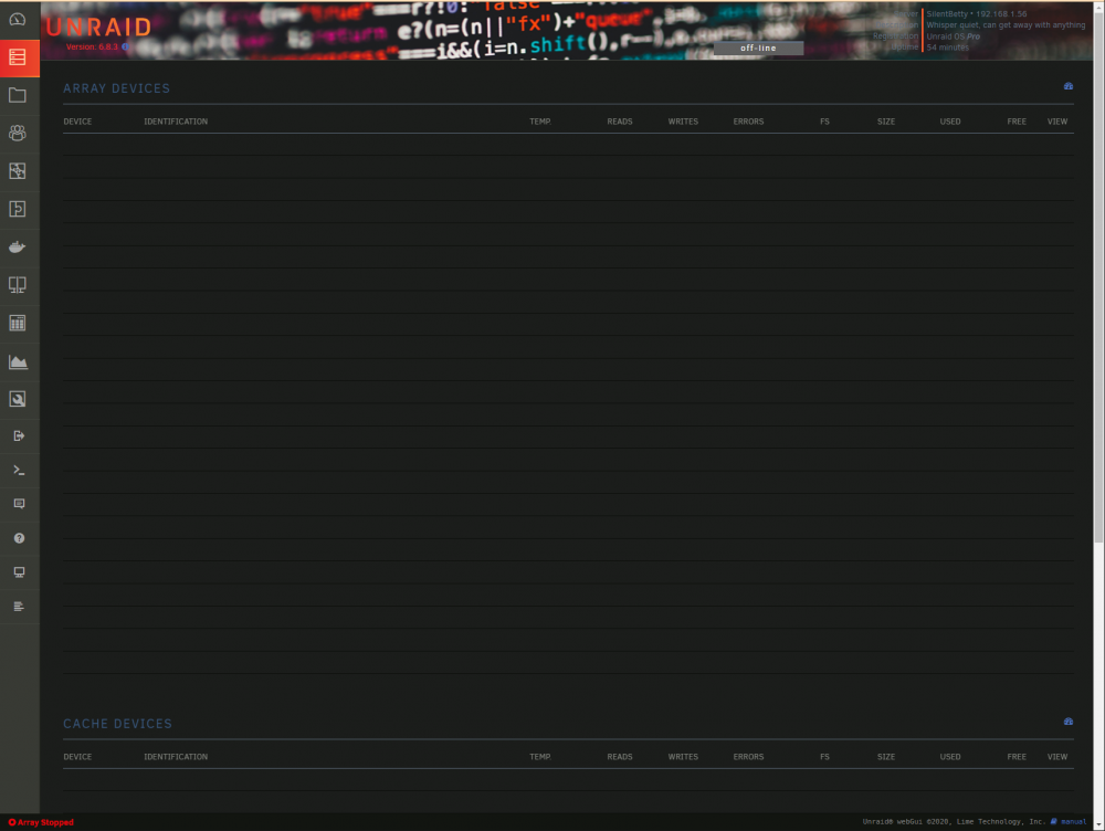

Ok. I'm starting to freak out a little. None of my disks are showing in the main tab of Unraid. None of my shares show up in shares. Unraid is acting funky.
This all started when I was trying to access a file over the network via an application. The first time I brushed it off. Then it happened to the same file on another computer. I went to my Unraid dashboard to check the status of the server. Everything seemed to be ok, all disks health had a big green thumb. I could browse the network storage via my computer, but at minimum the one file was corrupt or inaccessible. I started poking around on the Unraid dashboard, and the next thing I found was the plugins page would never load, just the loading symbol forever and ever and ever.
This is starting to get more weird. Something similar happened in the past with the docker page, and it had to do with my system time, so I check my system time. Time is good. I figure a restart will put it in order. Bad idea, especially without grabbing a diagnostics file first...
When the machine reboots, which takes forever (not typical), no disks show on the main page of Unraid dashboard. This seems like a strange no disks, usually there are some drop down menus or something, my main page is blank, I attached a screen shot to this post. I tried starting the array, and it "starts" but there are no disks still. I tried collecting diagnostics information and Unraid just sits there forever.
During boot, all of the hard drives are shown by the LSI card. So the system knows they are there and operational.
I am not sure where to go from here. Please advise on the next steps I should take.

If you cannot get diagnostics, you should try to boot on SAFE MODE.
I booted into safe mode and attempted to collect diagnostics, still just sits there forever. Is there something else I should try in safe mode?
It took sometime, but my diagnostics file did generate. I have attached it.
Edited by JimJamUrUnraid
removed diagnostics file
I think I’ll try a fresh usb disk and unraid install just to see if the drives show up. Will report back.
The new USB stick and unraid install pulled up all of the drives without issue. I happened to have taken a screen shot of all of my drive assignments, so that made that step a little easier than digging through the diagnostics file. I just have to setup all of my plugins, dockers, and settings. great. It would still be nice to know what happened to the old usb stick...

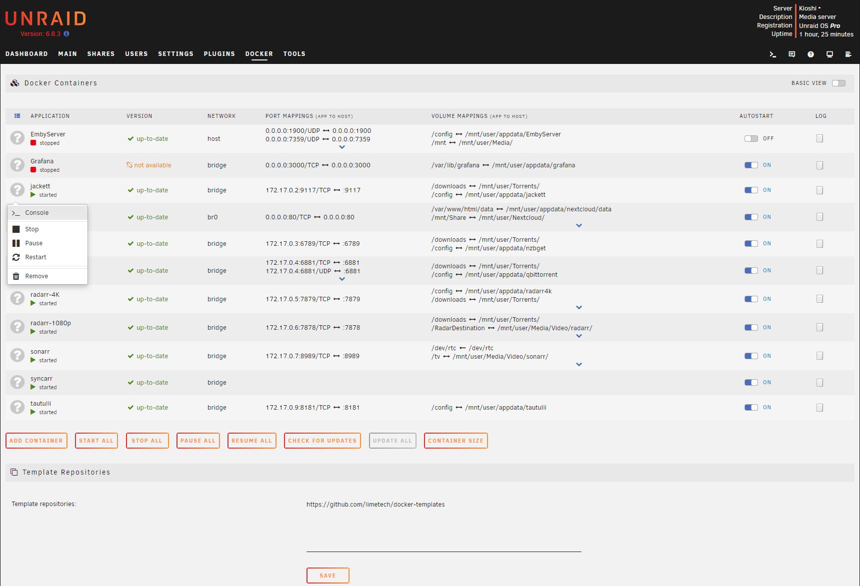

Next issue. Unraid picked up all my old dockers and started them, but the icons are all missing and the links to the web gui pages dont exist. Any idea how to get these back? I post a screen shot below...
The templates are stored on flash. If you don't have a backup you will have to delete them all and set them up again.
Thanks, I found the templates in the dockerMan folder. That helped setting up the docker images from scratch. The server is mostly re-setup without actually copying anything from the old USB stick. A bit tedious, but this made sure I didn't copy a corrupt file or copy the issue over to the new installation.
