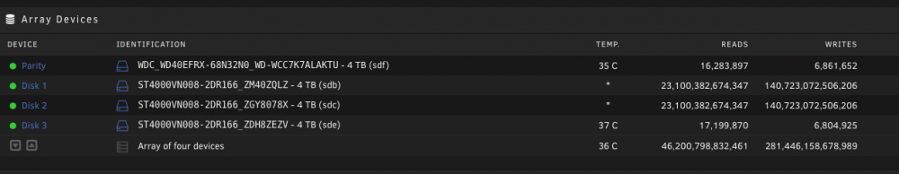

For the time of my "normal" usage I doesn't get any errors. But on every parity check (timed for every month) I get read errors on Disk1 and Disk2.
Additionally the drives seems to bring themselves into an undefined state which results in millions of reads and writes - due to the GUI (see Screenshot) - constantly counting up.
Not sure if this is "real" or just a bug. But after a reboot everything is fine -- for the following days until the next parity check :(

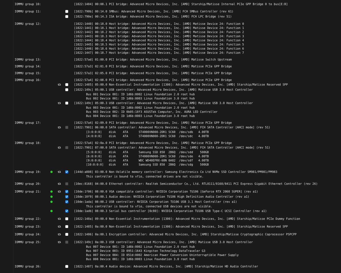

It is real not bug. Disk 1 and 2 connect to one of FCH SATA controller ( you have two ). Could you try disable IOMMU or some tweak relate AMD SATA controller about IOMMU.
Or disconnect SSD then connect both disk to those port, so all disk in same FCH SATA controller, then try parity check again.

Because you're passing-though their controller to a Windows VM:
-device vfio-pci,host=0000:06:00.0,id=hostdev0,bus=pci.9,addr=0x0 \

15 minutes ago, Maddeen said:
<hostdev mode='subsystem' type='pci' managed='yes'> <driver name='vfio'/> <source> <address domain='0x0000' bus='0x06' slot='0x00' function='0x0'/> </source> <address type='pci' domain='0x0000' bus='0x09' slot='0x00' function='0x0'/> </hostdev>
Ok... seems that this lines causes the error right?
Not sure why them are in my config...but I had changed my mainboard and cpu .. and not checked the vm configuration.
Can I just delete the lines within this <hostdev/></hostdev>?
This is a SATA controller.
This one:
ok - i deleted it and start my vm. No problem for now.
Seems that this was a legacy from my previous build because I didn't check if any IOMMU entries has changed.
