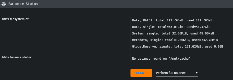

After running the balance on the ssd cache, I still am unable to perform the actions and still get the error message. Looking at the balance status after running said balance, it says "No Balance found on /mnt/cache" as shown in the picture I have attached. I also attempted to invoke the mover before balancing.

Unless you intentionally made the cache pool something other than the default raid1, you get a mirror with total capacity equal to the smaller of the disks.

You should free up some space, then convert to single, or the balance might fail.

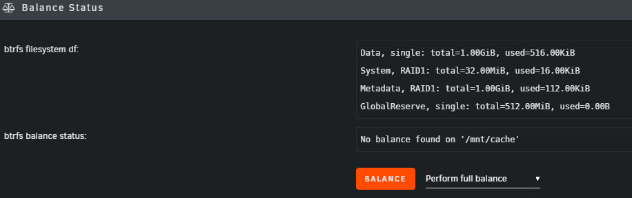

The mover emptied the cache, and I converted to single mode, then ran the balancer.
Unraid now shows the SSD's in single mode which is I believe what we wanted, however it is still showing "No balance found on 'mnt/cache/'". Could this be a problem?
I think this line refers to the status of the Balance operation. If Balance is finished, then it should be normal not to have Balance ongoing.
