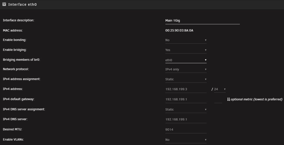

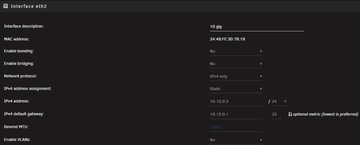

My Unraid server (SMCS-NAS) has 1 1gig Interface (eth0) 192.168.199.3 and 1 10gig Interface (eth2) 10.10.0.3. I am running Dockers for Webserver, Nextcloud, NginxProxyManager, etc.. and they all work great but having 1 issue and hope someone can tell me how to resolve this.
I am running a firewall and ports 80 and 443 are forwarded on the eth0 interface correctly to NginxProxyManager. tested and all works as it should but about every 10 minutes or so the server identifies its self to the Firewall as SMCS-NAS on the 10gig eth2 interface but gives the ip of 192.168.199.3 but in reality the ip is 10.10.0.3 so all of the port forwarding fails until it re-identifies its self on the 192.168.199.3 eth0 interface, then it all works again.
My question is this I think, how can I tell the Unraid server not to identify its self on the 10gig adapter? i have tried everything that I can think of. I have changed Network settings for that adapter but makes no difference. Here are some screenshots of my Network Settings. If anyone can be of assistance I would be very grateful. I have been troubleshooting this for 3 weeks now, but nothing I do seems to make any difference.
Does 10.10.0.1 gateway exist ? May be try empty that gateway setting.

The 10.10.0.1 gateway does not exists, I put that in there to try and trick it to not talk to the 192.168.199.x gateway. I have removed it and still no difference. I am not sure how this vlan works. My firewall does have vlan ability but I am not sure how to set that up. Would you be willing to help me? The Unraid server is sitting right next to the Firewall, but the Firewall does not have 10 gig capability. Can vlan still work?

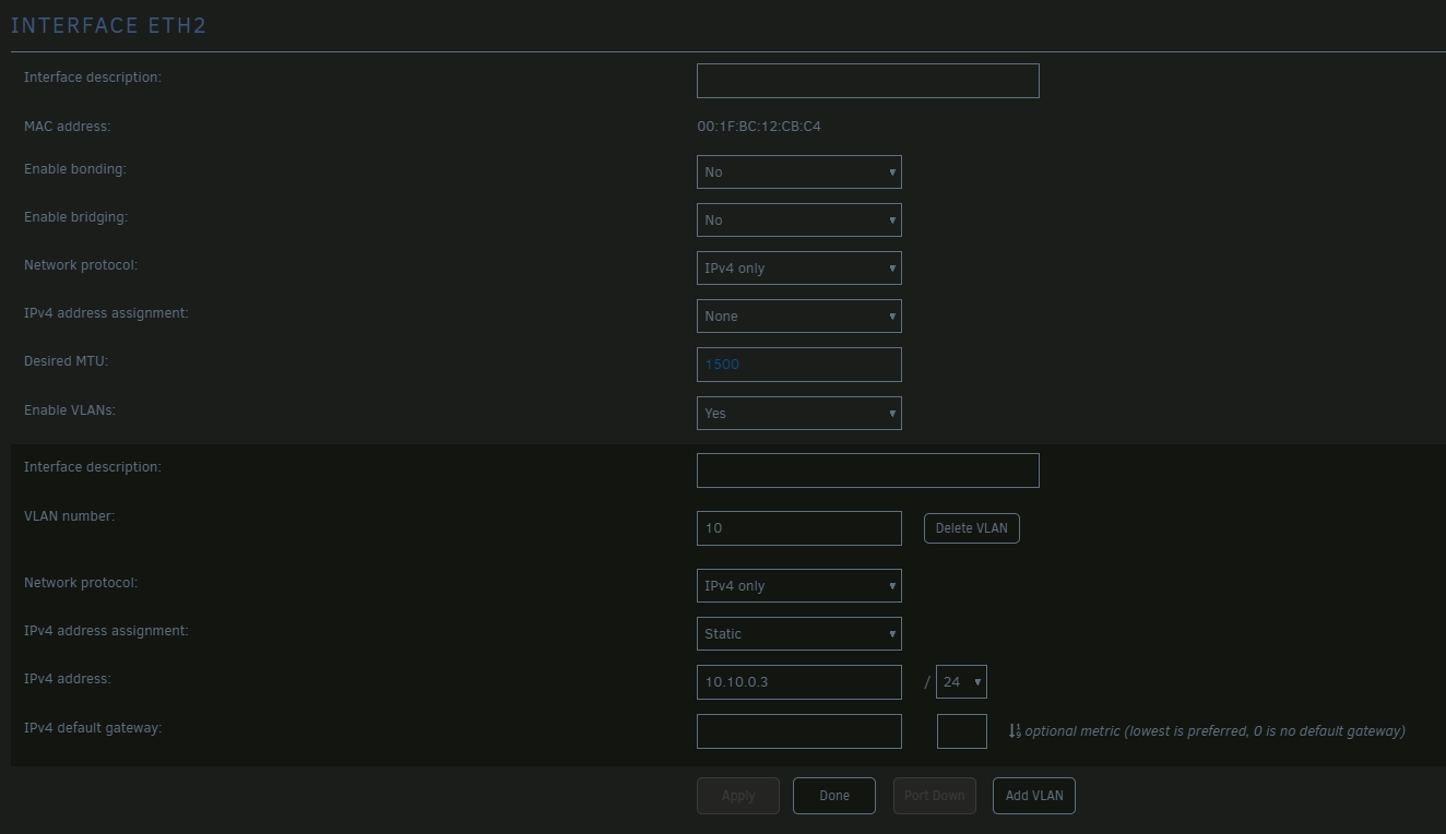

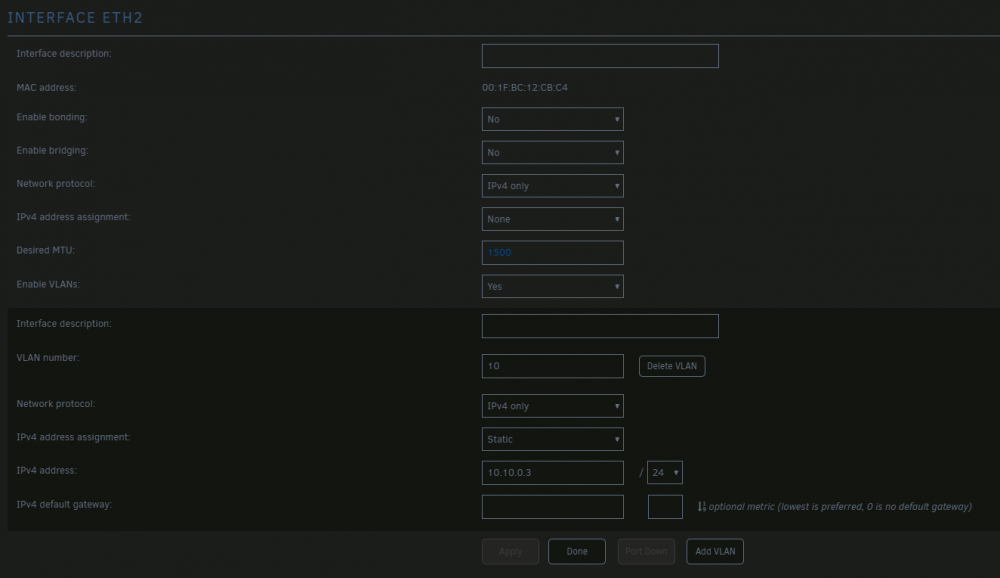

Could you try setting VLAN on 10G interface, so it is a test to check does same problem occur first.

I can set a vlan if you can tell me how to do that? I see it in the network settings to enable it, is that all I have to do is enable it on Unraid ?
Previous post have a example screen capture.

I have the vlan turned on both servers but do I have to make adjustments to the Firewall to know how to use the vlans? I created the vlan but it didnt seem to do anything that I can tell.
