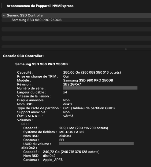

Fresh BigSur install (with Macinabox) on a 256Gb Samsung 980 PRO with the controller passed through.
The drive is on now on a PCIe Gen 4 socket but it may important to note that it was (my mistake) on a GEN3 socket during the install.
So before I moved it to the right socket, "System Report" reported : Link width : 4x / Link Speed 8GT/s (so GEN 3).
Now, it's on the right socket, the lspci command gives : LnkSta:  Speed 16GT/s (ok), Width x4 (ok)
BUT, and this is the problem I can't find a solution / explanation for : under System Report, Link Width is still 4x but there is no info for Link Speed... ???
A Blackmagicdesign Disk Speed test shows a read speed of 2.8GB/s (so the same as on GEN3) where the drive is theoretically capable of 7GB/s. And I know I wont get that speed, but now I'm having less than half.

I use the Nvmefix kext but no other (regarding Nvme).
The controller used for the 980 Pro is new (and called Elpis) and i just assumed that i have to wait for a driver / kext update. I was not able to find any one else having this problem with this specific drive.
