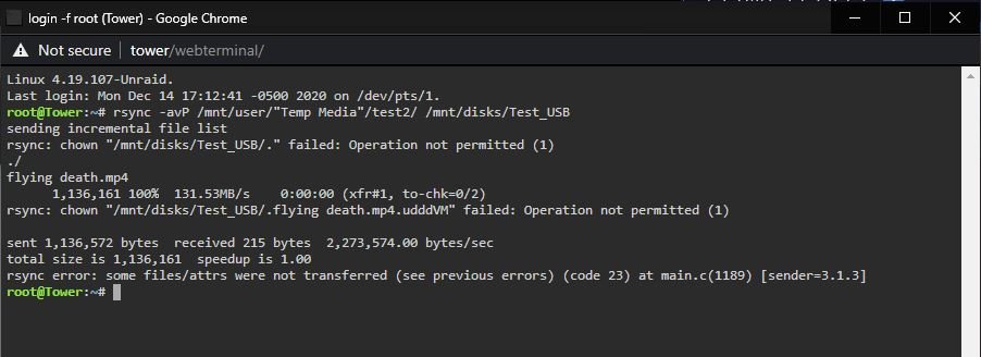

I'm practicing some rsync commands before I set up an external USB HDD for incremental backups.
I added a USB Flash drive to my USB port on my server mobo and mounted it with Unassigned Devices. The drive is working properly. I can transfer files to the drive using Krusader, rsync and remotely via windows SMB. When I transferred some files from a share on the array to the USB drive using rsync I got some errors that I believe are related to ownership.
Although the files transferred I got these errors:
What rsync command would you recommend that would make an easy restore source if needed? Not messing up ownership, etc. You can leave out the --delete for now as I'm more confused about the "options".

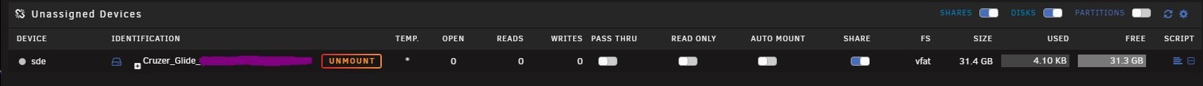

Also, the ball is still grey, not turning green although the drive is working. Does this matter? Thoughts, @dlandon ?

You need to update UD.  The vfat file system does not respect the Linux attributes, hence the error.

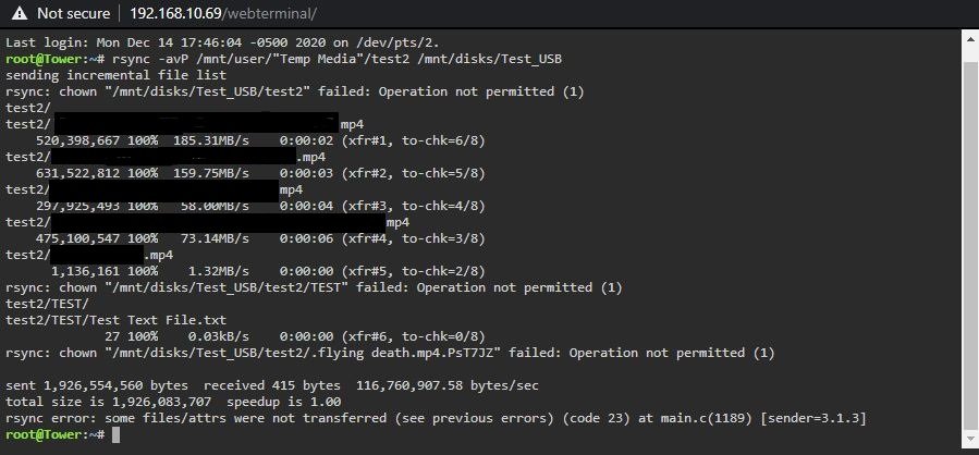

Thanks. I updated UD and it did turn the ball green. However, I'm still getting rsync errors. I'm not sure if these errors are even important. Or if they are only showing up because I'm using a USB Flash Type drive. I want to make sure i dont screw up my backups :)
Thoughts?
Adding --no-perms to the rsync command should get ride of those, like mentioned FAT doesn't support permissions.

I tried this and still got the errors. I think this exercise is fruitless using a Flash USB drive as a destination. Since I'm just testing. When I get the external USB HDD drive in the mail it will formatted to xfs. Unless you guys recommend a different file system for a local rsync backup drive.
I rsync to NTFS all the time.

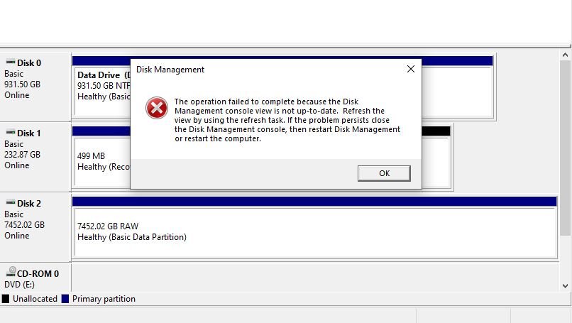

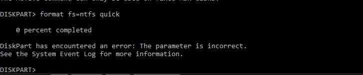

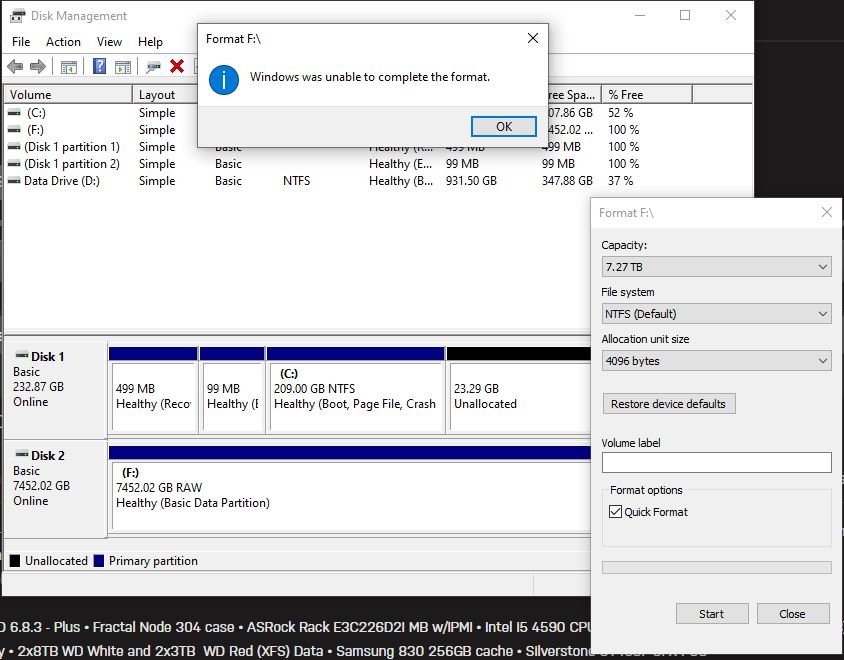

Thanks for this. Exactly what I was looking for. Although I have a new problem. Since I created those files on the drive with Krusader then I tried to format the drive to NTFS it's not able to be formatted. I connected it to my windows PC. Tried formatting regularly then with diskpart. Then with the WD drive utilities. All keeps failing to format.  Any ideas?
Does Windows Disk Management see the drive or any partitions?  If so you can remove partitions and format there.
There are also a couple of Linux utilities for formatting a drive with NTFS; mkntfs is a command line utility and GParted is a GUI that will do it.
Yes it shows up in Disk Management. I have tried removeing the partition and formatting. But I keep getting errors:
Maybe I should try in unRAID?
OK, update: I connected the drive to my Windows laptop and it formatted first try. Something is wrong with my Windows desktop...
