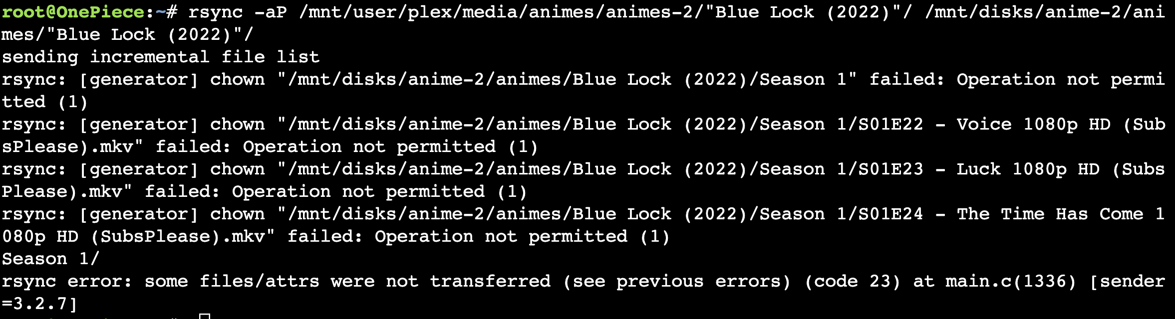

Hello I have the same failed: Operations not permitted and error code 23 despite the while transferring but rsync says otherwise. I have tried updating the UD plugin and reinstall to no luck. My destination device is an exfat format external hard drive disk. Is there any way to solve this issue?
Edited by BlackMamba24
If you care about retaining the Linux file permissions/ownership you can do what dlandon said (I use EXT4 myself on my external drive). Otherwise you could modify the rsync command so you don't get the above errors.
Instead of this:
rsync -aP [source dir] [destination dir]
(-a on its own is the same as -rlptgoD)
you could do this:
rsync -rltDP [source dir] [destination dir]
This removes the flags that otherwise tell rsync to retain the Linux file permissions/ownership.
14 hours ago, dlandon said:
Use another file system.  Exfat does not respect the file system attributes.
Thank you, eventually found that conclusion after some digging around
Instead of this:
you could do this:
Thank you so much! I came this command "rsync -av --no-o --no-g --no-perms --progress --stats", which is the same as yours but just longer? This includes the stats variable and I assume --progress is the same as P if I read that correctly. Your version would be rsync -rltvDP --stats and would do the same thing? Also, does the order matter for where I put the new v variable?
