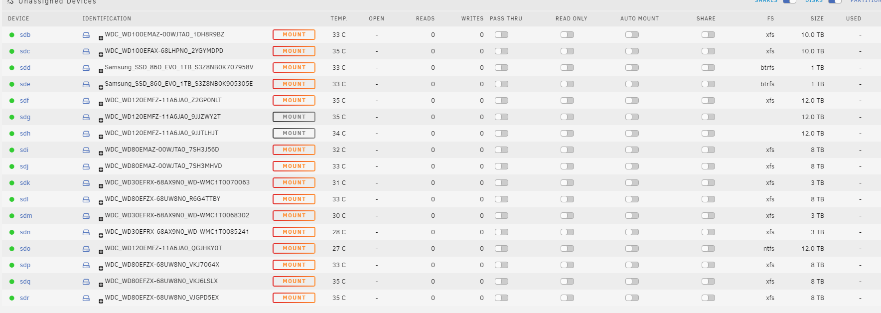

I think I might be alright. I was able to find an old screenshot with the disk locations. I also was able to get the old drive to boot up. Not sure why, but after changing the power cord for the 10th time it finally booted. I am now doing a parity rebuild. Data so far seems to be in tact.
