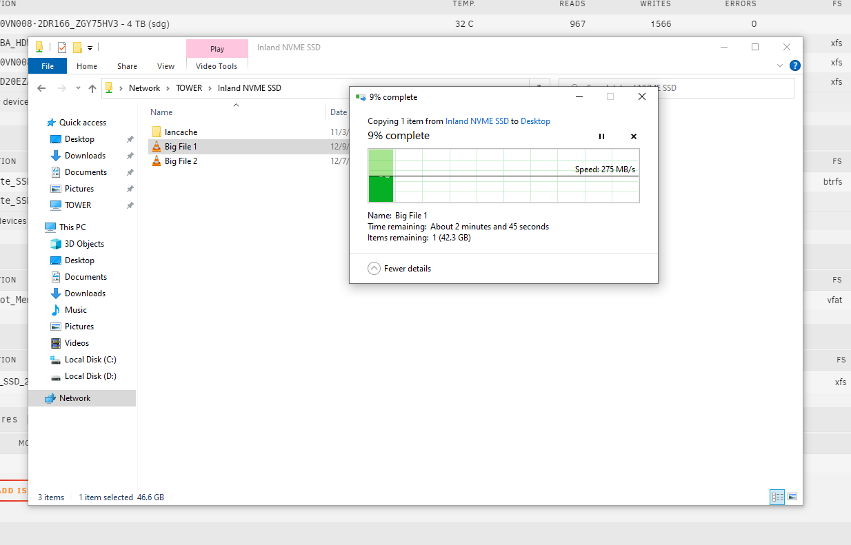

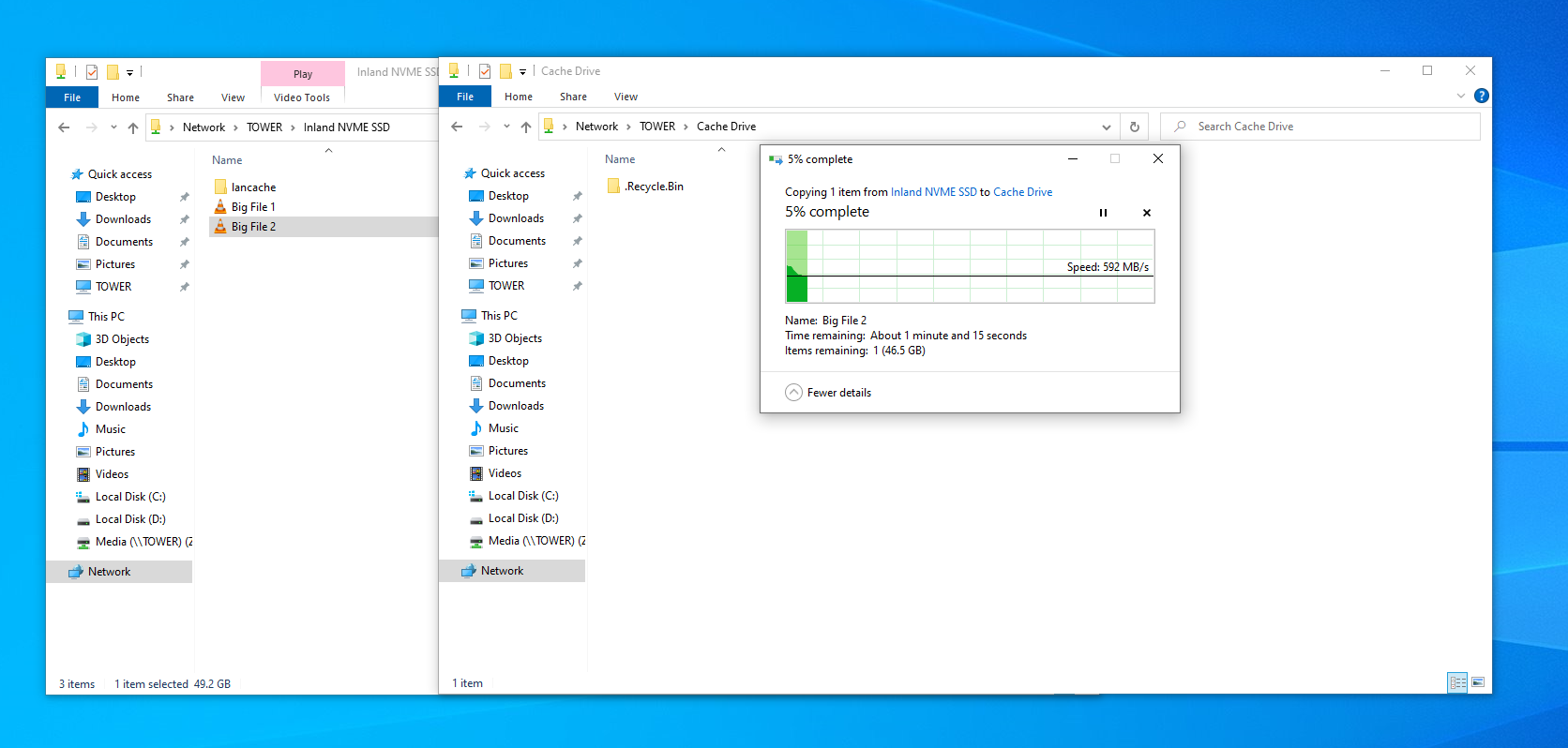

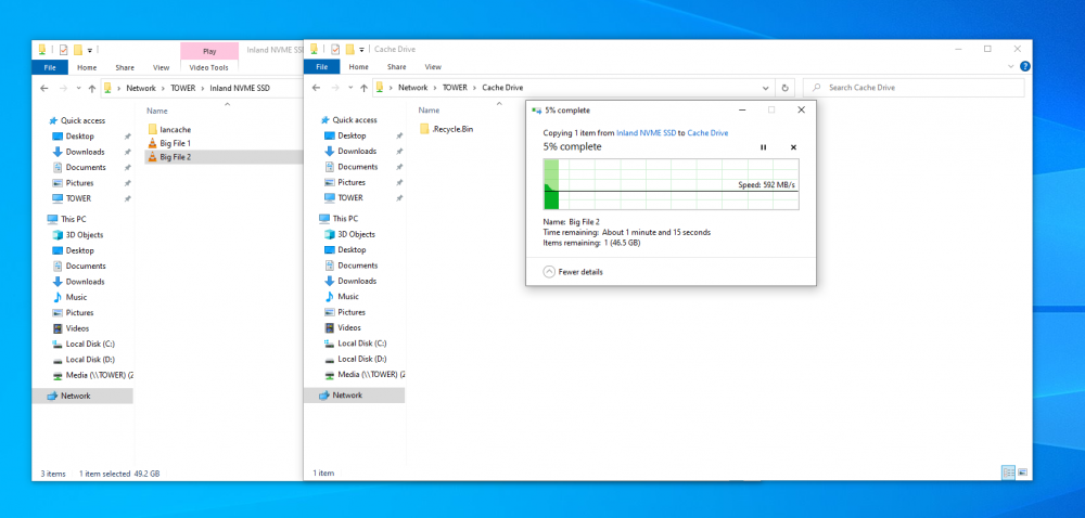

When I run a speed test to the server I can't get the full 2.5GbE but when I run a file transfer it caps out at 129MB/sec even if I am copying from the cache drive. If I transfer to or from an NVME on the server to the cache drive on the server I get the full speed. My Desktop PC drive has two SSD drives and transfers between them exceed 500MB/sec. I attached some pictures. Any help would be appreciated. Thanks

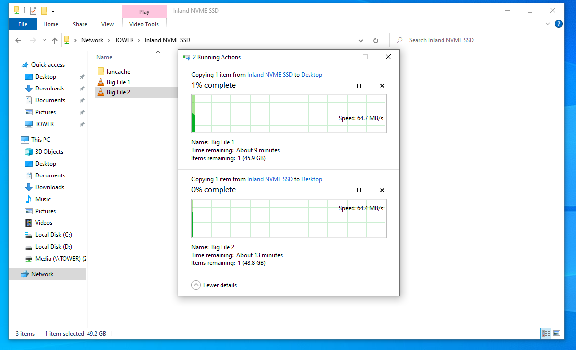

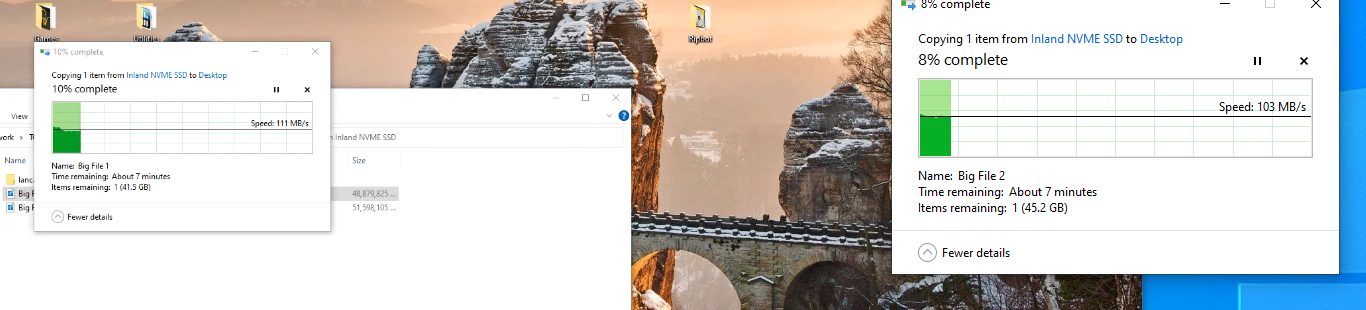

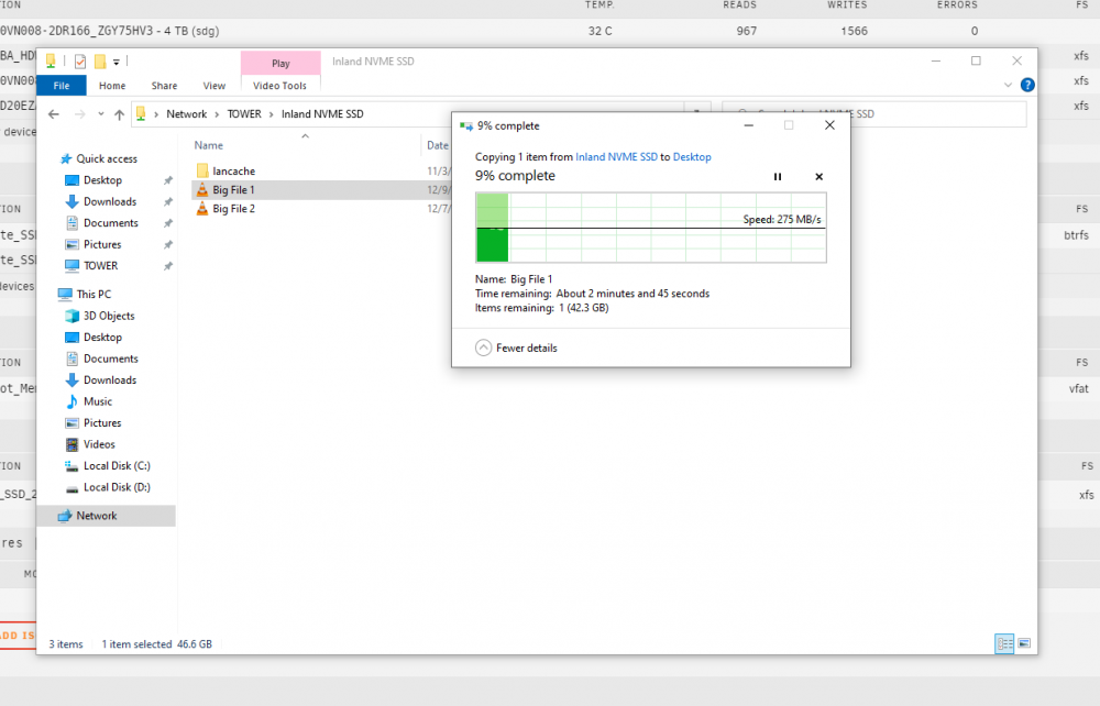

So I tried to see if it was maybe just a limit imposed by one file but transferring two at the same time cuts it in half instead of using the whole 2.5gb
Oddly enough when two computers are accessing the network it saturates the full 2.5gb but either one of them alone does not. All of these have 2.5gb nics on a 2.5gb switch.

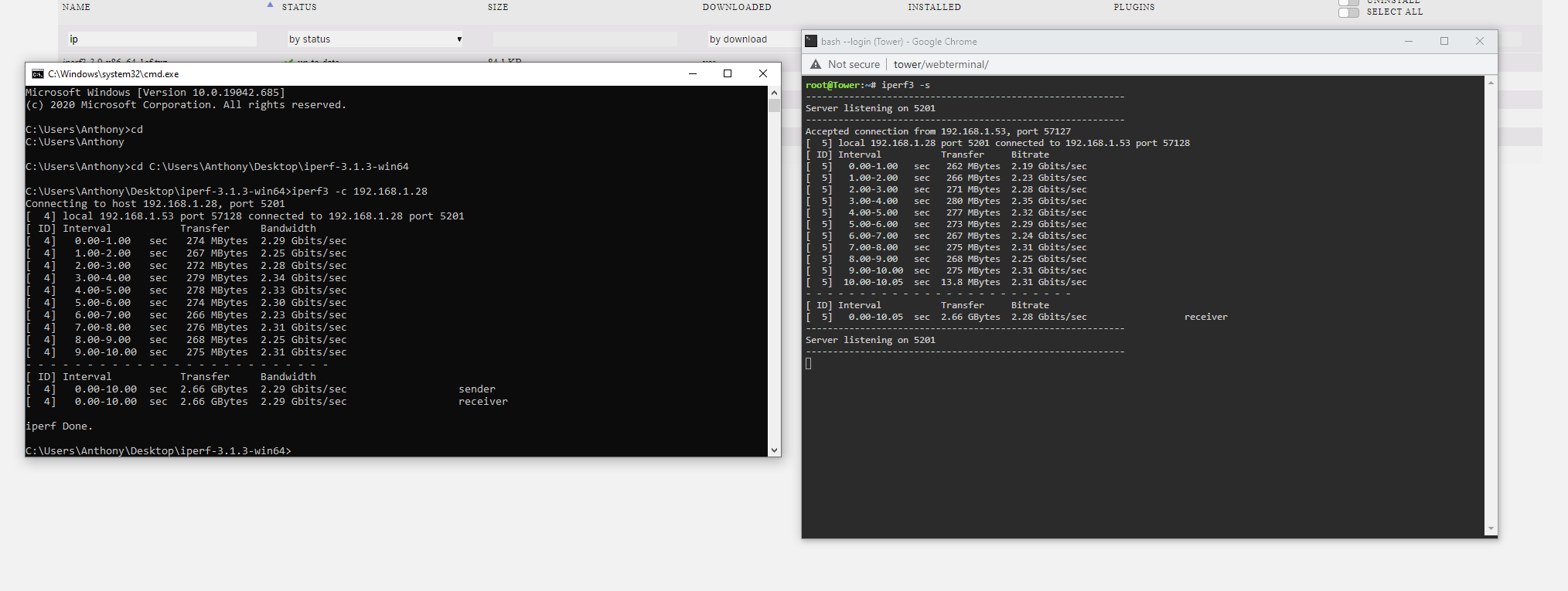

Run an iperf single stream test to check lan bandwidth.

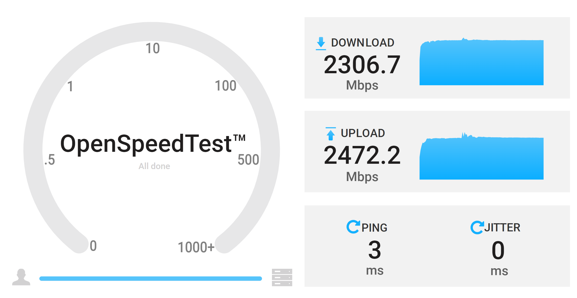

Hey thanks for the help. Here is the iperf test.
iperf looks OK, if you haven't yet try copying from a disk share instead of user share.

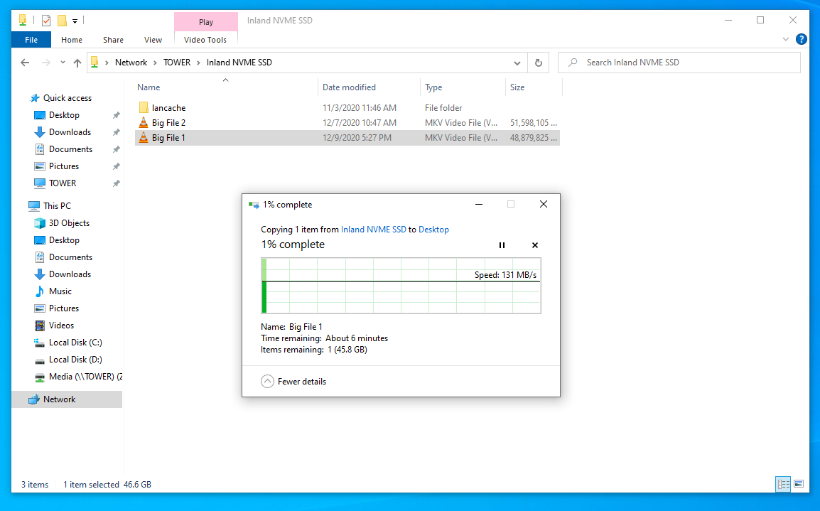

Tried copying from the disk share and got the same results. 129-130 MB/sec

I was checking out that guide and none of that seemed to work. The weird thing is, if I do a transfer from two separate computers I can saturate the full 2.5gb link on the server. However, if I do a transfer from just one desktop I am stuck at 129-130MB/sec.
